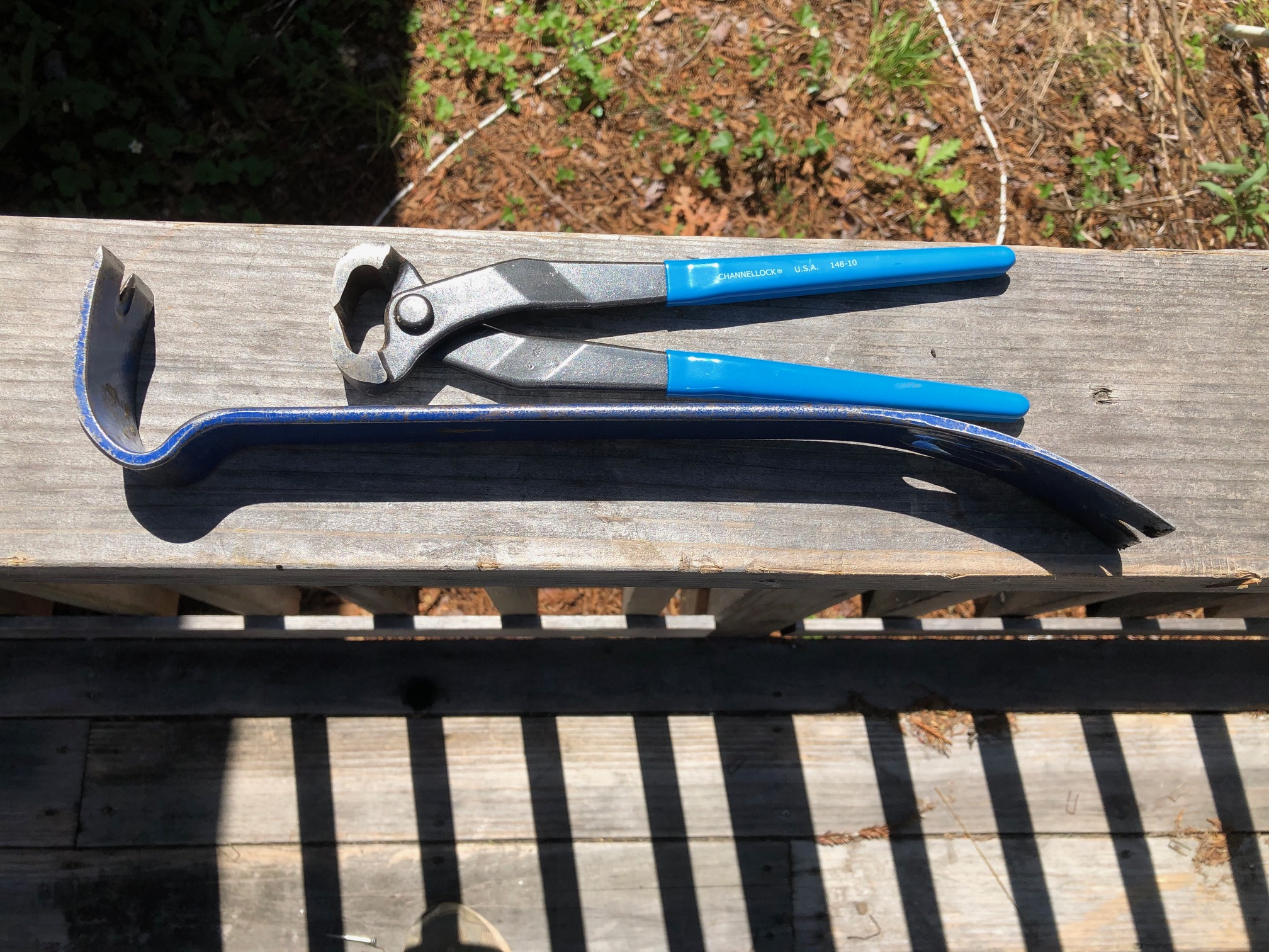

I spent some years as a carpenter and contractor. Never owned or used the dedicated nail puller. For that matter never seen anyone use it. My uncle had one in the bottom of a tool box, but I never saw him use it either. I am sure it works fine.
For most situations I use the two tools below. They provide a lot of leverage. Use with a piece of 1/4" plywood to avoid denting the material you are working with, assuming it is worth treating carefully. For big rusty nails you cannot beat a crowbar. I also have a specialized tool for dismantling decks board by board, it is like a 5 foot pipe welded to a claw hammer.
I think the modified vise grips will work really well for a range of situations.

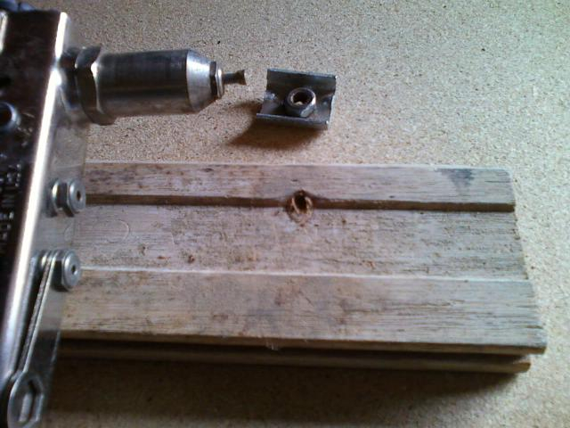

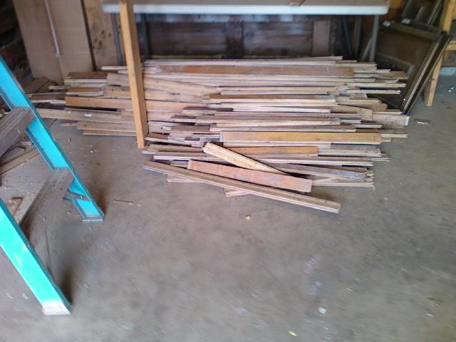

We had oak floors in our house. They were "sanded" to refinish them very poorly, before we bought the house. So I ripped them all up and installed a new bamboo floor.
Now to the point. There were several boards that were still in decent shape that I figured would be good for some projects. But there were several 100 nails still in the boards.

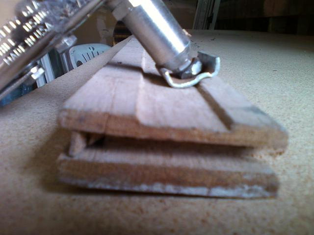

So I came up with this.
A cable tie clamp that you screw into a wall to hold phone lines, a small nut, and a rivet gun.
Worked like a charm! No tear out on either side.
