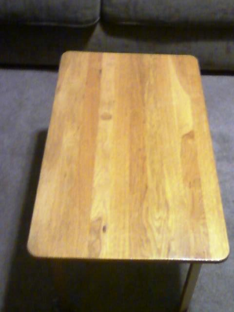

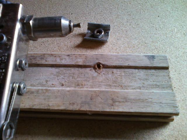

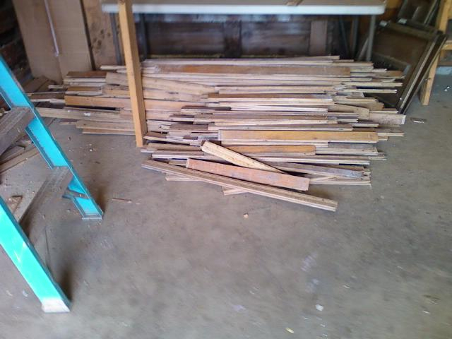

We had oak floors in our house. They were "sanded" to refinish them very poorly, before we bought the house. So I ripped them all up and installed a new bamboo floor.
Now to the point. There were several boards that were still in decent shape that I figured would be good for some projects. But there were several 100 nails still in the boards.

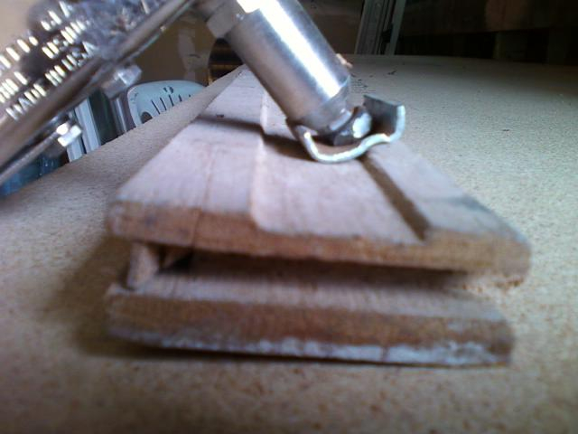

So I came up with this.
A cable tie clamp that you screw into a wall to hold phone lines, a small nut, and a rivet gun.
Worked like a charm! No tear out on either side.
Coffee table made from the flooring.
I also made a dining room butterfly table out of it.
