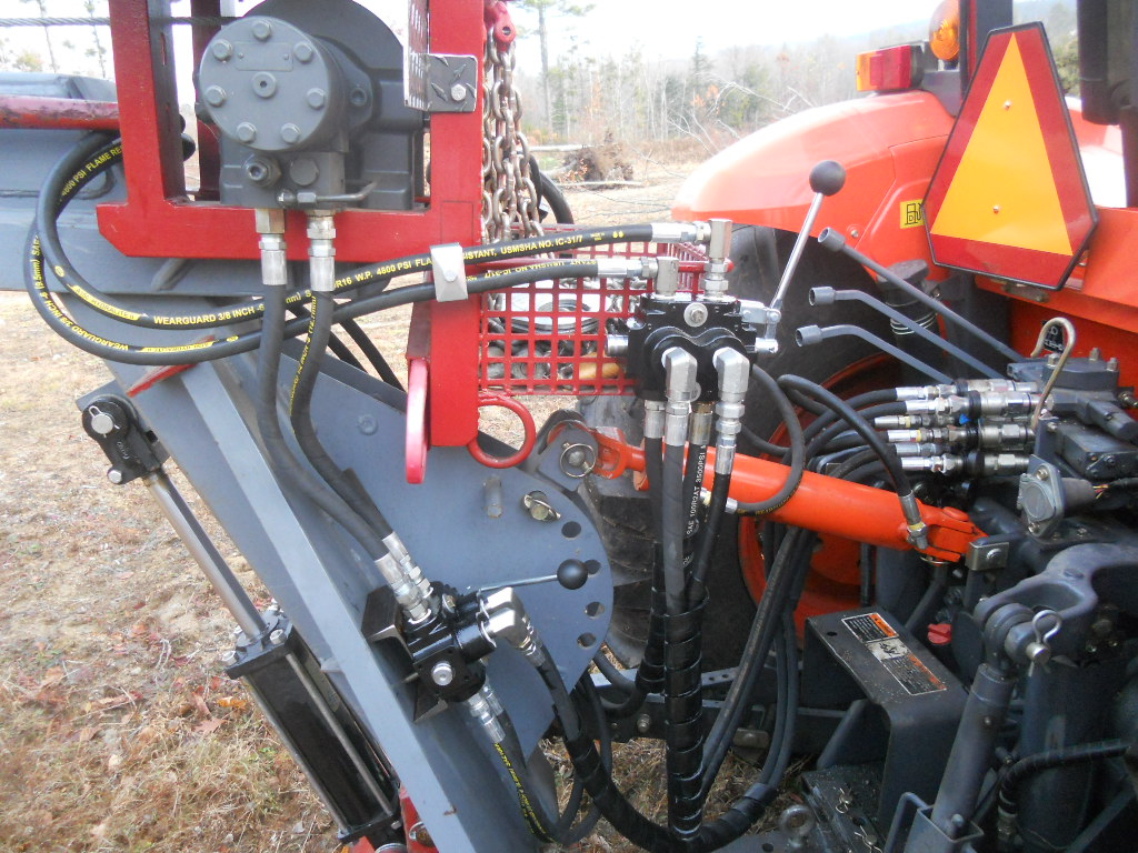

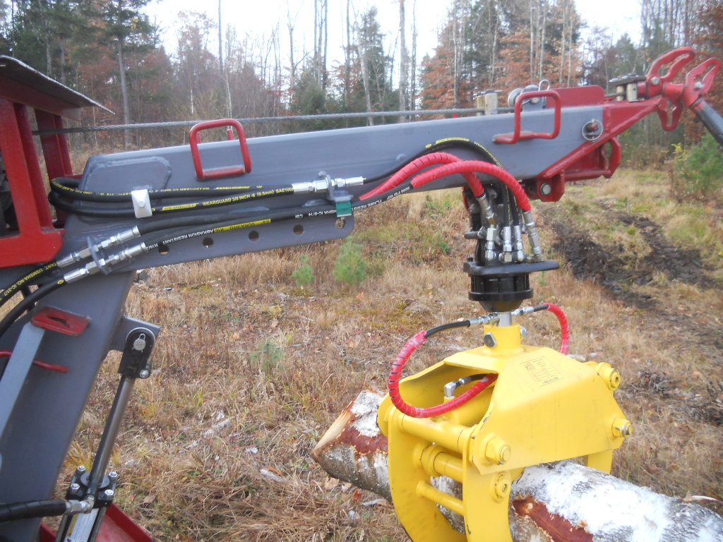

I finally finished, ended up buying the grapple instead of making one. The "plumbing" worked out fine by using 2 diverter valves. I have 3 remotes but need 5 to avoid the diverter valves. I "split" the winch & the grapple, they will never be used at the same time. And the blade circuit got split with the rotator and this valve is within reach while seated. I left the top link by it's self, it works perfect to lower, more like rotate the grapple down on the logs.

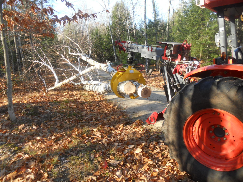

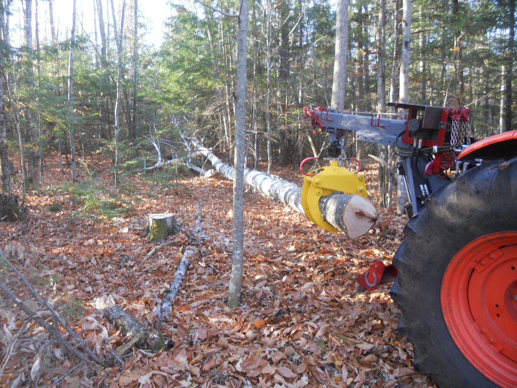

The winch and grapple compliment each other well. Trees that I can't drive to are drug with the winch up to within reach of the grapple and get skidded out well off the ground. Last weekend I moved some smaller logs (12-14" across) with the butt end up under the rear blade and "grabbed" with the grapple, this completely picks the log off the ground and out of the dirt. They were 22' long! This will be a big help bucking firewood also.

There is a local dealer and he sold me the rotator & grapple, sometimes called a bypass graple or log "bucket" locally.
edit; google Hakmet forestry machinery & equipment

The winch is a Ramsey 8000# hydraulic. Around $1300 @ AW Direct, a towtruck type mail order supply place. That rating, like all winches is the "1st layer" (of cable on the drum) and it falls off with each additional layer.
