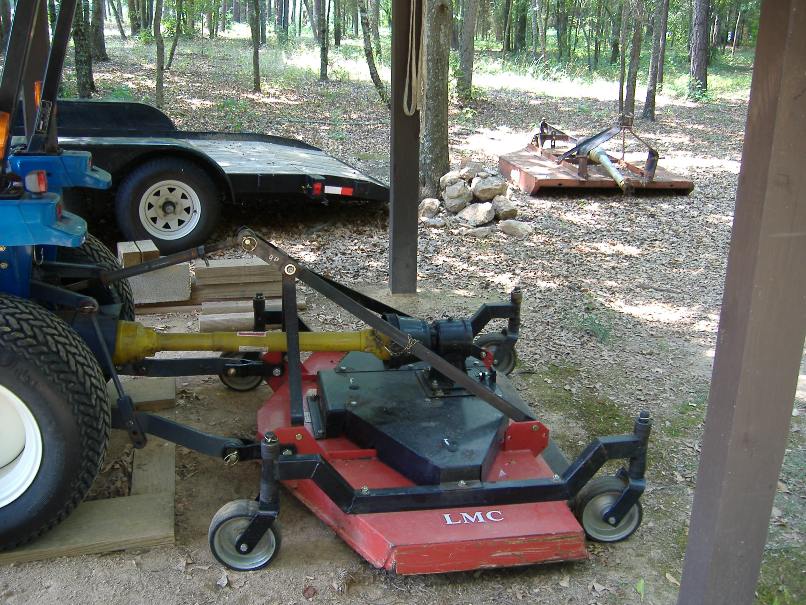

I've got a local small time implement guy here in Greenville, SC that sells new LMC finish mowers for $1050 for 5', and not much more for 6'. They're rear discharge, and I've been happy with mine. I looked for a long time, and this was by far the best deal I could find. The service is great as well, but I'm not sure that this guy's tech savvy enough to even have a phone, so service from out of state might be tough... PM me if you want details. Pic attached of my 5' behind my TC18
