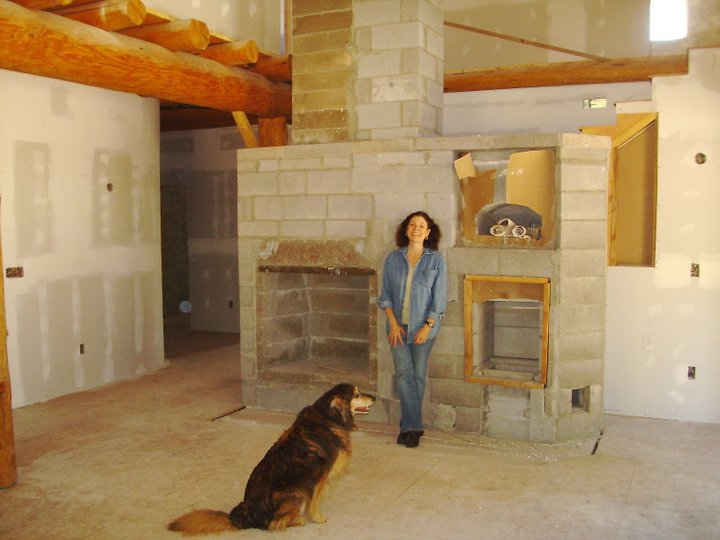

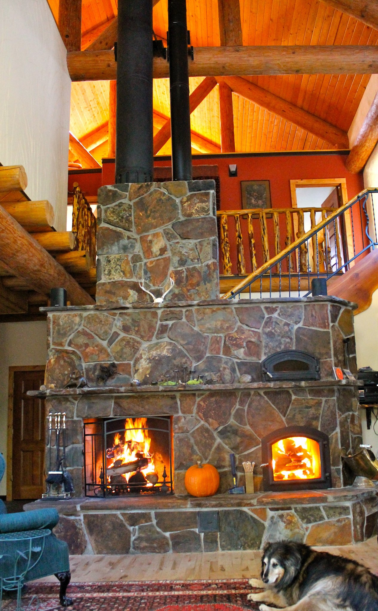

I, like you wanted an open fireplace for the ambience for our place in Steamboat. If you research good fireplaces, the rumsford style is at the top of the list. They now sell kits to make this happen. You will still have to do some masonry stuff, but they work awesome. The draft is what makes a rumsford so great, they draft and keep all the some out of the houses. Plus, they reflect all the heat in.
A very good design.

I am familiar with the Rumford style fireplace and even have a book about its history etc. That's what I've always wanted but finding someone to build one is another story.
The guy we are thinking about going with said he would not install an engineered masonry fireplace. He said they are fine for outdoor fireplaces but he did not recommend them for indoors. He did not say why and since I'd just met him I did not go into it with him. I don't even know if he is familiar with the different brands. To me they look ideal. But, they are not necessarily inexpensive either. I may talk with him more about it later.
After a lot of deliberation my wife and I have decided to bite the bullet and let this guy do it. We are hoping and expecting for this cabin to be in the family for generations and being close to 60 I want some time to enjoy it too. We are also concerned that building a real fireplace is becoming a lost art. The mason that the contractor is hiring is several hours away and the only one he knows and trusts to do it right. So we feel like we should get it done while we can. The expense is shocking but if the work is done right it should last for generations.
@EddieWalker, he looked at the footing the original guy put in and said he was going to remove it and do a better job.
This contractor claims that this mason can do anything in regard to fireplaces and builds them in high end homes to the owner's specs. So I might ask if can or if he will do a Rumford. However, I'm surprised sometimes how many builder and contractors are not familiar with them. The big issue there is that my wife has her heart set on a raised hearth. I think a Rumford would look odd on a raised hearth.

A friend of mine built this one himself.
