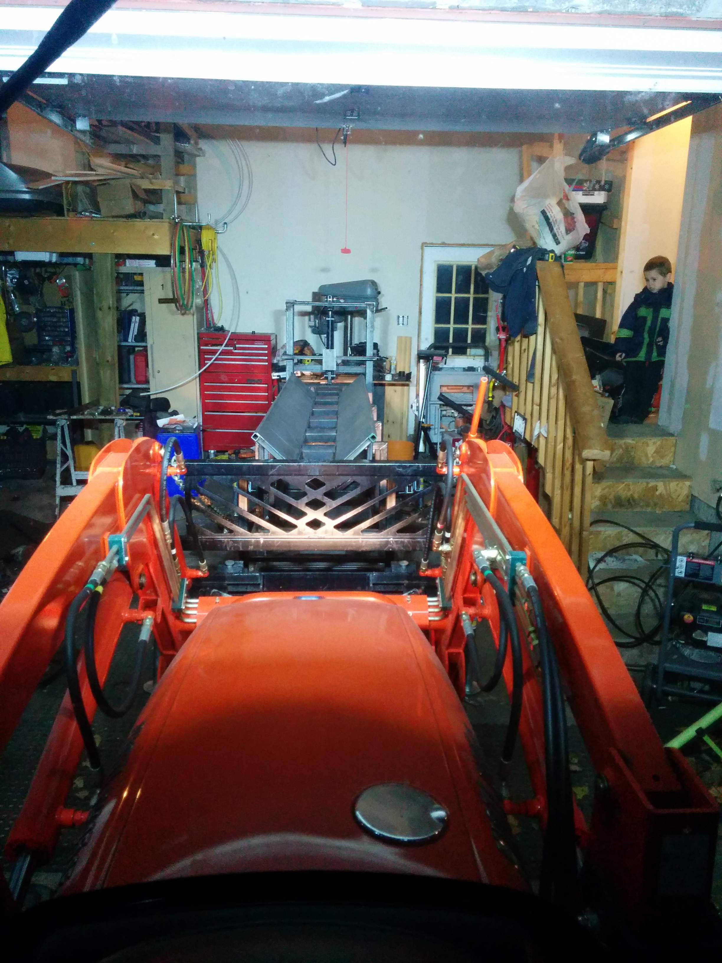

Well, I parked in my garage tonight for the first time since I started the processor. It's not all good news though...
I finished off all the little odds and ends today. I got the coupler earlier this week and installed it, but couldn't get a bolt to fit the engine mount to the engine properly. At first I just figured it must be a 5/16 fine thread since my coarse didn't seem to fit properly, but I kind of had my doubts because I could thread a 5/16 coarse a few turns before it got uncomfortably tight. Of course the 5/16 fine thread I made a special trip for didn't turn at all so I went back to coarse thread and managed to get two in to hold it while I finished mounting the pump. It finally came to me that this engine is a Chinese knock off of a Honda and that it was probably a metric bolt. I managed to pick up some M8 30's (almost the exact same thing as a 5/16 1") and it fine perfectly. I replaced the two 5/16 bolts I used and it didn't seem to be any worse for wear. I couldn't get grade 8 metric bolts on a Sunday though.
After adding fluids and checking everything over a couple more times, I fired it up. The engine ran for a seconds, then died when I took the chock off. I fired it up again, it ran a little longer, then died when I took the chock off again. I did a little inspection at that time and discovered that the fitting coming into the bank of 3 valves was leaking. I tightened it up, figured out I'd turned the fuel off instead of on, fired it up again, but it still leaked and not just a little. It's obviously the wrong fitting, something I've had several problems with so far. All the parts, except for the pump are from Princess Auto, and I asked for help since hydraulics are new to me, but their hydraulics "expert" might just be the guy that drew the short straw, this will now be my 4th trip back.
The fitting I can deal with, but that's not my big problem. While I had it running the second time, I tried the small cylinder to raise/lower the cutting head (without the cutting head installed). It extended down very quickly, but when I tried retracting it, it almost stalled the engine. Next I tried the splitter cylinder. It extended, although not very smoothly, but would not retract. It didn't bog the engine down like the other cylinder did, it just didn't do anything. I didn't keep trying it since it was leaking like a sieve and I figured something wasn't connected properly. Any suggestions would be appreciated.
Then I went to fold the legs up so I could move it and realized I welded the brackets on backwards :ashamed::mad: Now the legs will not fold up and there's a 4 - 6" gap between the trough and the deck, so it's going to make it interesting to drag logs into the trough. I'll have to live with it this winter and I'll fix it in the summer.
Here are some pictures of it coming out of the garage and then fully assembled. Now if I can figure out the hydraulic issues, I'll be ready to give it a try.

Looks great!! I've learned to expect and accept such setbacks when I'm working on projects even remotely as complicated as your processor. You'll get er whipped into shape. Still very much looking forward to seeing it in action!
