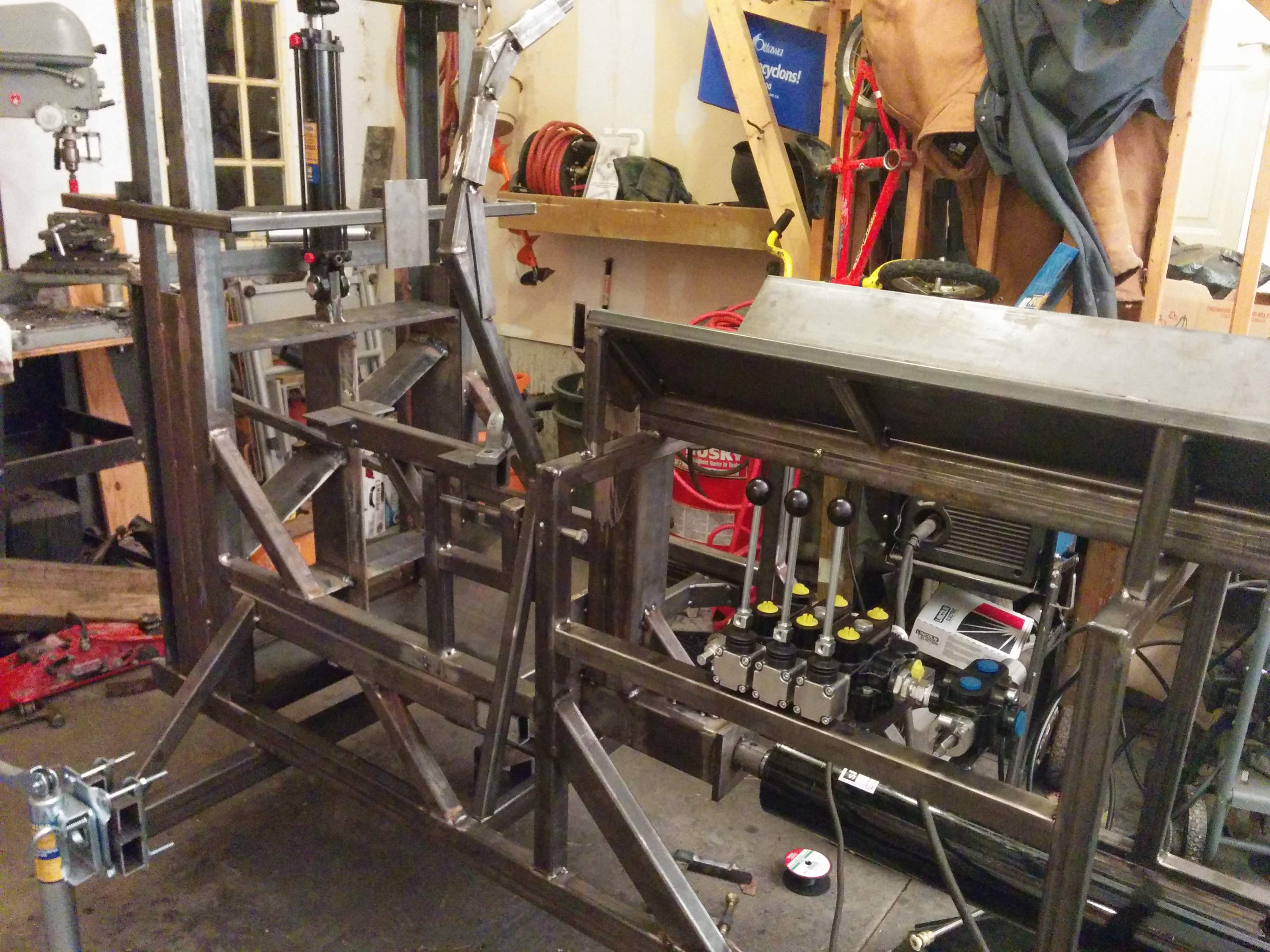

HEEEEELLLLLLLPPPPPPPP!!!!!!!!!!! The paint is still tacky except for the area that I used the paint without thinning it, in that area, it's perfect. Obviously, they meant what they said on the can and my paint guy was dead wrong. So, do you think it will eventually harden? Should I just put a second (un-thinned obviously) coat over top of it, even if it stays tacky? I don't have a sand blaster, the weather's getting rough so there's no way I'm stripping off the paint I've already applied. I'm leaving it tonight to see if there's any difference this time tomorrow, but it's been 24 hours and I'm supposed to be able to re-coat by now.
/ Firewood processor build thread #146
Can you heat it up Ken?
/ Firewood processor build thread #147
Those high tech paints can be really touchy about thinning, not only what is used, but thinning in general.
To spray high solids, industral paints akes industrial gear. I know its a bit late now, but thats why I usually recommend that homeowners either brush paint like that or if they insist on spraying, use something like Tremclad. Thats ignoring the chemical hazards of Urethanes as well.
4336 is a Urethane modded alkyd. You found an incompatibility with your Lacquer thinner.
You can try cranking up a heater near it to maybe "bake" it, but in all honesty I think your screwed.
Id run it as is. It doesnt take long for paint to get bashed up on a processor. Otherwise, youre looking at stripping it (chemical stripper, inside) and redoing. Not the end of the world in its disassembled state, but likely more than you want to do.
If you paint over it, the paint will likely be soft underneath the new top coat and will allegator or lift over time.
One possible cause of your problem I just thought of... Does this place sell a lot of industrial paint? Ive seen it where paints are old stock and wont harden. Its likely not the case because the non-thinned paint worked, but it just came to me. I went looking for the datasheet on this paint because I was not familiar with it, and could not find a listing for Devguard 4336 on the main Devoe site. I eventually found a datasheet through another search however. Makes me wonder if it is a current product and you didnt get sold old stock.
One thing I learned painting, for the most part, the instructions are there for a reason and need to be followed to a T. Higher performance paints especially. Where Tremclad is idiot proof, these paints arent.
Again, Id probably run it as is, and save the repaint for maintenance in a couple years.

Well, that sucks! Thanks for such a detailed, depressing response, I agree with your views, "I'm screwed". I have the shop heater at the end of the processor blowing hot air over it. Some parts seem tackier than others, but where it's tacky, it's obviously very soft and can be scratched down to the metal.
I don't know how old the paint is. I did just call the person who sold it to me and he's trying to get in touch with the local rep. He told me over and over that there would be no issue thinning it with a little lacquer thinner to get it to spray properly. Pretty obvious he was wrong.
Out of curiosity, what type of industrial gear are you talking about? Should I have rented an airless sprayer? Unfortunately, I needed to spray to get into all the nooks and crannies of the processor, you'd never get a brush in some of them.
So, I'll see what the paint guy has to say, but unless he's going to volunteer to come and strip it for me, I doubt it's going to matter much. I think I'll leave it in places it wont really be touched like the bottom side of the trough but try and take it off using a flap disk in areas it's going to see weather and be knocked about. Like you say, it's a lot easier now then when it's re-assembled. I'll just have to see if it simply gums up a flap disk, I don't have a sandblaster.

Just got off the phone with the paint store. The product rep says there shouldn't be an issue with a small amount of lacquer thinner and that he'd like to give it a little more time to dry. Claims the darker colours can take longer to dry. They think it's going to dry and be OK.
I'd love to believe it, but the fact there's such a big difference between the area I painted un-thinned vs the rest of it that was thinned, I have serious doubts about it.

Hate hearing about your paint problems. But sounds like a little hardener is needed. But I have only messed with implement paint and we always added about a cap of hardener to a can of paint. Sometimes still took a couple of days to dry. Been about 15 years since I painted though so they may have changed by now.

As much as it sucks, I think you are right. Paint that doesn't dry in the listed time (or close to it) will never dry. If another 24 hrs doesn't do it, nothing will, even that is a 'fingers crossed, hoping to win the lottery' 24 hr wait. If at that time it still hasn't cured (it's just soft, not sticky right?) I'd assemble it and run your load of logs thru to see how it goes. If it needs any tweaking do that and then wait for summer to strip it down and repaint.

After about 6 hours with the 220 v shop heater on it, it's mostly dried but some of it is still slightly tacky. No doubt it's still soft in spots if not everywhere. You're absolutely right, I'm leaving it, assembling it and trying it before doing anything else. As we talked about when you were here, I'm being lazy by not getting it running and testing it before tearing it down to paint, so this will sort of give me that chance. Please PM me his number whenever you get the chance, that way I'll have it for future reference. I think I'd just go that route if this paint doesn't stick, the sting of spending money on it will be gone and it would be done right. I hate painting, I'm obviously not very good at it.
Thanks for the info. Is this your profession?
For gear, a proper airless is good (best?). You need one with enough oomph to pump heavier paints though. Another option is a pressure assisted paint gun (pressure pot). That will help lift the paint to the gun. Proper tips are important. And above all, you need enough air volume.
Try a wire wheel on a grinder on the soft stuff. It will likely roll up and flick off. Flap disks will likely plug. You might even be able to use solvent and wipe the parts clean. Data sheet calls for Naptha or mineral spirits. Being soft like this, it wont take much stripper if you go that way.
Its not my trade per se. Ive worked in industrial maintenance and in fab (welding) shops over my career. Lots of big stuff gets painted with similar paints and Ive had the misfortune of being designated to do some of this painting (lol). I also do a lot of autobody in my spare time. Im a bugger for punishment lol.
Edit: good to hear that heat is helping. I still say there is something else going on other than dark colours (first time I heard that). Data sheet says dry to touch in 1 hr. That is typical. 24h(?) drytime is way over spec. Even if it gets "not tacky" I doubt it will actually be cured correctly and have the strength of the unthinned paint. However it will likely be just fine on a firewood processor.
