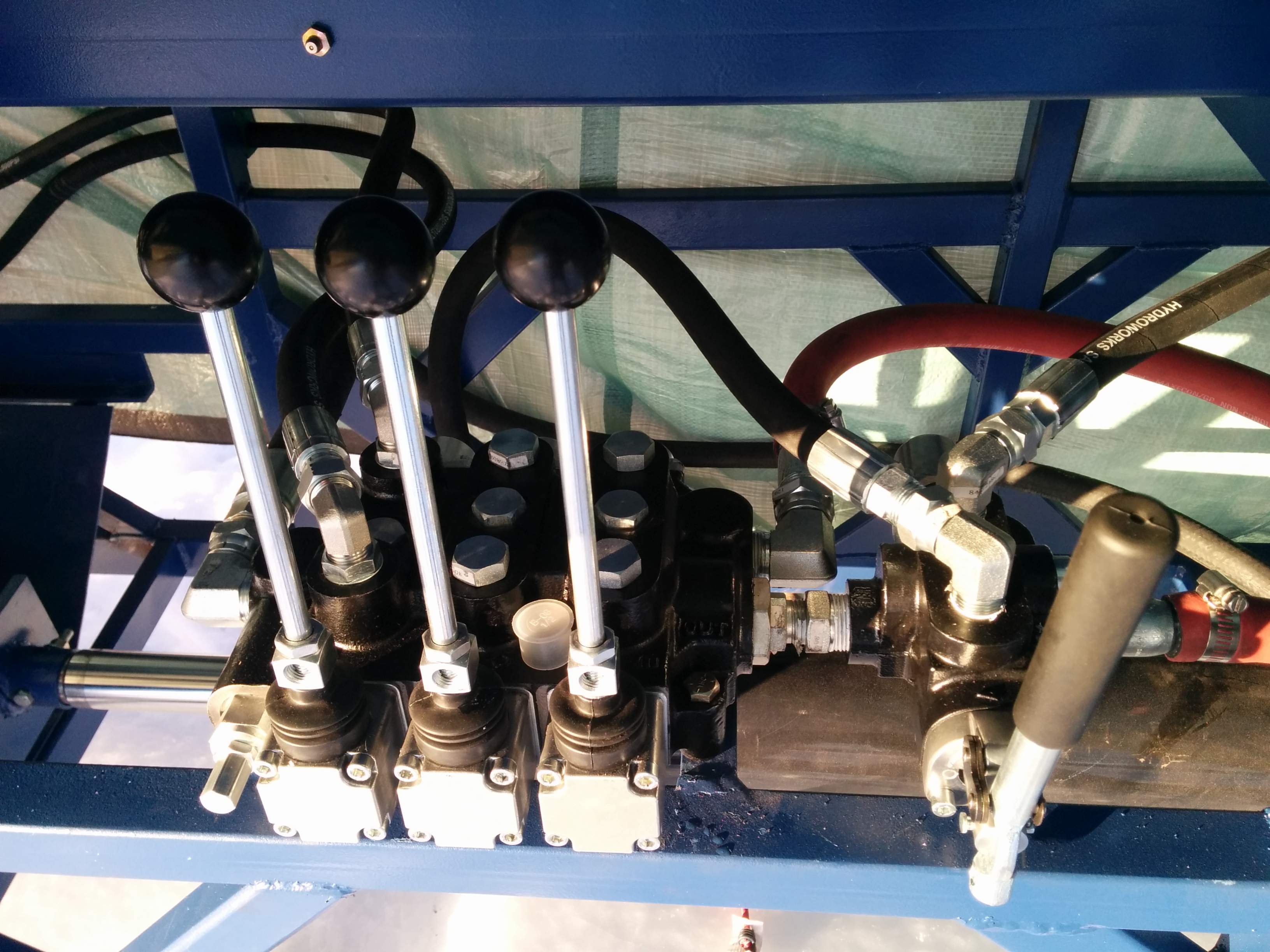

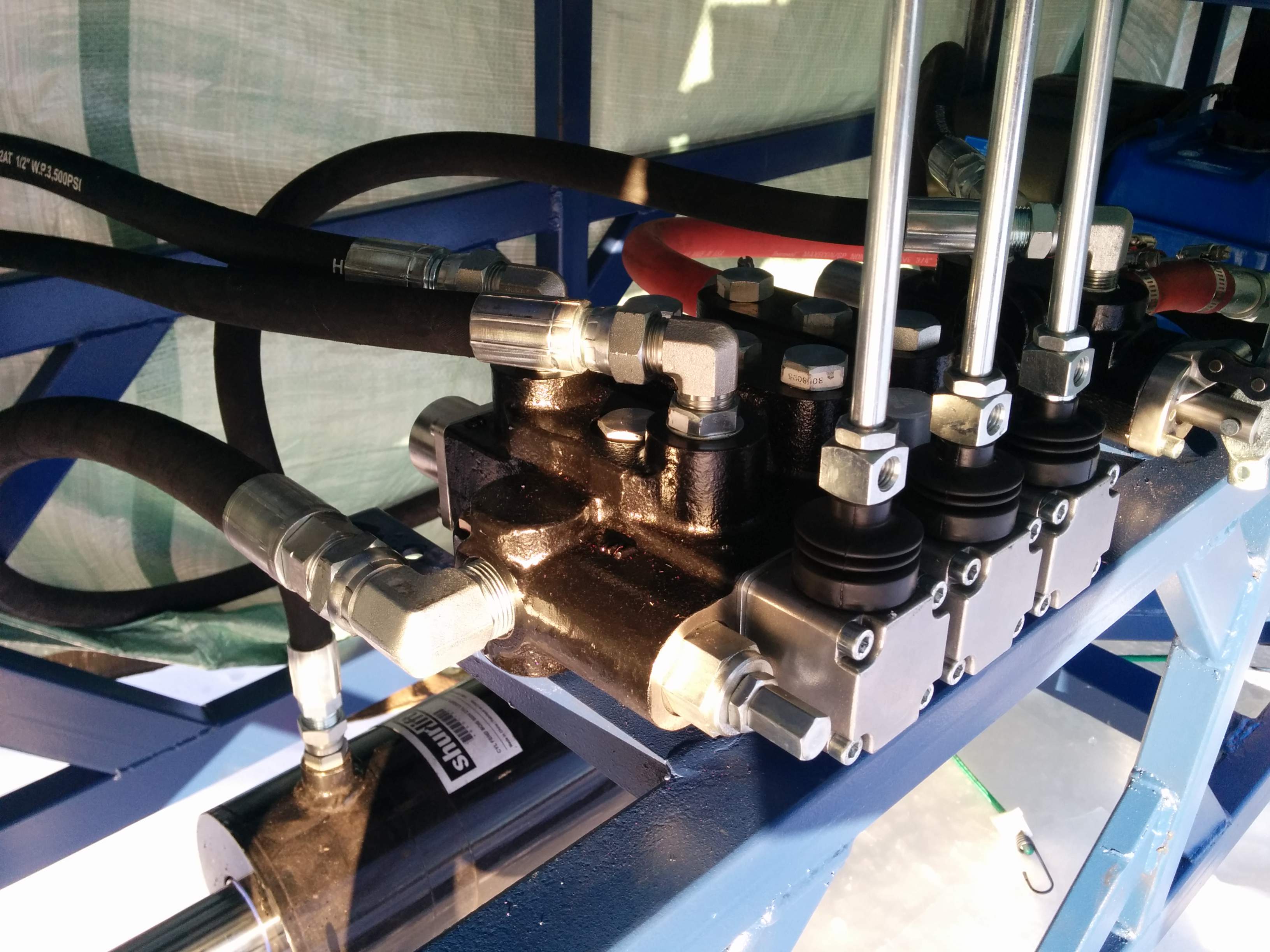

ANy closeup pics of your plumbing? I looked back a couple pages and didnt find one.
Here are a few from this morning.
I think I see that there is a needle valve restrictor in there? Its not choking something off to cause your weird performance issues? Is it installed in the right direction? Its not in a return line is it? Could be air too, but you got to get the leak fixed first. Air can cause jerky , erratic movements.
No, no needle valve restrictor, at least I don't think so :laughing:
What valve is the 3 spool? With that info we can determine what the proper fitting is. The PA website is pretty good at listing that for their valves.
MD30 3-Spool Directional Control Valve | Princess Auto
Do you have a pressure gauge installed?
No, I meant to pick one up last time I was there but plain forgot. Since I'm disconnecting the fitting anyway, I'm going to throw one in.

The inlet for the 3spool looks like a normal NPT elbow, it requires a #12 (3/4) ORB ie: O-Ring Boss. Similar to whats there, but significantly different. Easy fix.
Ahh I see now that there is no restrictor. The T in your return lines looked like a restrictor in one of the pics.
Pressure gauges are essential.
I dont see anything in your plumbing that stands out, other than your return system. Not a really big fan of the hose clamps!. There should be minimal pressure there, but I still dont like it. There can be minor spikes of pressure on the return. Not really that important unless you start blowing hoses though.
Im not sure what model of Splitter valve you got from PA. The PA site is down right now. But I think it has a relief built in. When you get your gauge in, Id wind the relief on the splitter valve all the way in and use the one on the 3spool to set relief.
Try reversing the hoses on the valve for the splitter. See if that will make it retract.
Once a gauge is in there we can see more of whats going on.

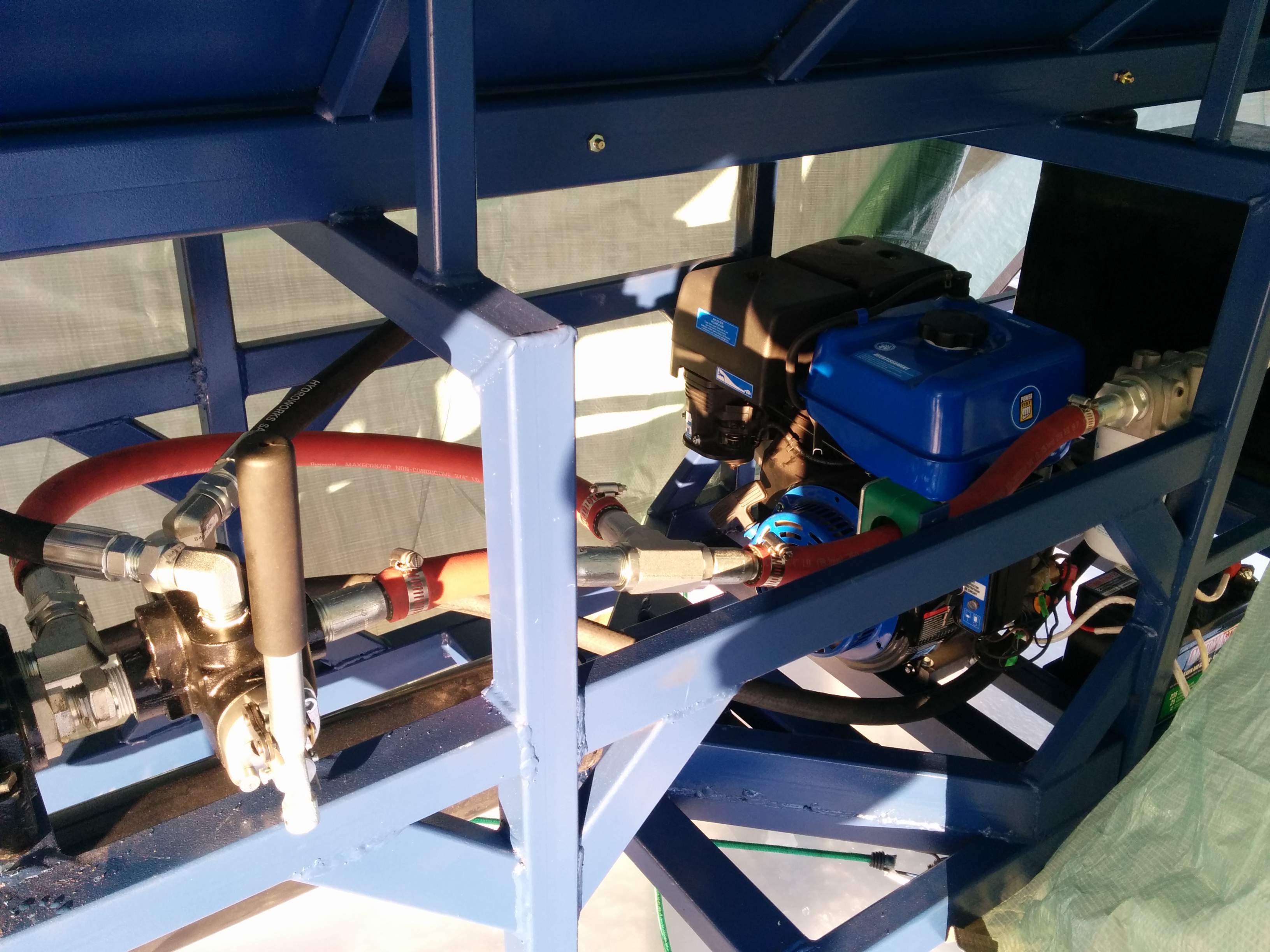

The leak should be fixed now, unfortunately, it's WAY too cold to try it right now. I also want to hear back about the supply line before going any further.
I thought I'd post a few pics of the fix and of the wood that was just delivered. It's a real mix this year where last year it was almost 100% sugar maple.
New fittings and pressure valve to stop the leak
The suction hose from tank to pump

Youre using a 28gpm 2 stage Haldex (Concentric) pump?
I probably would not run it with a 3/4 hose particularly in this cold.. Are you sure the fitting on the pump inlet is 1" and not 1 1/4?
Checking the Parker hose flow chart for suction lines 1 1/4 should be whats spec'd. If its 1" on the pump, it seems like they are cheating a bit. 3/4 only will flow 10 ish for a suction line, less when the oil is cold.
Id probably plumb it with 1.25 from the tank then bush it down to 1" at the pump. And you really should have a shutoff first thing after the tank for future service and repairs, and the ability to shut the tank off when the processor is in storage.
I do like how your pump is set lower than the tank which keeps the pump primed. Pipe tape on hydraulics scares me and while up for debate, is a bad idea IMHO.
Id just go and try the wedge as is. If it jams, then rework. No since tearing it apart now, it may work fine.
