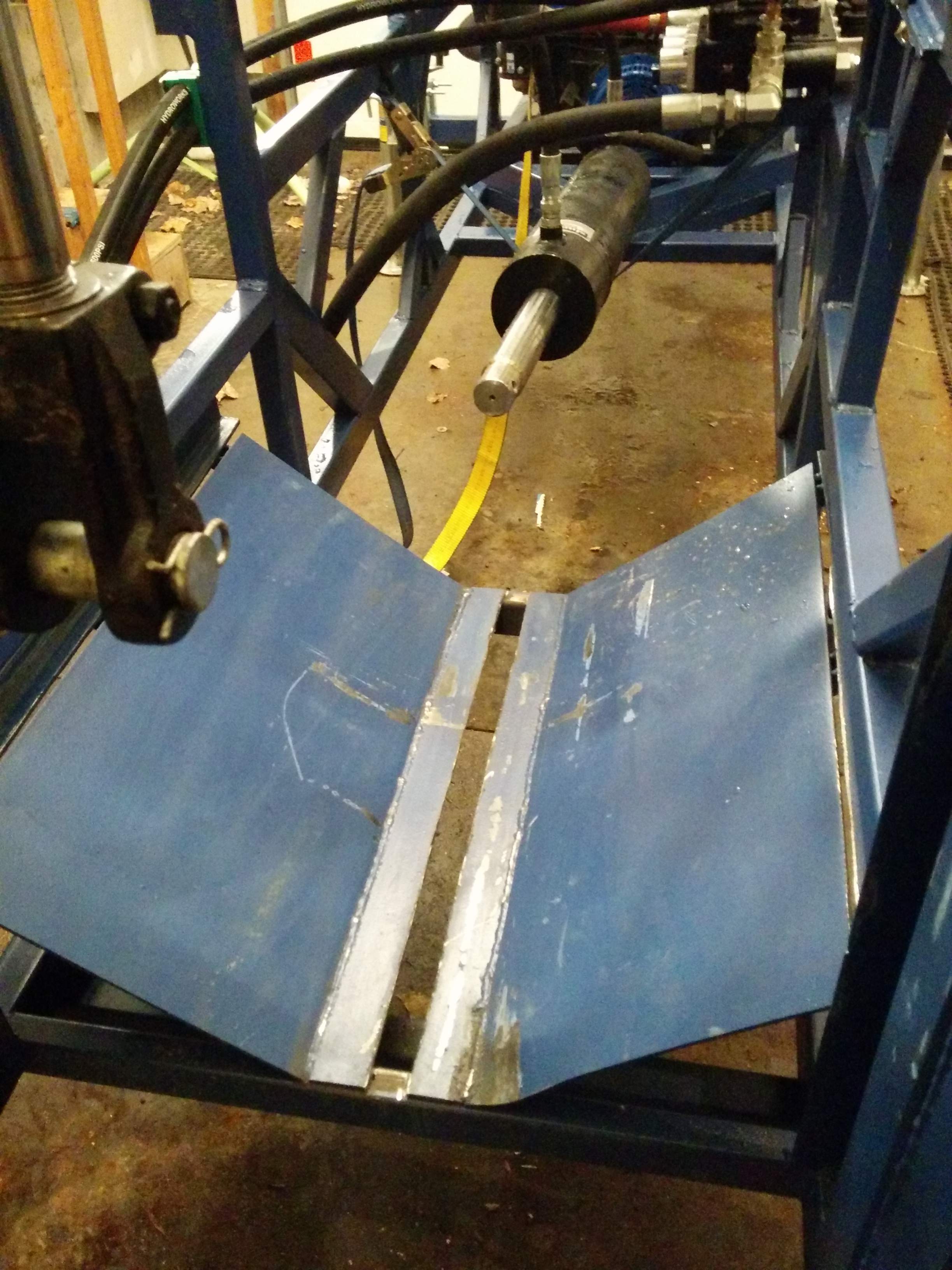

So, I'm not cutting it up as much. I'm going to add a groove down the middle of the lower log trough, add bigger, stronger, longer rails under the existing ones and have the ram tied into them. With this modification (that I should have started with), my sled design would probably work just fine. Doesn't matter, I'm ditching it and going with rollers. They may not be the best choice for everybody, but for me, all the wood that's delivered seems so straight, I think it will work well and be the easiest solution. I'm going down to 5 powered rollers though, I'm going to keep the sled (which is why I have to ditch the last powered roller), add an adjustable leg at the far end and have it stick 8' out the end of the processor. My logs are 16' +, this will allow me to process 20' logs no problem. I'll add non powered rollers and I'll be able to attach the sled and remove it as needed.

Last thing I got done was to cut a slot in the bottom of the trough. An 11" x 1/2 plate will be welded to the bottom of the pusher plate and go through the slot. A 1/2" by about 2 1/2" piece will be welded at the bottom of that piece just wide enough to slide between the rails, it will look like I've made my own I beam shape. Under that, a wider piece of 1/2 plate will be bolted to the one sliding between the rails and will slide along the bottom of the rails. This will keep the pusher from rising. I also have a large sheet of nylon or teflon or some similar material, that's 3/4" thick. I used part of it to make a cutting edge under my blower to protect my driveway. I'll cut and rip more of it to surround everything and allow it to glide smoothly.

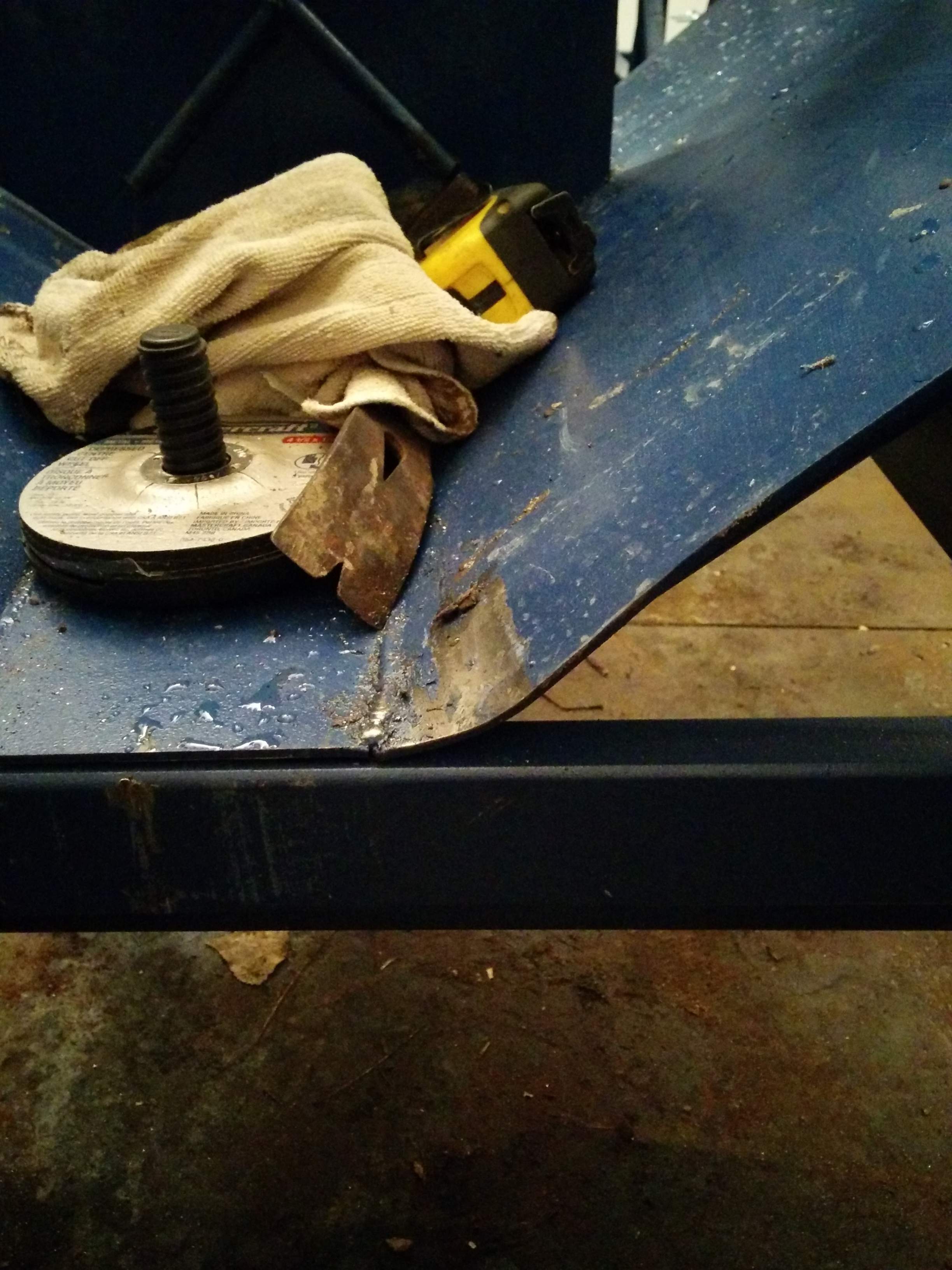

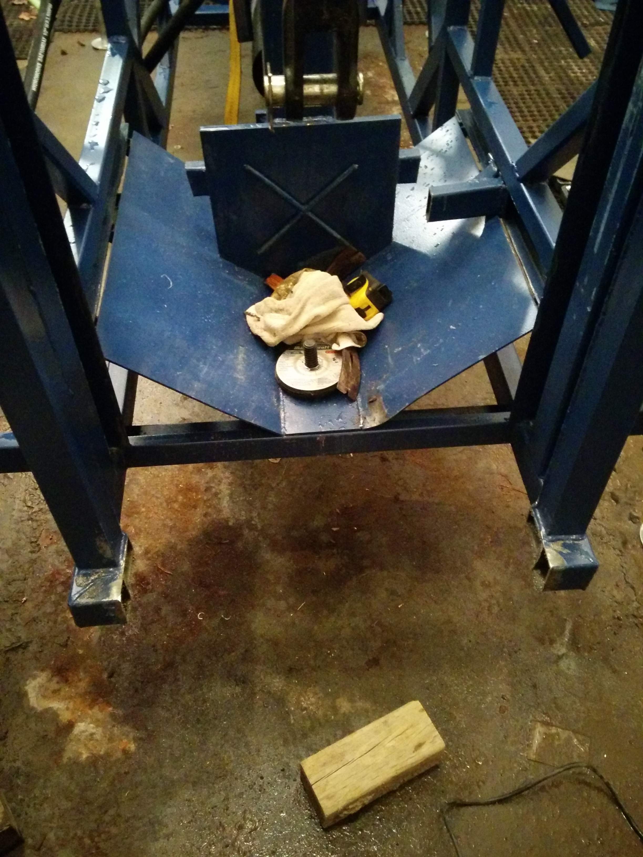

I went out again last night to get a few more things done. I won't be back out again till the steel arrives. The hydraulic motor has also been ordered, I just need to get flange bearings, sprockets and chain.

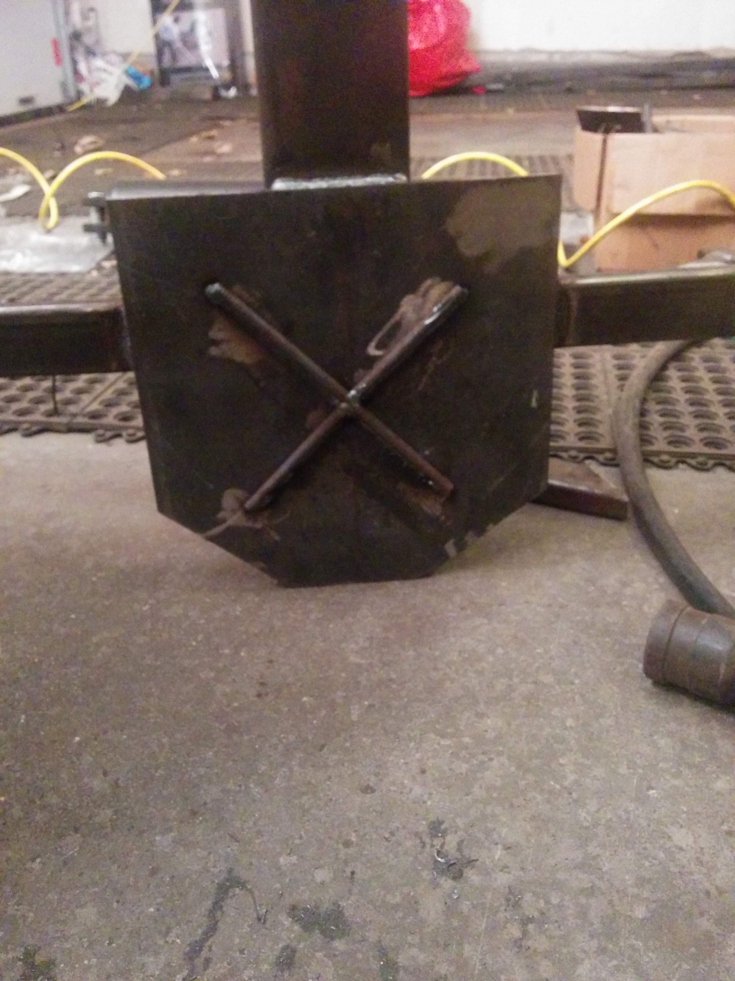

Cut the bottom of the splitter head out. This will allow the 4 way wedge to work properly without being jammed. I'm also going to re-purpose the two 6" X 10" - 1/2" pieces.
(it's upside down in the pic)
Next I cut off the log deck brackets. I mentioned earlier, I welded them on backward which prevented the legs from folding up properly and left a gap between the log deck and the trough. Figured if I was scratching the paint now anyway, I might as well fix it.
Then I removed the sled from the trough. Not an easy task, it always fit too tight and may have bent slightly when I used it. I also forgot to grind down the edges I cut so it probably had a good bur to fight against. I had to open the garage door to pull the sled. Inside the garage was probably 17 - 20 C and outside was something like -24C It was like a cloud rolling in when the door opened, picture doesn't do it justice.
That was all I could think to do, now I just wait for the steel to show up.

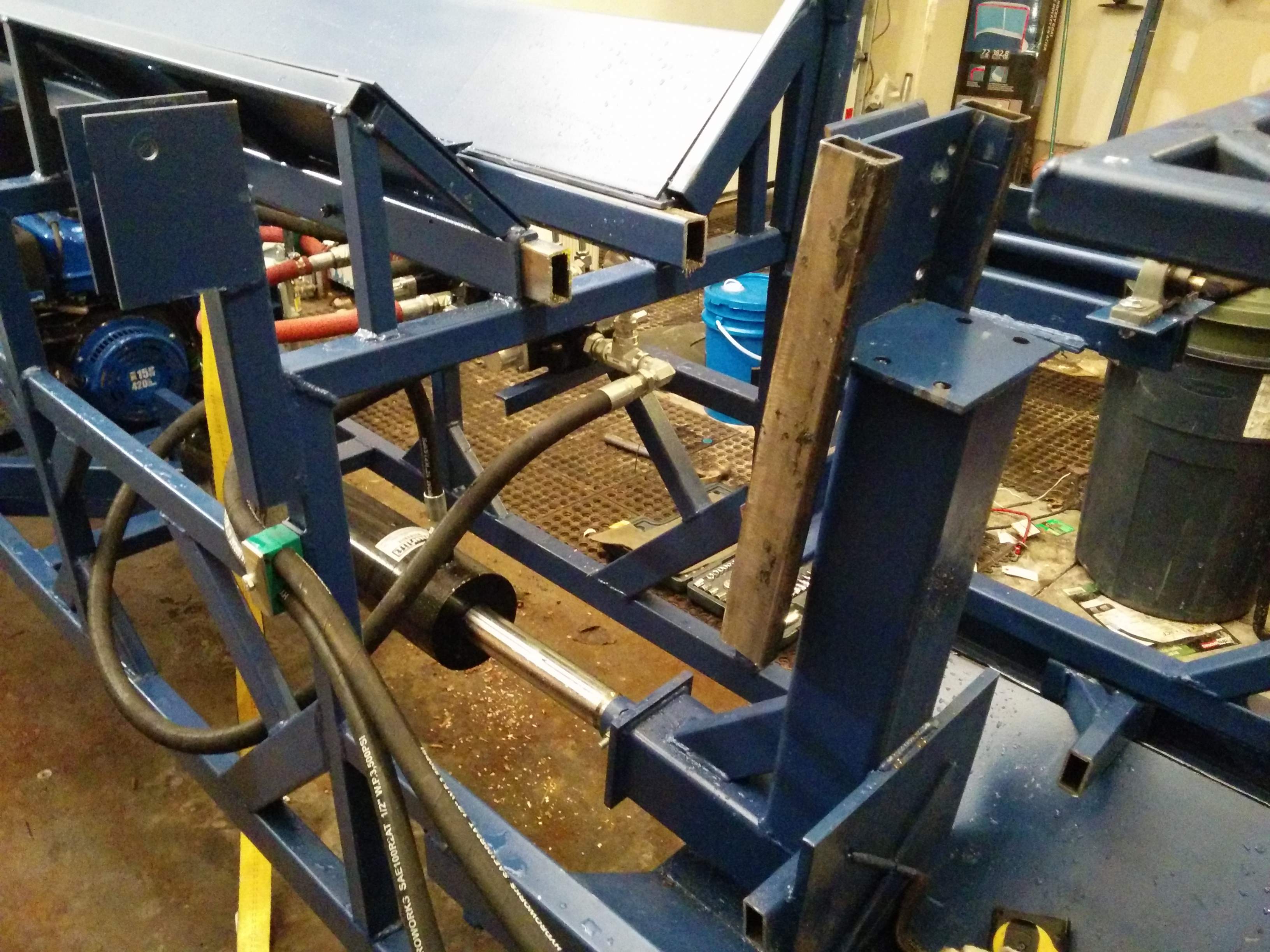

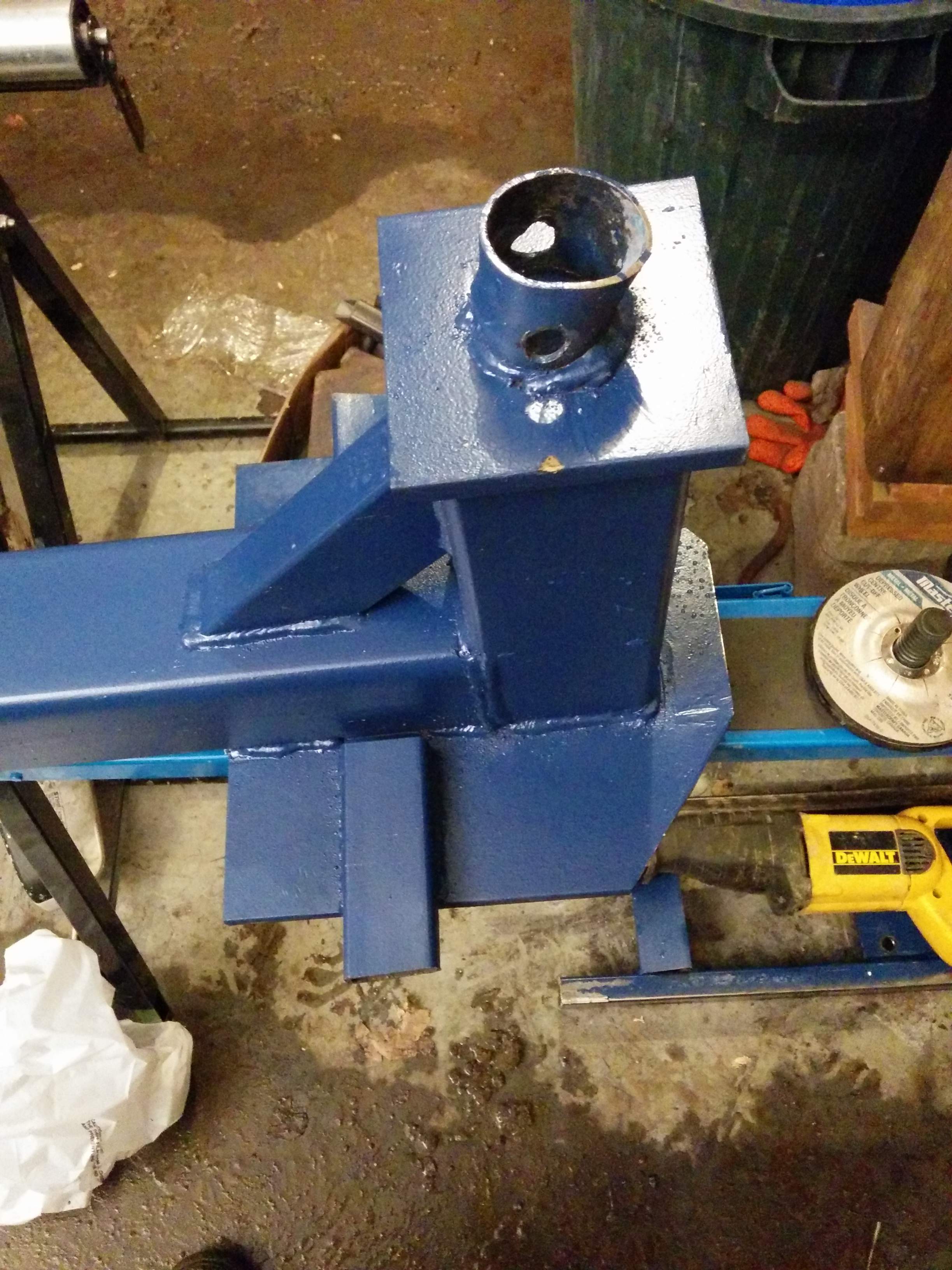

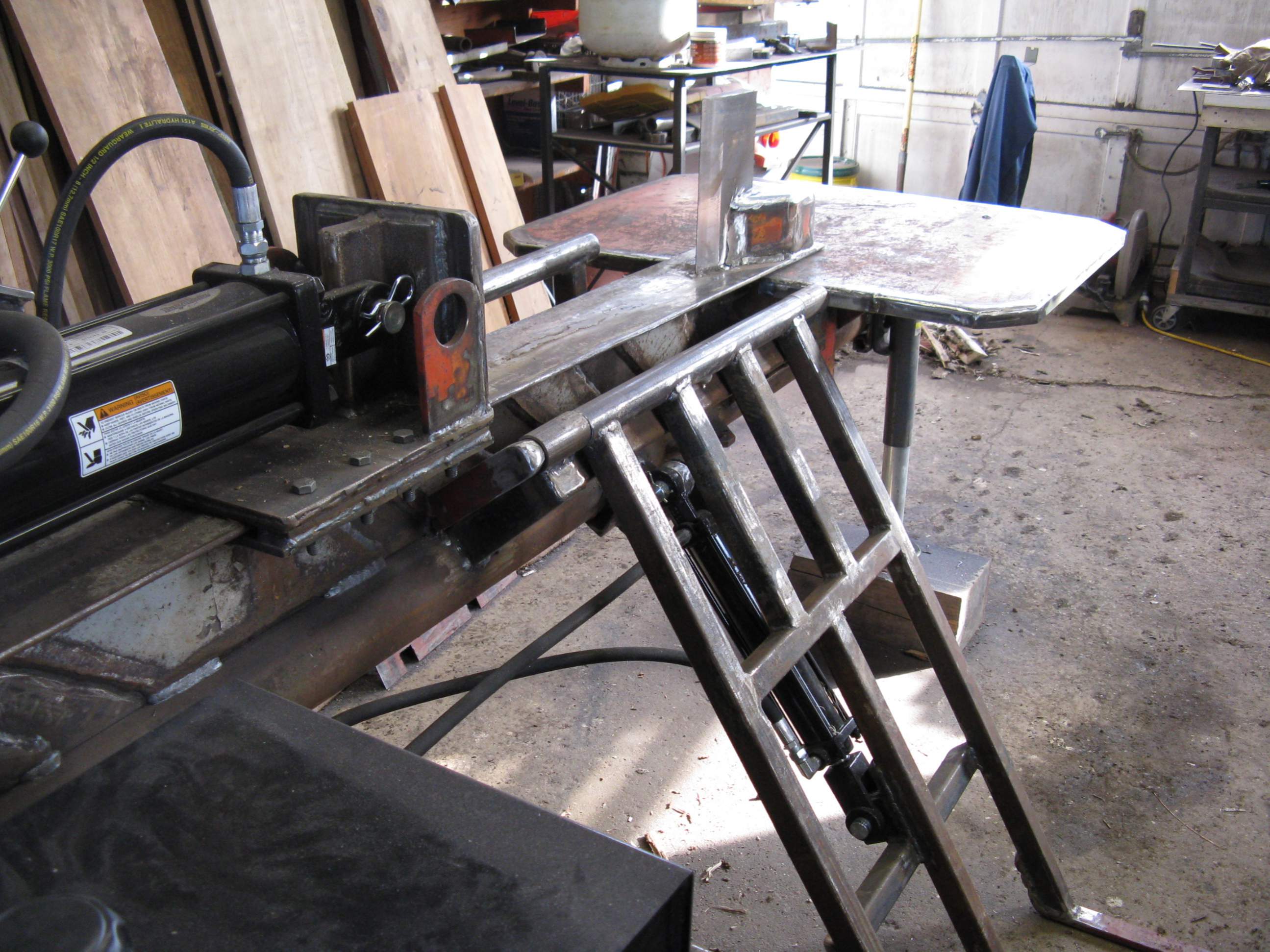

I started re-structuring the processors frame this weekend. It doesn't look like I got much done, but it was a lot of hard work. Working under the machine to cut small pieces out here and there isn't fun. Grinding, sanding and welding under there isn't much better. I'm actually sore this morning from the workout.
Sorry, pictures aren't very good
I started by doubling up the processors frame from the cutting head back behind the attachment point for the cylinder. This involved cutting out the cross member that made up the legs. They then got re-welded to the new frame. I used 1 1/2" X 2 1/2" - .188 (3/16), debated going all the way to 1/4 wall but with all the bracing now in place, decided .188 would be fine.
I welded a new cross piece at the back. It is 5" lower than the previous one and is 2" X 4" - 1/4. the only problem is that the splitting head isn't tall enough to rest against it when it's in the 4 way position so the sides will take all the pressure. I don't think that's the end of the world and I can always have the cutting head lengthened. The splitting head will rest against it in the 2 and 6 way positions.
I then started in on the rails for the pusher plate. They are also 1 1/2" X 2 1/2" - .188 and they mounted under the existing 1" X 2" - .125 rails that made up the bottom of the lower log trough. I didn't get finished last night but the new rails are tacked in place, I now need the cross member at the end of them and to extend the 1" X 2" rails on top of them to support the pusher plate when it's retracted. The rails have a 2 5/8" gap. Under the pusher plate, I'm welding a 1" think piece of plate in the vertical position and bolting a 3/4" thick piece of nylon to each side. That should give me 2 1/2" and leave a 1/16 on each side.
