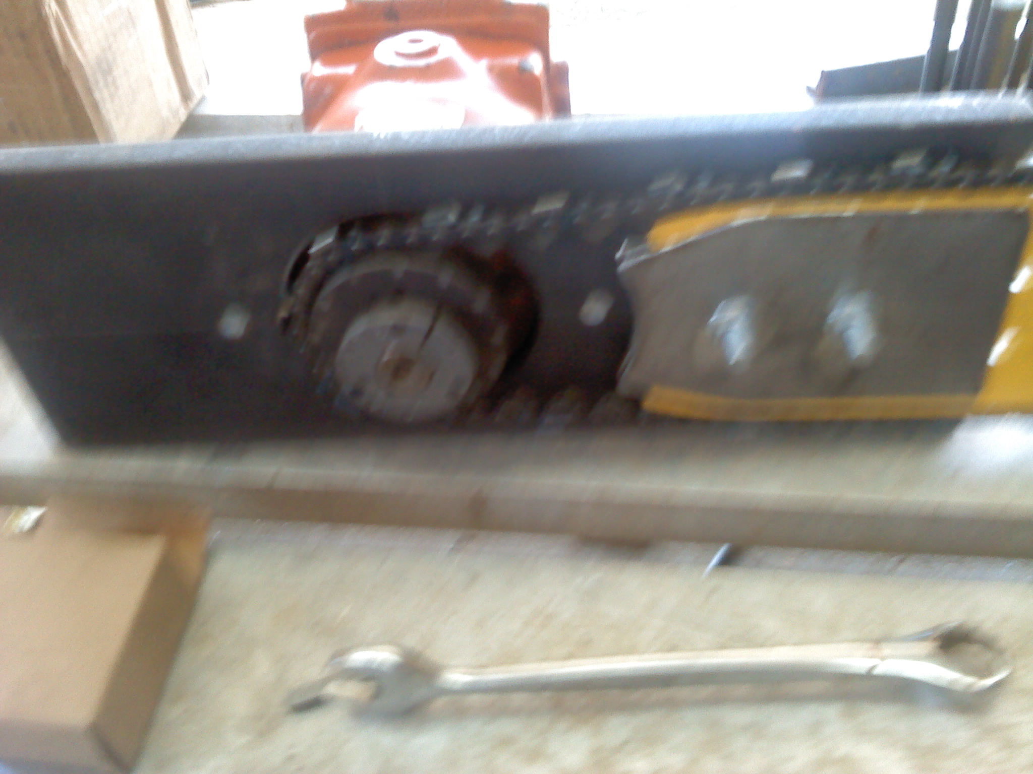

Thanks woodchipper. Yes, the keyway issue was resolved a while ago. With the motor installed on the processor, I was able to clamp on to the key with a set of vice grips and gently hammer it out. That was actually before the suggestions of using a punch, I'll know for the next time. No doubt a video is coming soon...
/ Firewood processor build thread
#322
DOOOOOONNNNNNNNNNNNNNNEEEEEEEEE:cool2::dance1::drink::p:D:cool2:
This picture was taken at 1am last night..., errrr, this morning.
Thanks for the suggestions for breaking the chain, worked like a charm, but the pin was still hard to knock out, a lot harder than I would have guessed anyway.
Proof the rollers are actually black!
The chain is on!
I also added two more trailer jacks to support the weight of the logs sitting on the in-feed rack.
Because we got snow last night, I'm not sure I'll have time to clean it all up and pull the processor out of the garage tonight. With my tractor raising and lowering the processor, I can install the splitting head again and then have the log deck to re-attach. Since it's all right outside the kids bedroom windows, I'd have to get it all done before they go to bed. I'll post video of some of the process since the processor will be running to install the splitting head and then video of the first couple logs this weekend. Thanks to all those who stuck with this very long drawn out thread!
