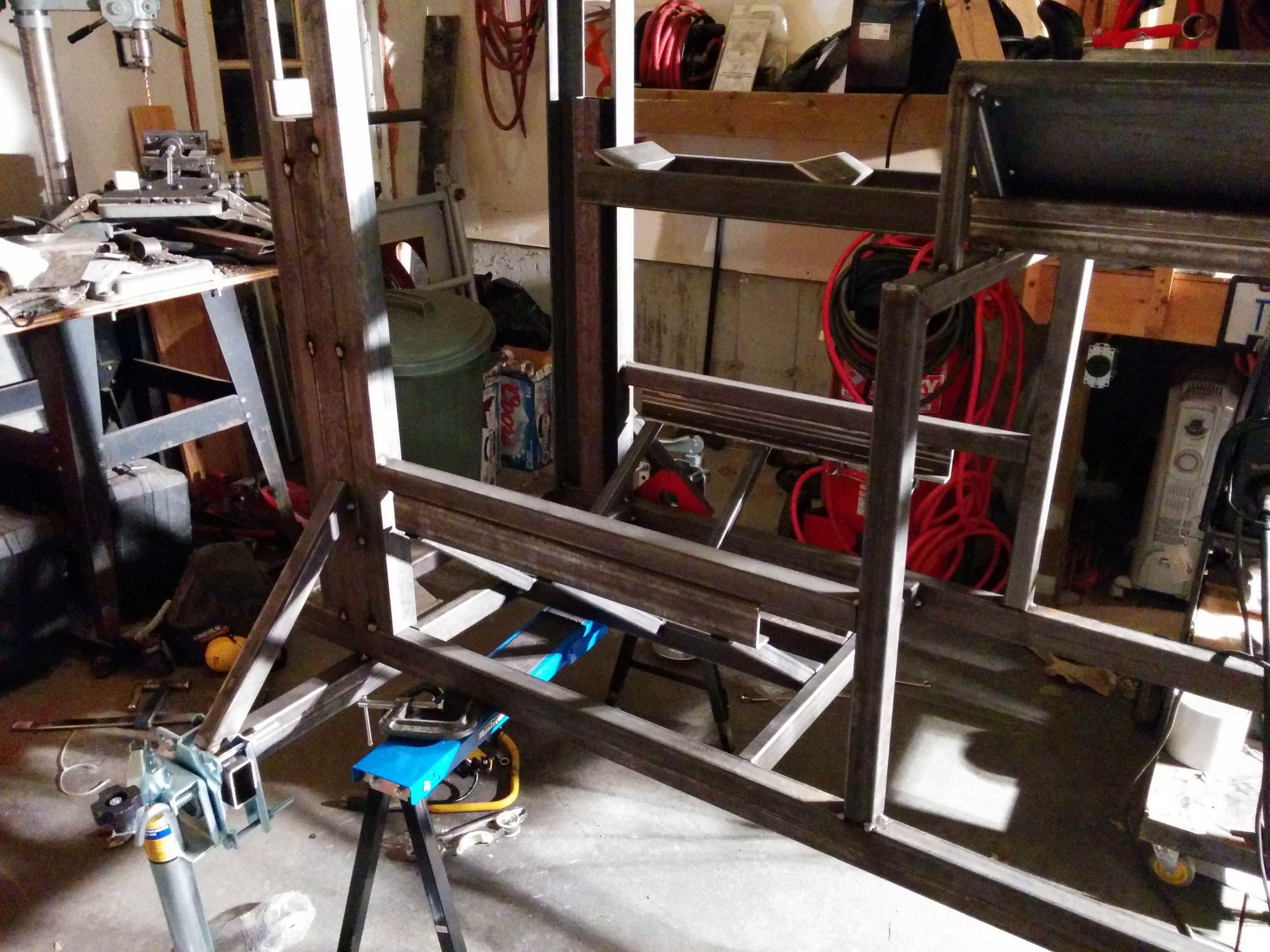

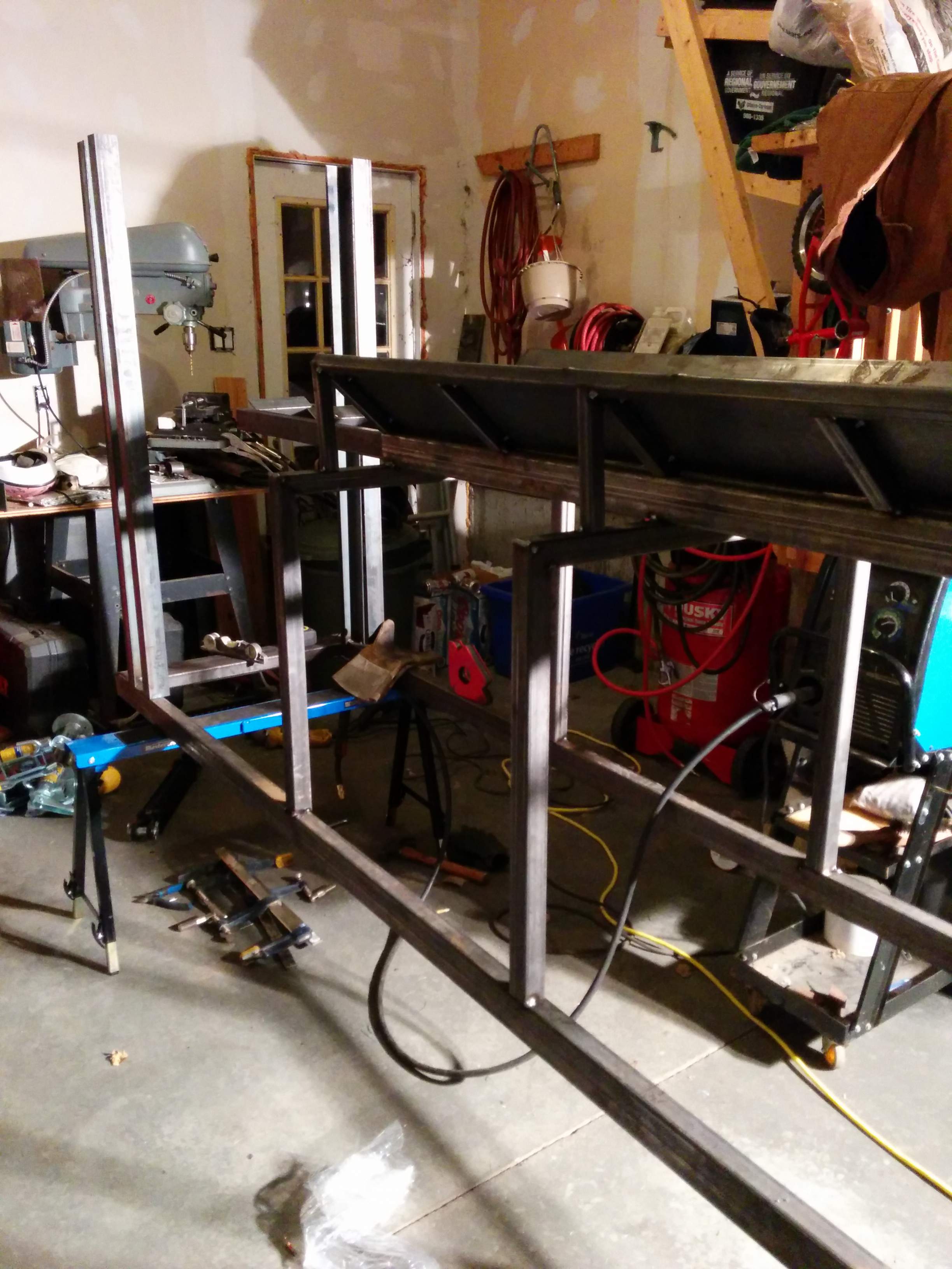

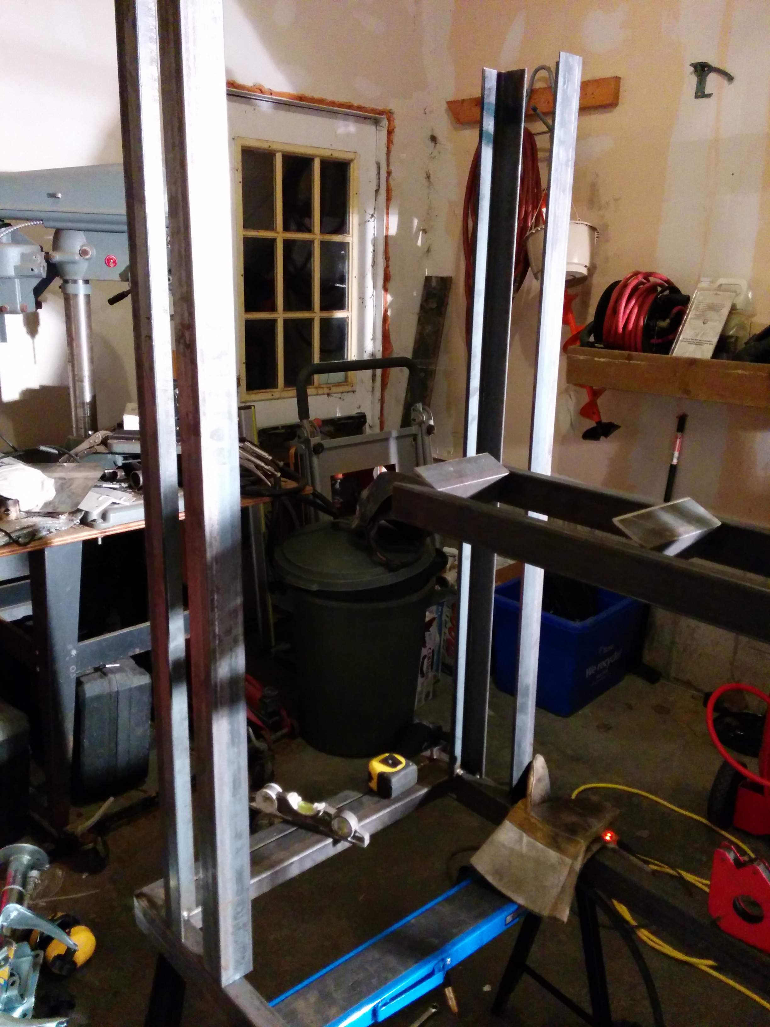

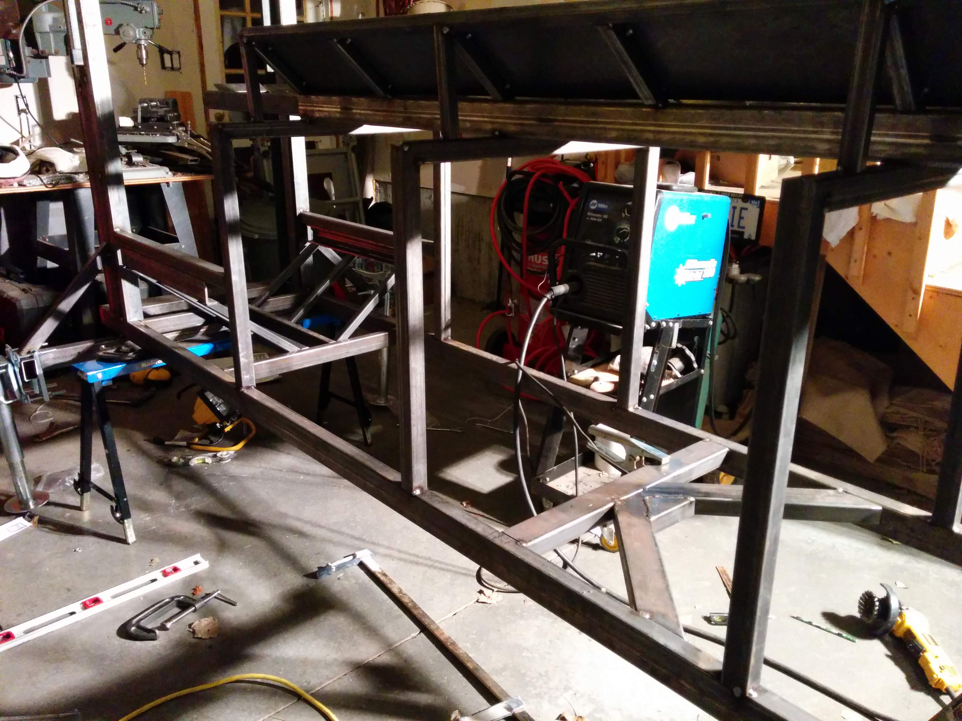

OK, a little more done today. It actually took a really long time to get a little bit done, lots of finicky kind of stuff. With my design, I'm very concerned about the whole thing binding up and tearing itself apart or bending so it no longer works. The top sled has to be perfectly aligned with the ram and the bottom trough guide. Here's where it is now.
It can finally stand on it's own!
Drilling 1" flat stock is tons of fun! Lots of cutting oil and patience.
Ram finally in place, even if it's just tacked. More bracing will be going behind the 1" plate.
My little Miller 180 turned up to full. I've never done that before. You can see it's getting some heat in there, but it's really not up for this size material. This is just the push rod, so it will be more than enough to hold.
The ram fully connected to the push plate
Top sled connected to the ram
The whole thing with the 1 way cutting head installed :D
I've also decided to farm out building the cutting head. Grinding down the 8" of 1" plate for the ram so it could be welded convinced me that I don't want to try grinding many feet of it to a sharp edge. I'm not sure my welds would hold anyway, so I'm going to price it out.

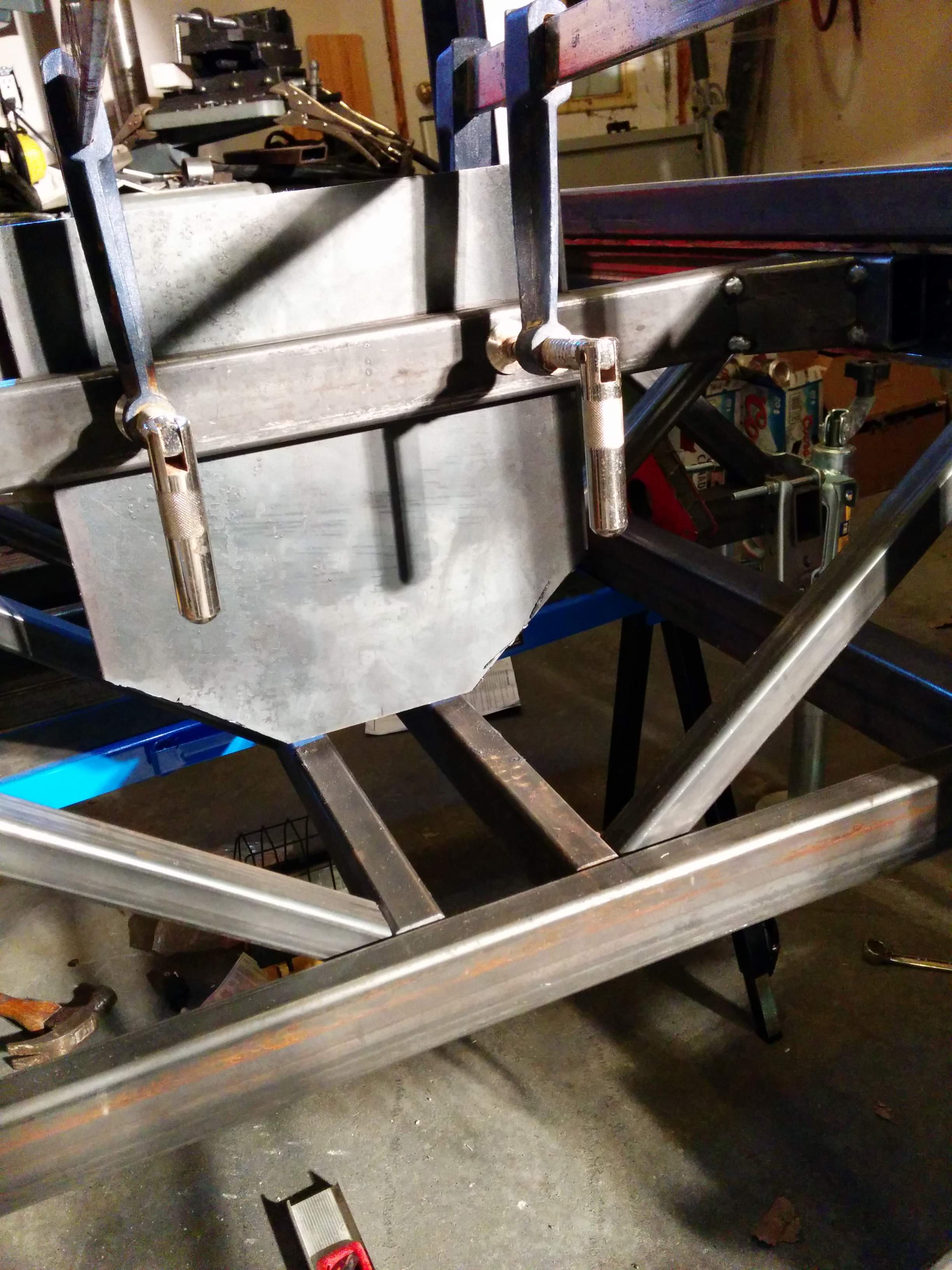

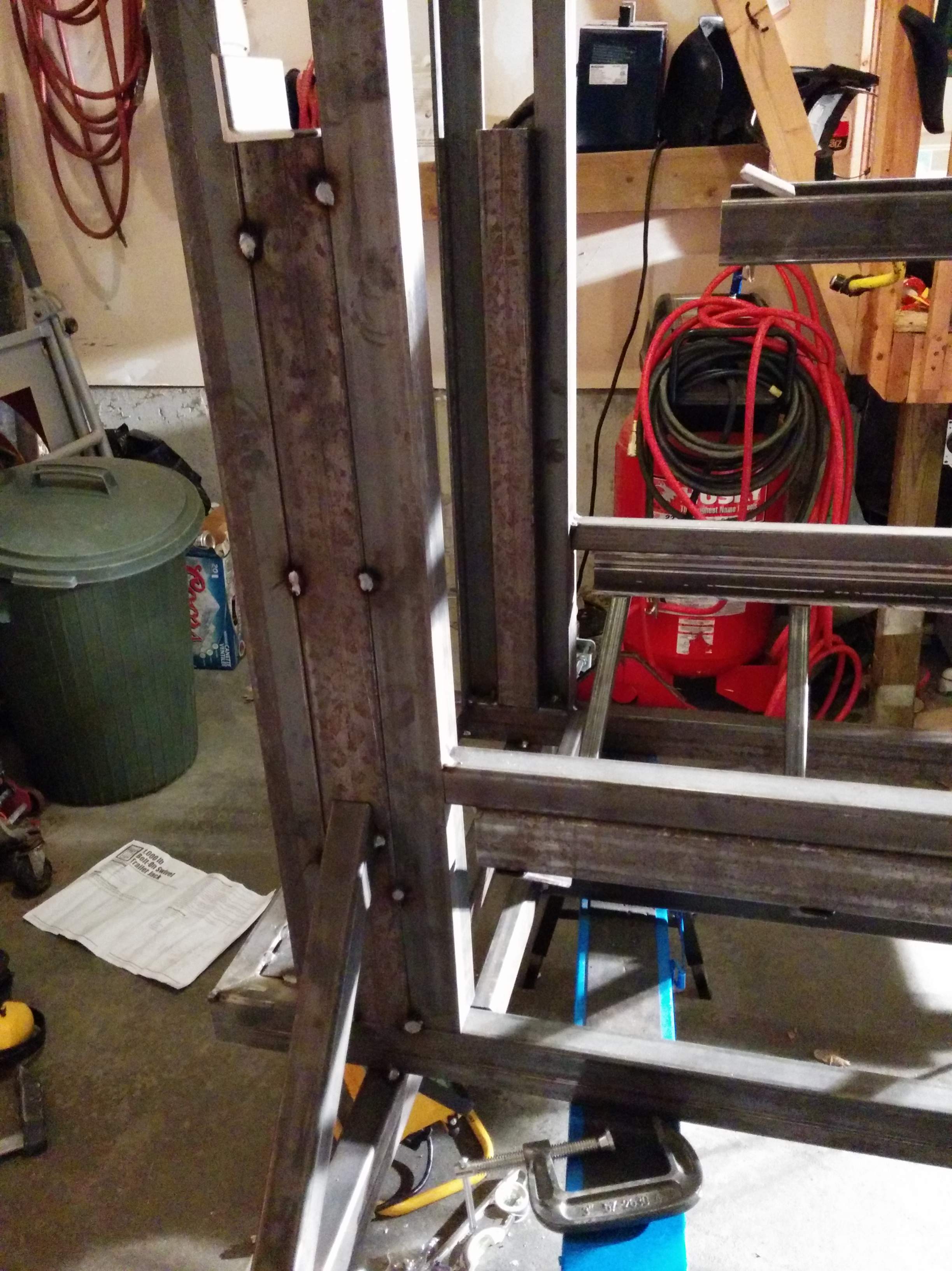

I have never seen a cylinder mounted that way. (2nd pic) Should work providing the tubing is thick enough and the welds hold. The problem with thin tubing is even if the welds hold, the thin metal can rip. If you havent welded it all together yet, I would consider cutting the cylinder support off and adding a piece of thicker flat plate to the top of the tubing, like a fish plate. This would distribute the load over a bigger area and help prevent ripping the mount off the tube. You can then cut the thickness of your flat plate off of your cyl brace and weld the brace to the fish plate. A fish plate would also help tie all those tubing joints together. Some might think these suggestions are over kill, but they aint the ones that will have to repair it if it fails.
/ Firewood processor build thread
#24
When I got to this point I had another "what was I thinking" moment, similar to the angle I bought for the splitter head channel. I think you're right about the wall being too thin and I did consider adding a plate on top of it but decided against it. If I added a plate that was a couple inches wide, it would be welded on both sides, but the centre where the cylinder support is attached would be floating. I don't think my welder will give me enough penetration while welding the cylinder support to secure a fish plate (never heard that term before) to the metal below it. I think that would make it weaker than leaving it as it is. I also worked really hard to get everything aligned and level and adding a plate under the cylinder support would mean starting over. Cutting the cylinder support would be a nightmare, it's an inch thick!
As I said in the description of pic #3 above, more bracing was on the way. Check out the next set of pics to see how I went about (hopefully) making it strong enough with the thin walled tube. I'm likely going to add a cross brace behind the cylinder support.

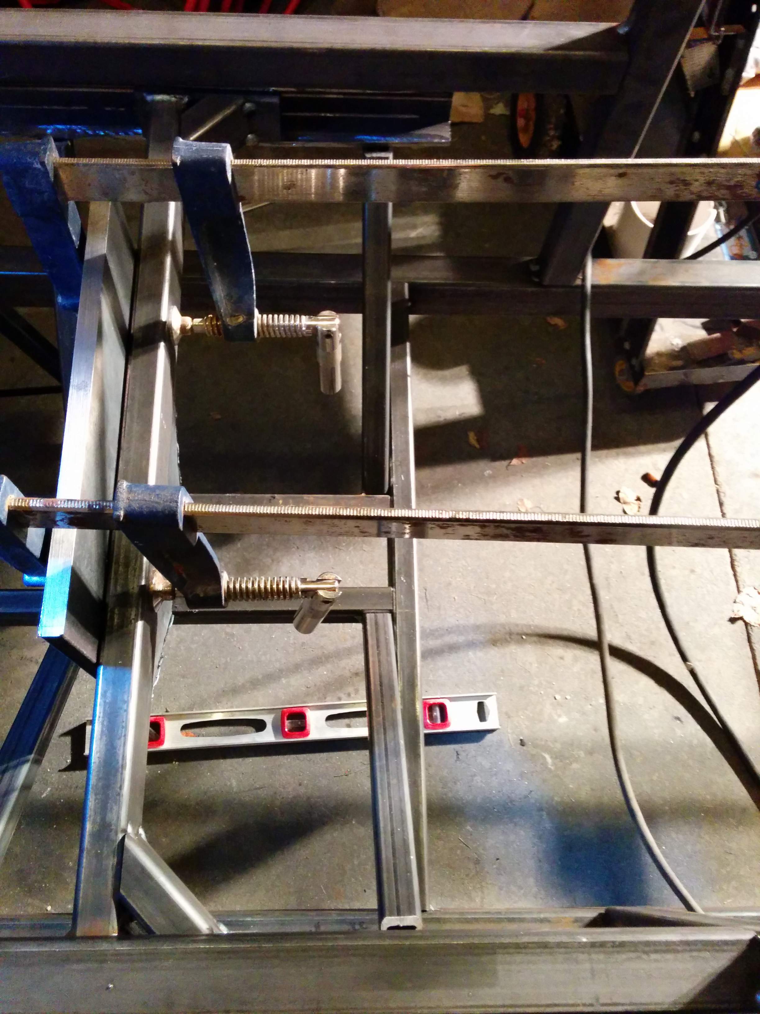

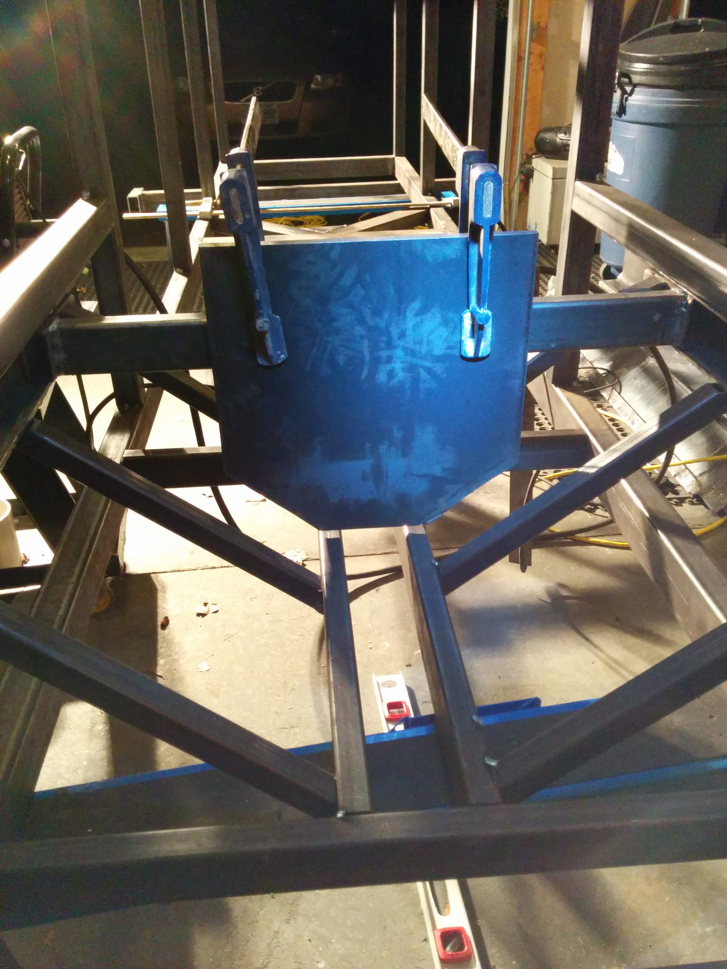

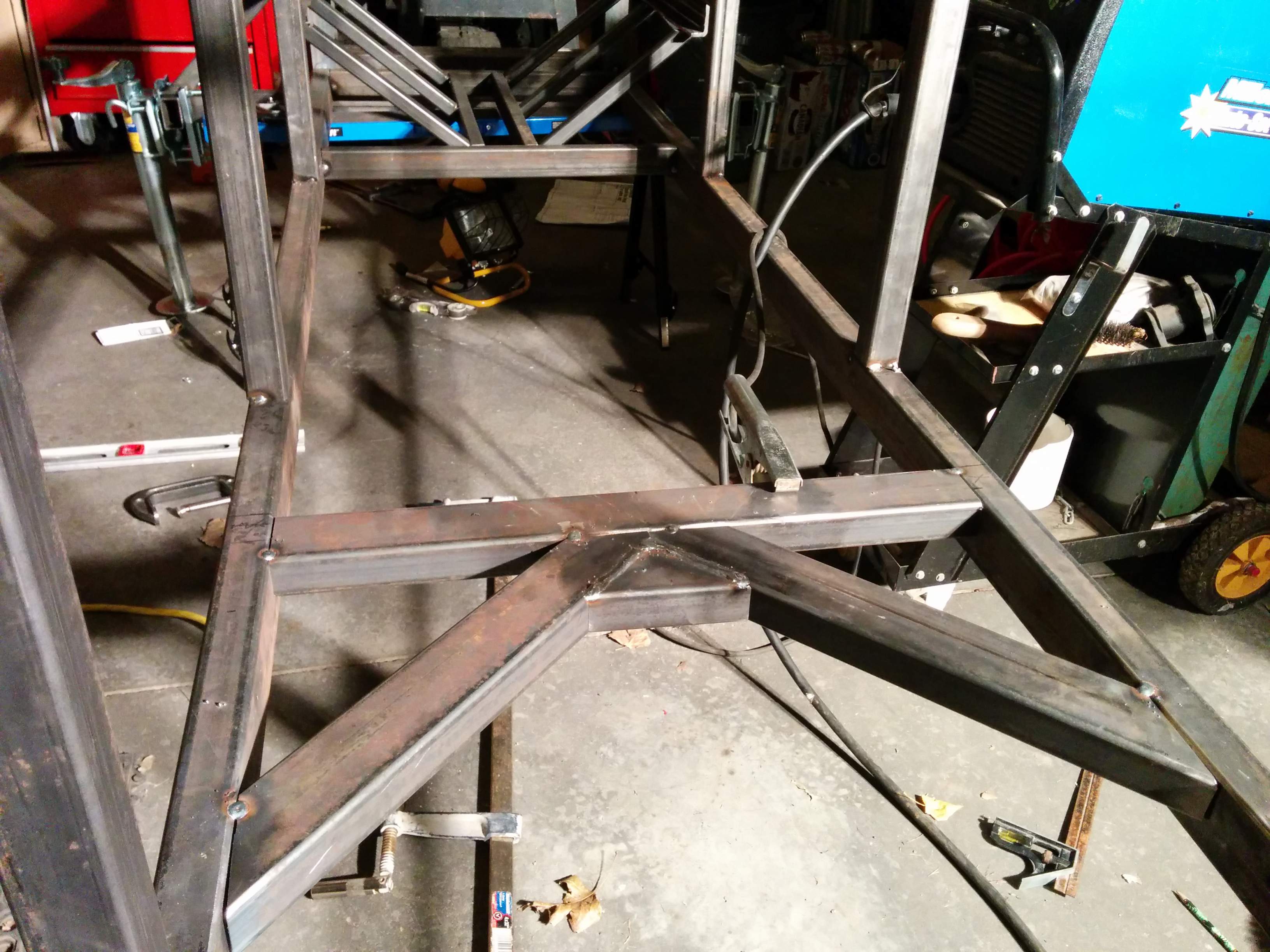

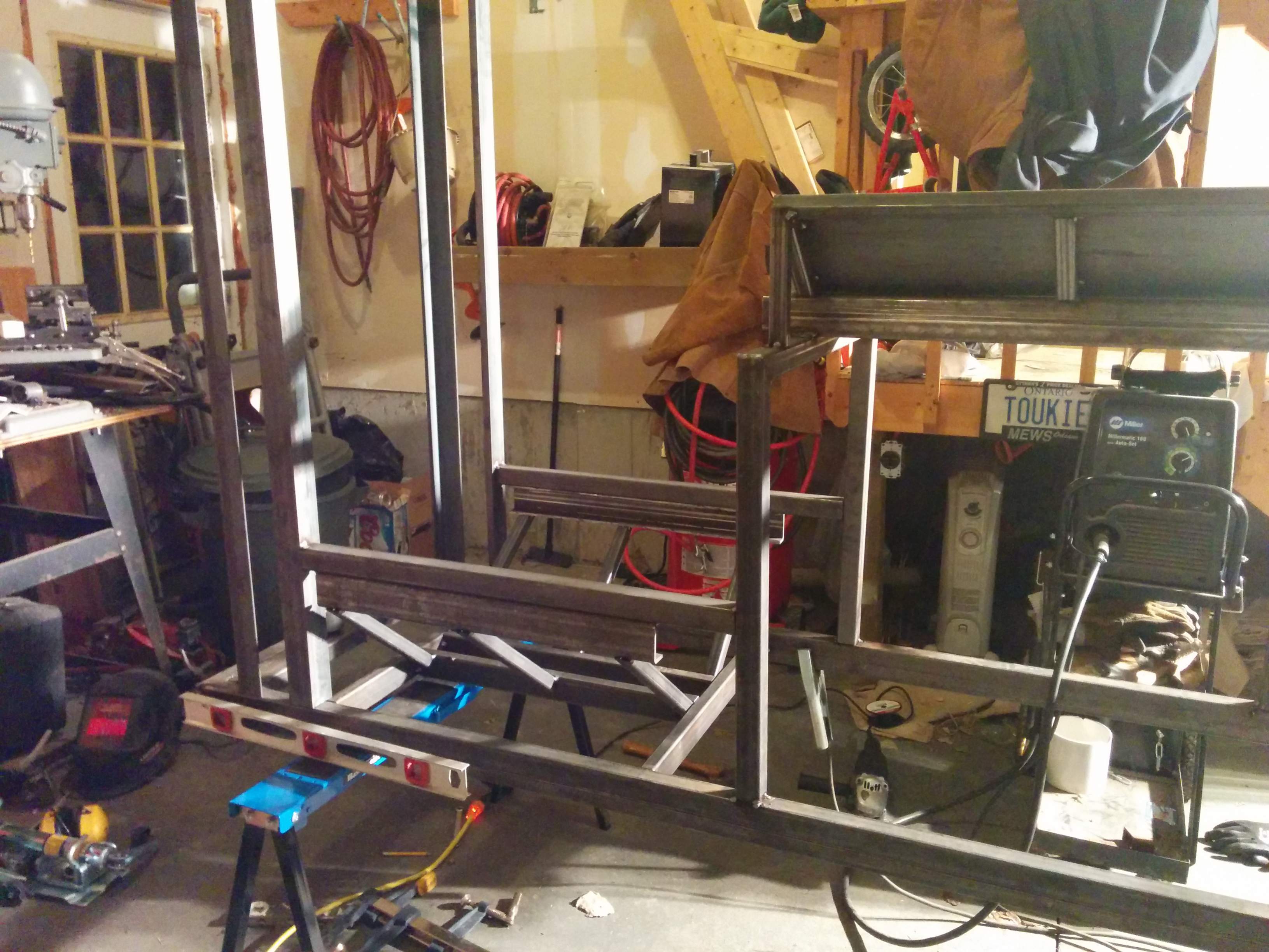

Some more progress on Sunday. I'm getting most of it put together now, just the deck (which won't be live, at least not this year), engine and hydraulic tank mounts and some fiddly pieces to make sure water can't get in anywhere. Then of course, a ton of cleaning and welding since it's mostly just tacked together right now.
Bottom trough in place.
More bracing in place for the ram. A cross brace behind the cylinder support is on the way and probably one to connect the two sides of the processors frame.
Channel for the splitter head. More bracing will be used to make sure the ram doesn't simply push it over!
The much talked about angle making up the rear of the splitter head channel is now re-enforced. Sorry for the poor pic. The splitter head will be pushed against the processors frame on the bottom and all along each side of this angle. I think it's enough, time will tell.
I'll be stopping by a local welding shop tonight. Hopefully having them do the splitter head won't be outrageously expensive, I really don't want to do it.
