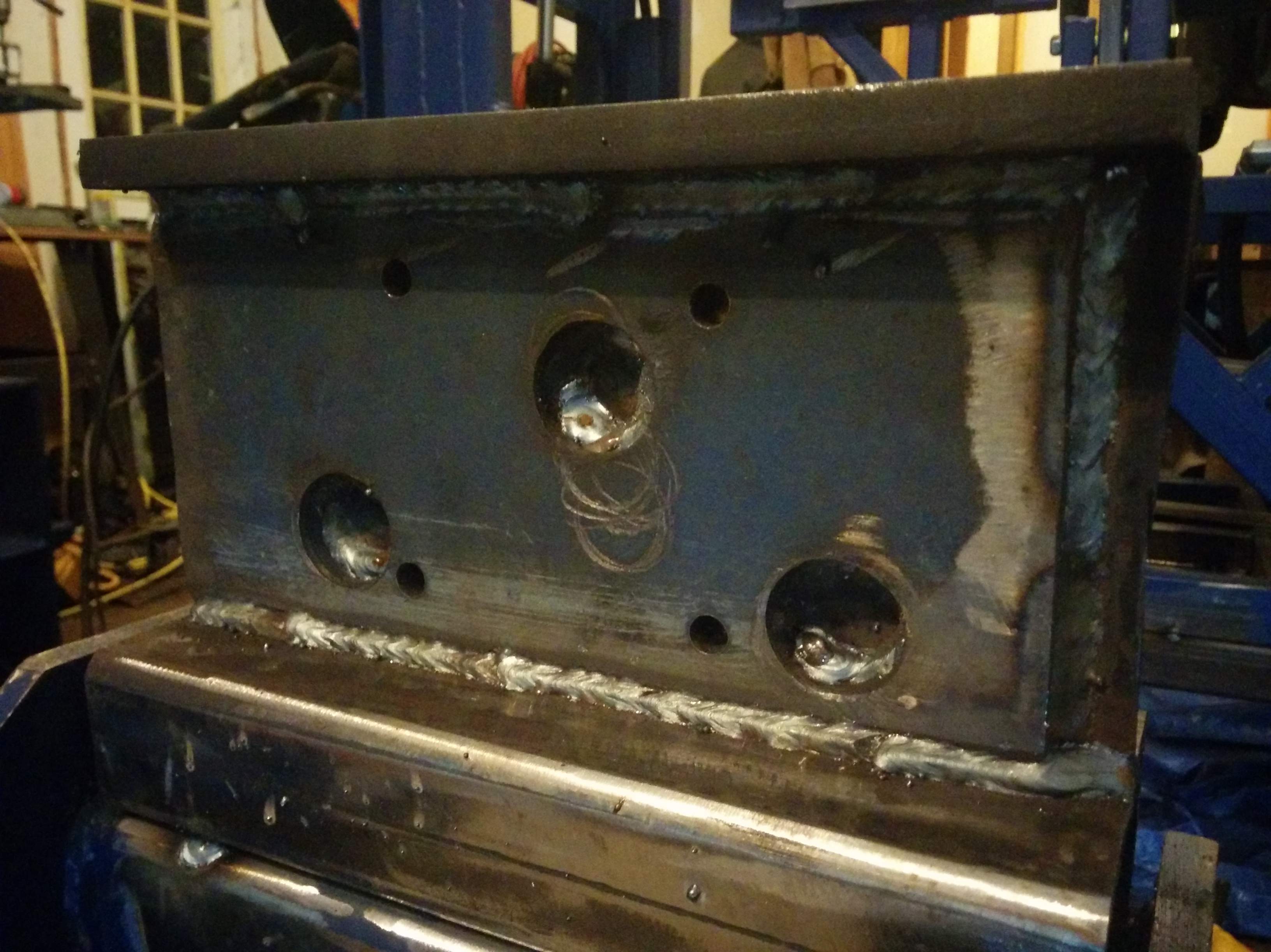

As you can see in the last pics, they didn't walk around, they ran around. I normally have them in my drill press vice and just start very slowly, for those holes I was just holding the plate by hand and not really putting much effort into getting a precise spot. You can do it with almost no walking if you're really careful and it's clamped down very well. I don't generally use a pilot bit in the Mandrell when using my press.

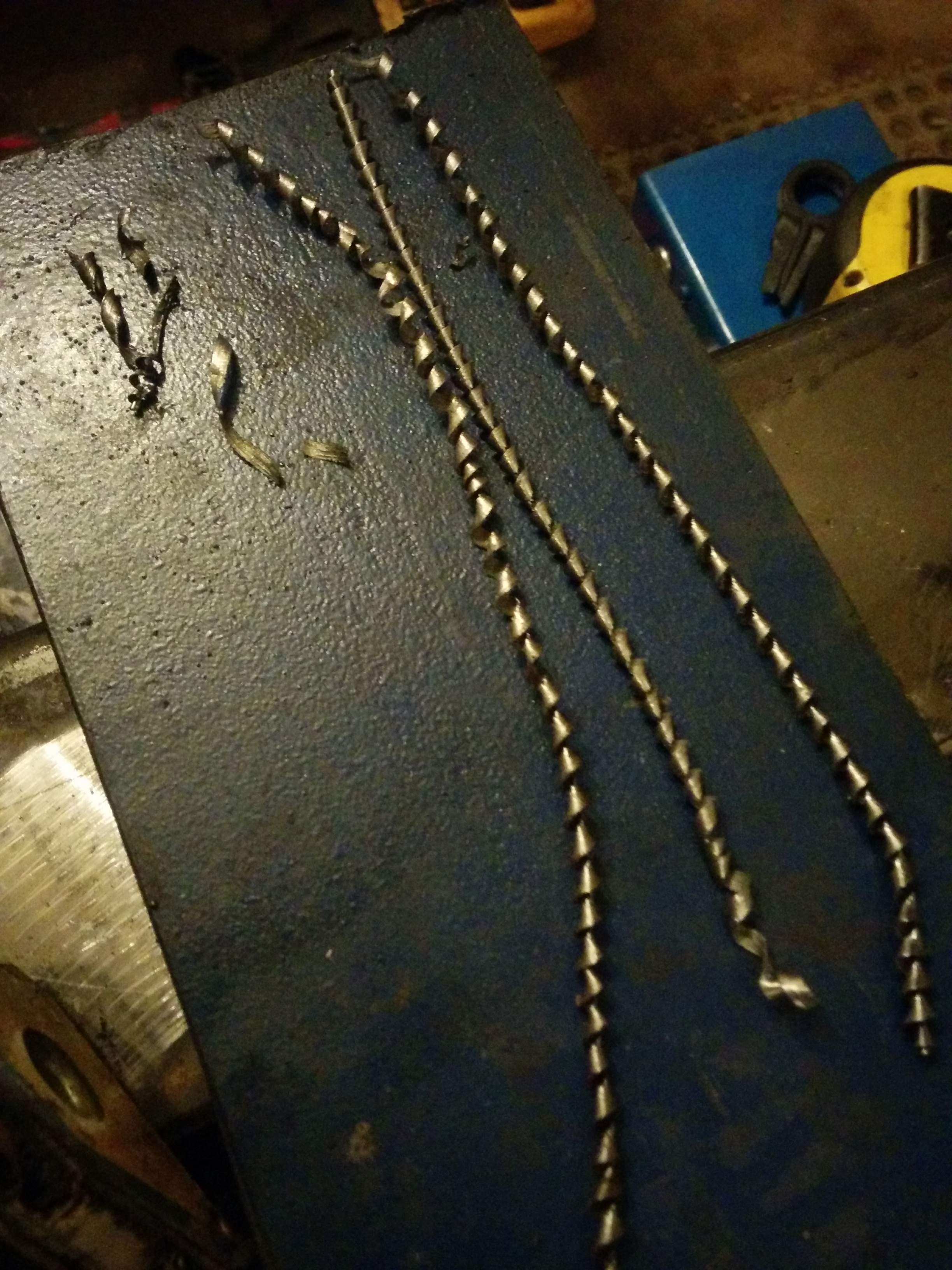

I always start with cutting oil and very lightly touch the hole saw to the material. The oil lubricates the cut and probably helps keep it from biting too hard. You may want to look at your drill press, it shouldn't allow any movement.
Here's the oil I'm using
I can always tell when I need to stop and add a couple drops of oil, the shavings change. With oil, I get a long, tightly wound shaving, when the oil is gone, the savings are much shorter, flakier and don't curl very much.
With a hole saw, there's a pronounced difference when the oil runs out. With oil, it's just a smooth, constant light pressure and you can feel it cut nicely into the material. When it needs more, it doesn't cut nearly as quickly and you find yourself adding more pressure.

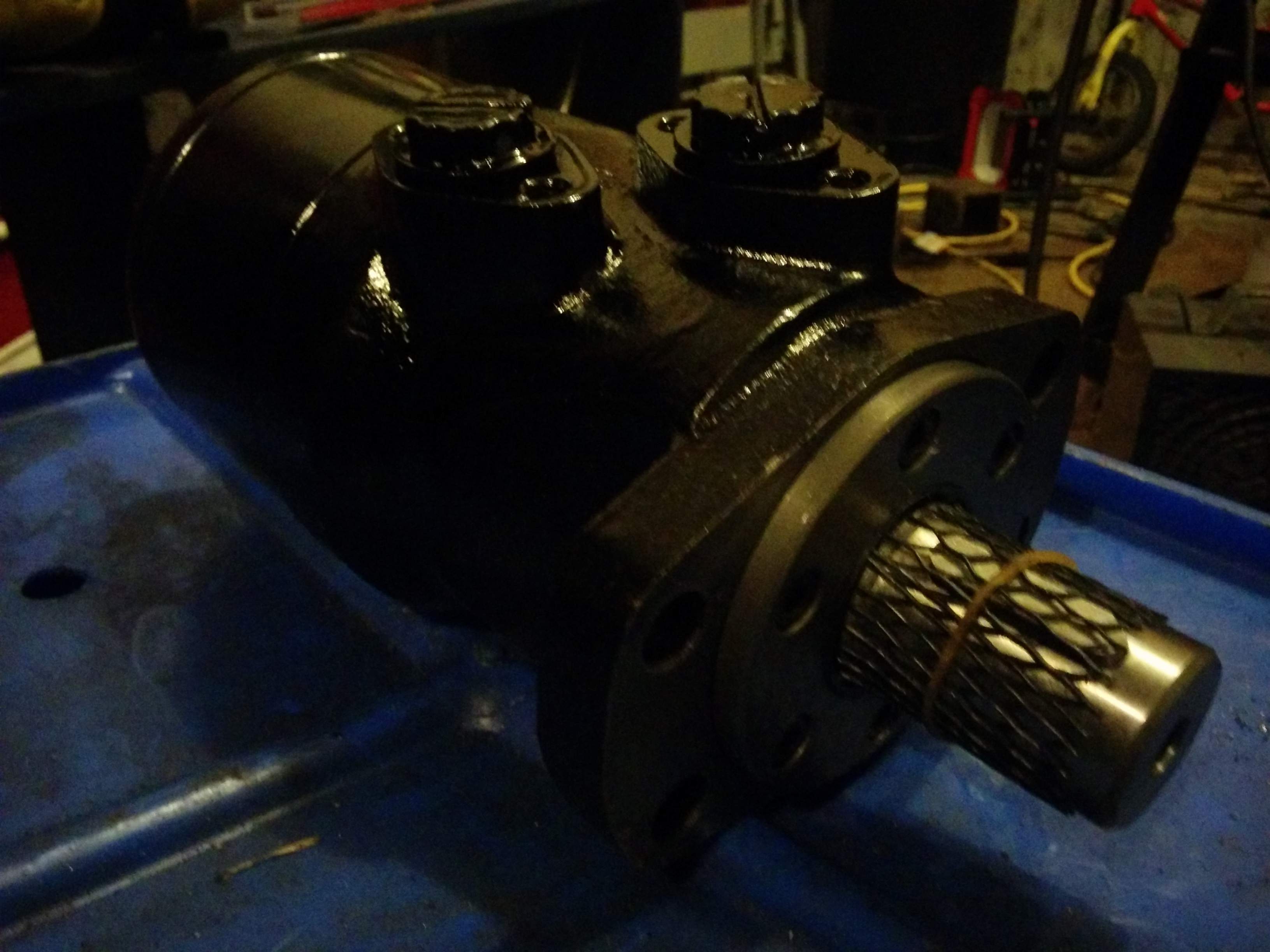

Picked up the motor on the way home from work yesterday. We when through so many options, I can't even remember exactly what the specs of this one are, but it's a larger displacement and will take a higher pressure and greater flow. It was a more expensive motor because of that, but allowed me to eliminate having to add a flow regulator and and pressure regulator. In the end, it cost about the same but it's a much stronger, slower turning motor.
So, what takes longer than drilling?... Grinding! Oh man, that sucked last night. I cleaned up the two 1/2" remenants from the splitter head frame, ground a groove in the 4 edges for welding, got some more holes drilled through them and got the whole mess welded together.
My final act of the night was to butcher the extension on the pusher plate. I don't have enough light in the garage and didn't manage to follow the lines I drew perfectly. Oh well, I'll weld a cap on it and no one will be the wiser. Oh wait, I just told everybody...

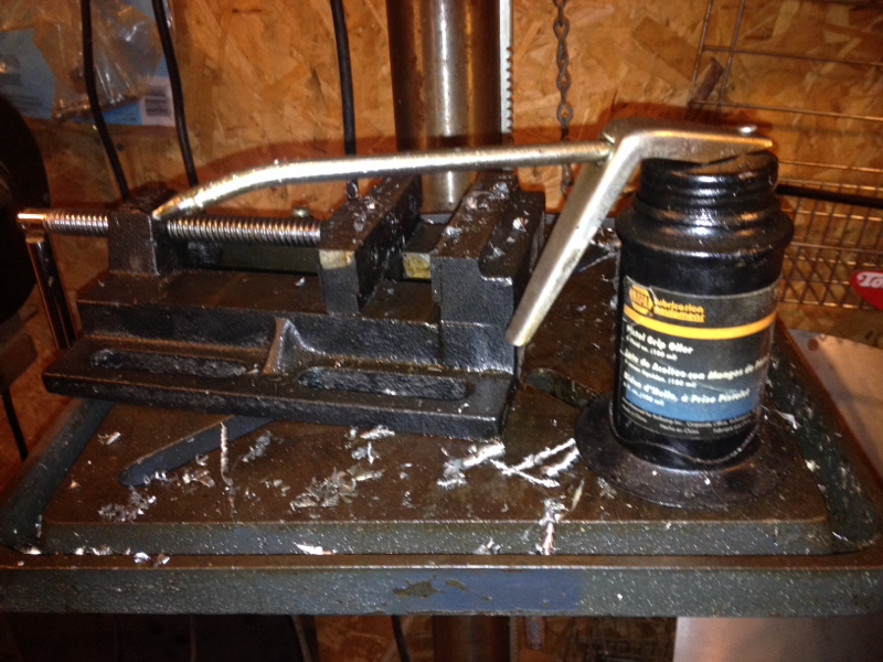

I use a NAPA brand cutting oil that my local store caries. But then place it in a little oil squirt can, pictured below, that makes it easy to dispense.
