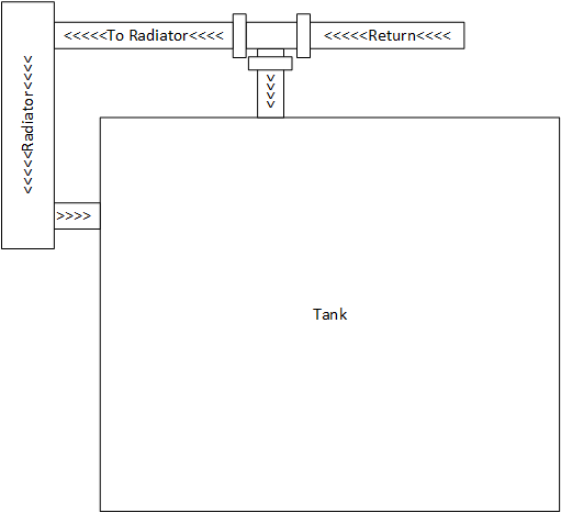

I have forgotten what you said your hydraulic temperature got up to. But over the weekend while I was running the decaker I thought I'd shoot the resivore with my temperature gun. It showed over 150*. If yours was much warmer maybe you done need the cooler. This system runs on aw-68. I don't remember what oil your running either. Might get away with an oil change instead of cooler mods.
/ Firewood processor build thread #412
A transmission cooler could work very well or even a regular car radiator for that matter. Although the car radiator would be a little harder to plumb up. In a hydraulic system you could see pressure spikes of 300 psi or more so you would have to run the cooler parallel to the system. Add a couple bungs on each end of the tank one for in and one for the out fluid. You should be able to find some kind of small 12V fluid pump......heck, a regular electric fuel pump would probably work to circulate the fluid. Then go to an auto junk yard and pick up one of those electric radiator cooling fans. You could probably get the radiator, the fan unit along with the control unit for under a hunnard bucks.
The tank is going to be vented so I don't think you would have an issue with to much pressure for a tranny cooler or even a regular radiator for that matter. Trying to plum a radiator would be a little harder but you have to remember most radiators now have transmission coolers inside the tank so you could just plum to that but I guess you would still need to circulate cooling water through the radiator to cool that cooler. In that case you would have to come up with a small 12V pump to circulate some water through the radiator but it should work. That's all a fancy hydraulic cooler is anyway.

The issue is that most liquid pumps aren't setup to handle 150-250 degree fluids, or they are low enough flow that they wont push enough liquid.
Hence my suggestion earlier to tee into the return to allow a place for any excess pressure to be dumped. If there was a restrictor (so the radiator side of the tee was a little smaller than the tank side) it would reduce the flow further, but if you go from 3/4" or 1" to 1.25", it will drop pressure right there.

I'm not exactly sure where Ken is on this a the moment but I've been following the the whole thing closely as he lives around the corner from me and I'm hoping to build one this summer.
With all the recent focus on cooling options, it's definitely something I'll keep in mind with mine but cooling is a secondary problem. He was given bad advice during his design process and ended up using a 10 gal oil capacity with a 28 GPM pump. No way around it, that just ain't gonna cut it. Once the oil capacity is up to where it should be, there is a good chance that in it self will solve both fluid temp issues as well as his hyd quirks.
Considering mostly winter use, running water of any sort as a cooling agent isn't much of an option but could be viable as a bandaid for occasional summer use
