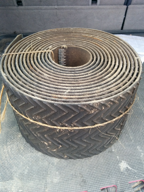

I had a very successful day. I picked up the belt. Its got a chevron pattern but not enough of one to carry the wood without some help. I'll start designing something now and have it done this week if all works out.

I don't see why that conveyer belt material would have any trouble moving wood as is. On our sawmill we have used smooth belting to move cut off wood and slabs for years.

I'm guessing the belting will work fine as long as you don't have it on too steep of an incline.
