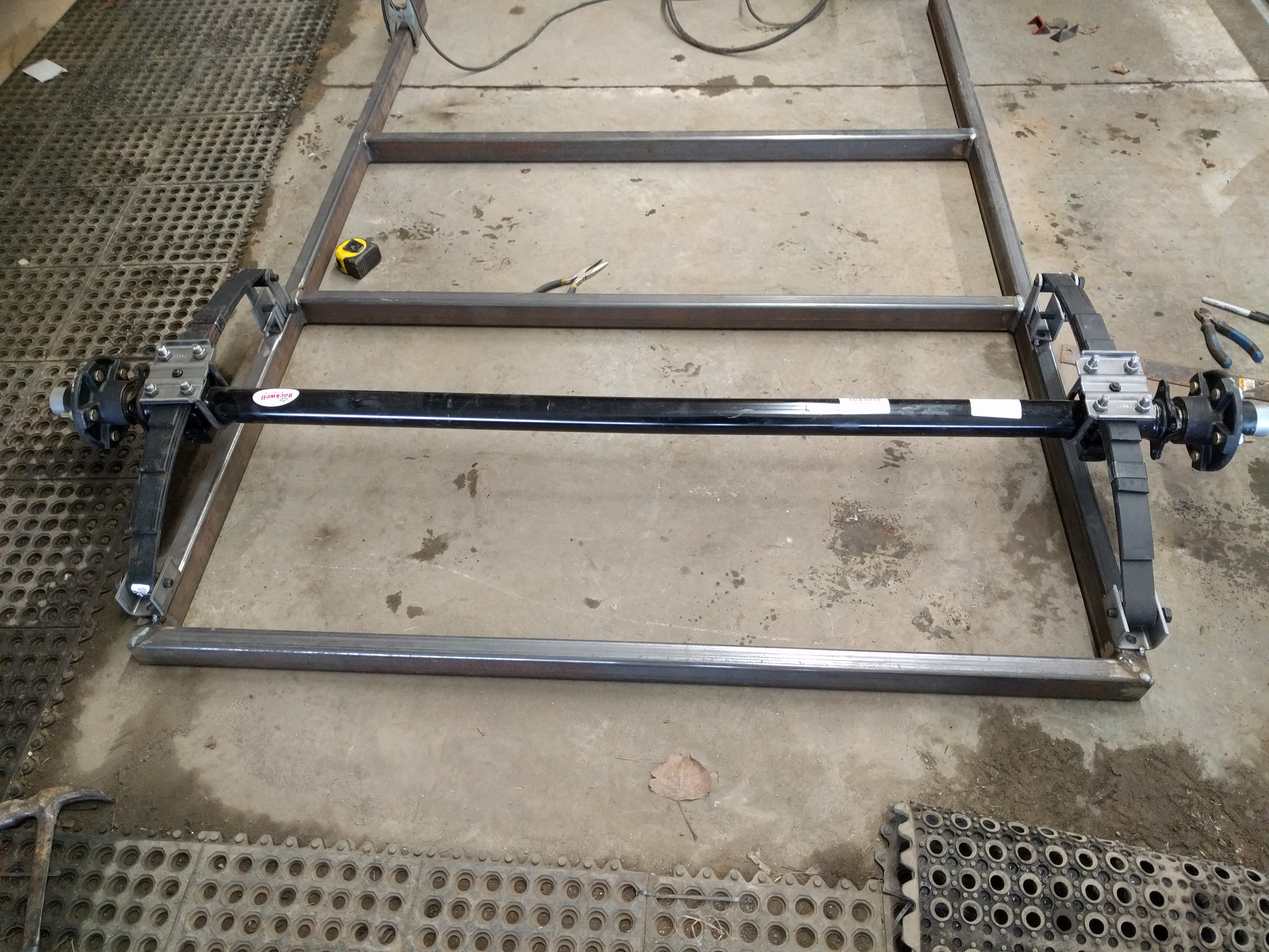

Well, here we go again...

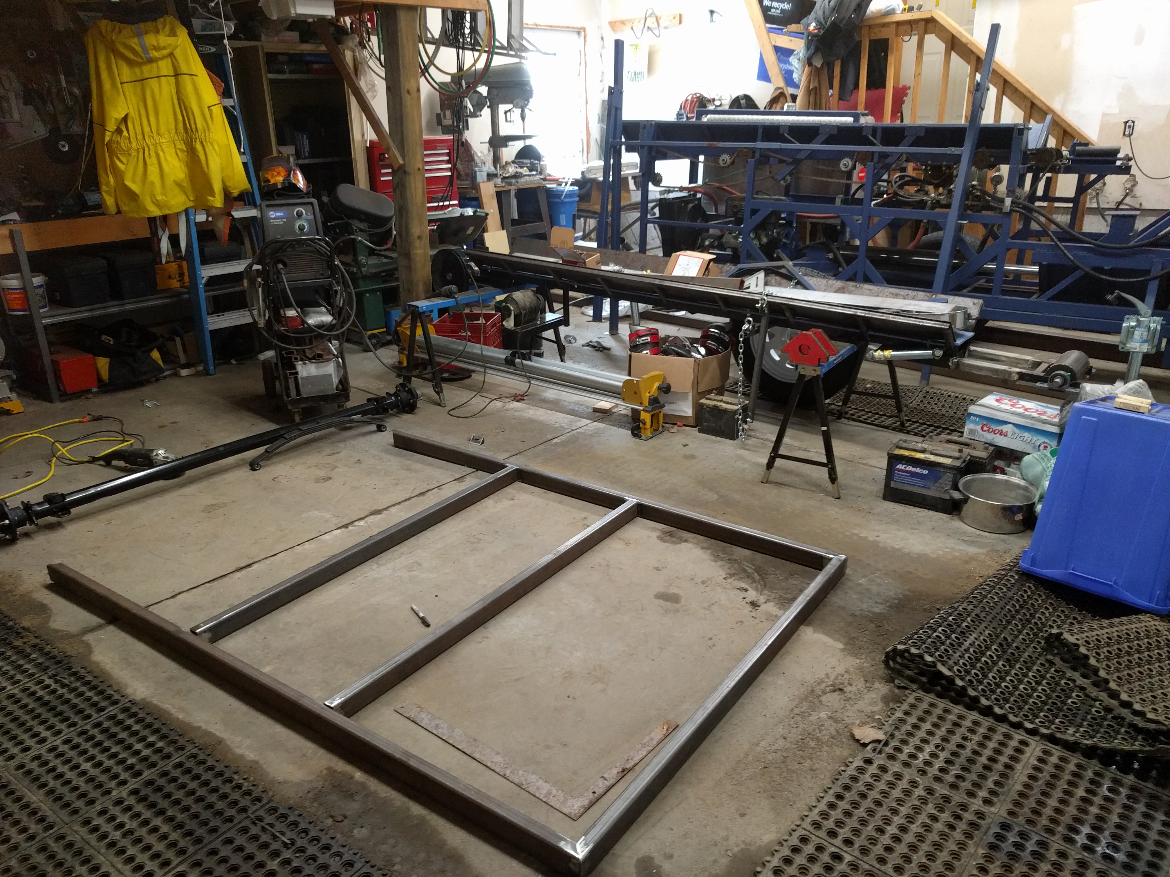

It's time to do a few upgrades to the processor. It ended up being a lot heavier than I had expected and my tractor struggles to lift it. In fact, My DK 45 can only lift it about 18" high and even with the tractor properly ballasted, the front tires go nearly flat. Moving it from the back of my property were I store it to the area I process wood behind my house is downright scary. So, my first upgrade is to put an axle under it.
When I started buying logs, my supplier delivered them in 8' lengths. He has now changed to delivering them in 16' lengths. So the second upgrade is to extend to the processor to be able to handle full 16' lengths. I'll do this by adding a support to the front of the tongue of the new trailer. I'm building the tongue out of 3" x 4" - 3/16, so it should be plenty strong enough to support a support for the end of the log as well as another arm for my log deck.
I also ditched my little manual log clamp arm. I'm adding a hydraulic clamp. For the most part, a clamp hasn't been needed until you get down to the last cut or two of the log but I couldn't put enough force on my manual clamp and I'm only using 2 out of the 3 spool valve that's on the processor anyway.
The wood conveyor will also be completed this year. It's been sitting in my garage 80% complete since last year. So far, I've added springs to the self tensioning system but I haven't put it all together quite yet.
Finally, my plan WAS to redo the hydraulic return lines and move my hydraulic valves. I think the lines may be causing some of my heating issues and they are destined to fail in the coming years anyway so I was going to run larger, solid lines. The new trailer being built under the processor will be in the way when I'm operating the processor so I was going to move the valves as well. We'll see how it goes, this may or may not happen this year.
Frame for the new trailer. Built out of 1.5" x 3" - 3/16" tube

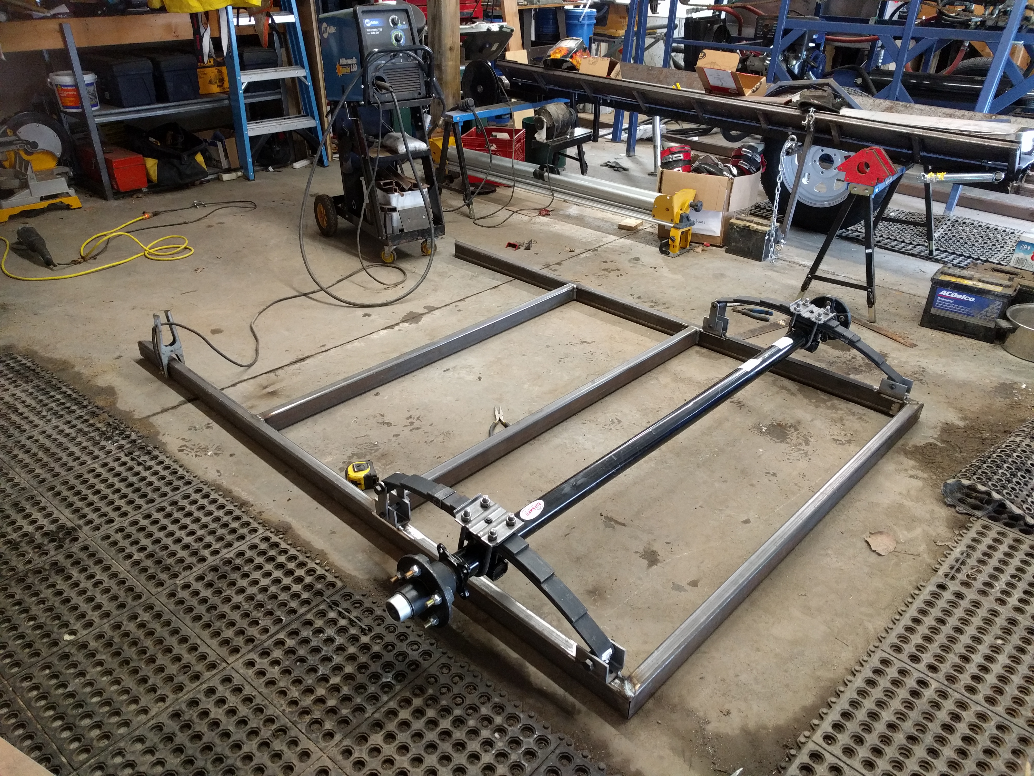

Dry fitting it all together before putting it under the processor

Looks like it will work quite well. When you install the trailer you can balance it out just like you want it. Way easier than making the trailer part first then having to install things afterwards and doing the balancing act (10% to 20% weight forward) to make it tow eaisly.

Archertwo, you're right, that would be a good way to get the balance right but in my case, I put the axle as far back as I possibly could without interfering with the operation of the processor. It's also about 100X harder to build a trailer this way, I don't recommend it!

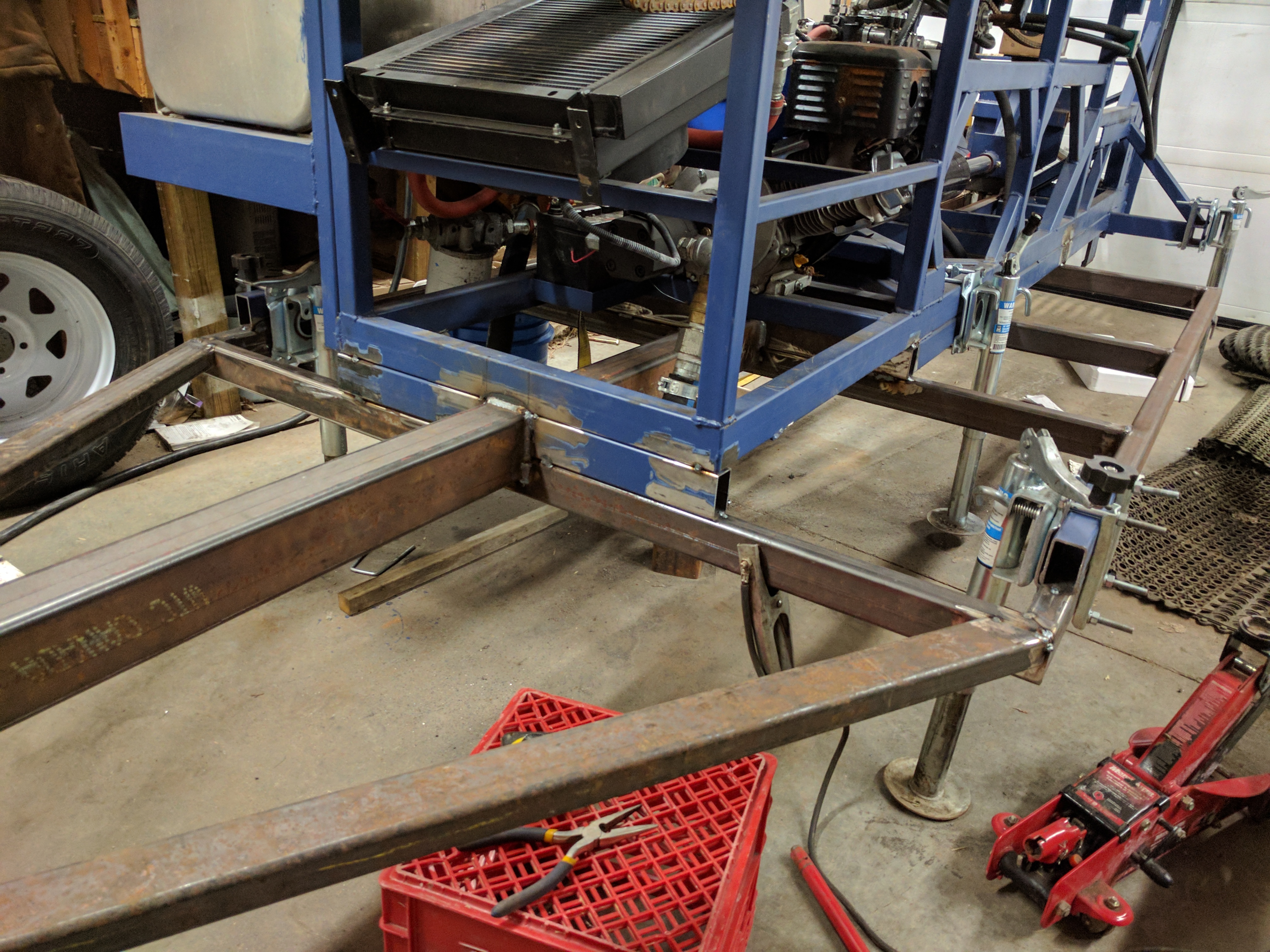

Here are some pics from last week. So far, most of it is just tacked in place. Unfortunately, I'm getting flashed a lot from my auto darkening helmet and many times, half way through a weld, the tinting gets too light and the arc is to bright. Until I can get out to buy a new helmet, I'll be mostly tacking things in place.
I welded the trailer frame I built to the bottom of the processor. Then I completed the frame and added the tongue. I couldn't do this earlier because I needed to be able to sneak the new trailer frame under the legs of the processor.

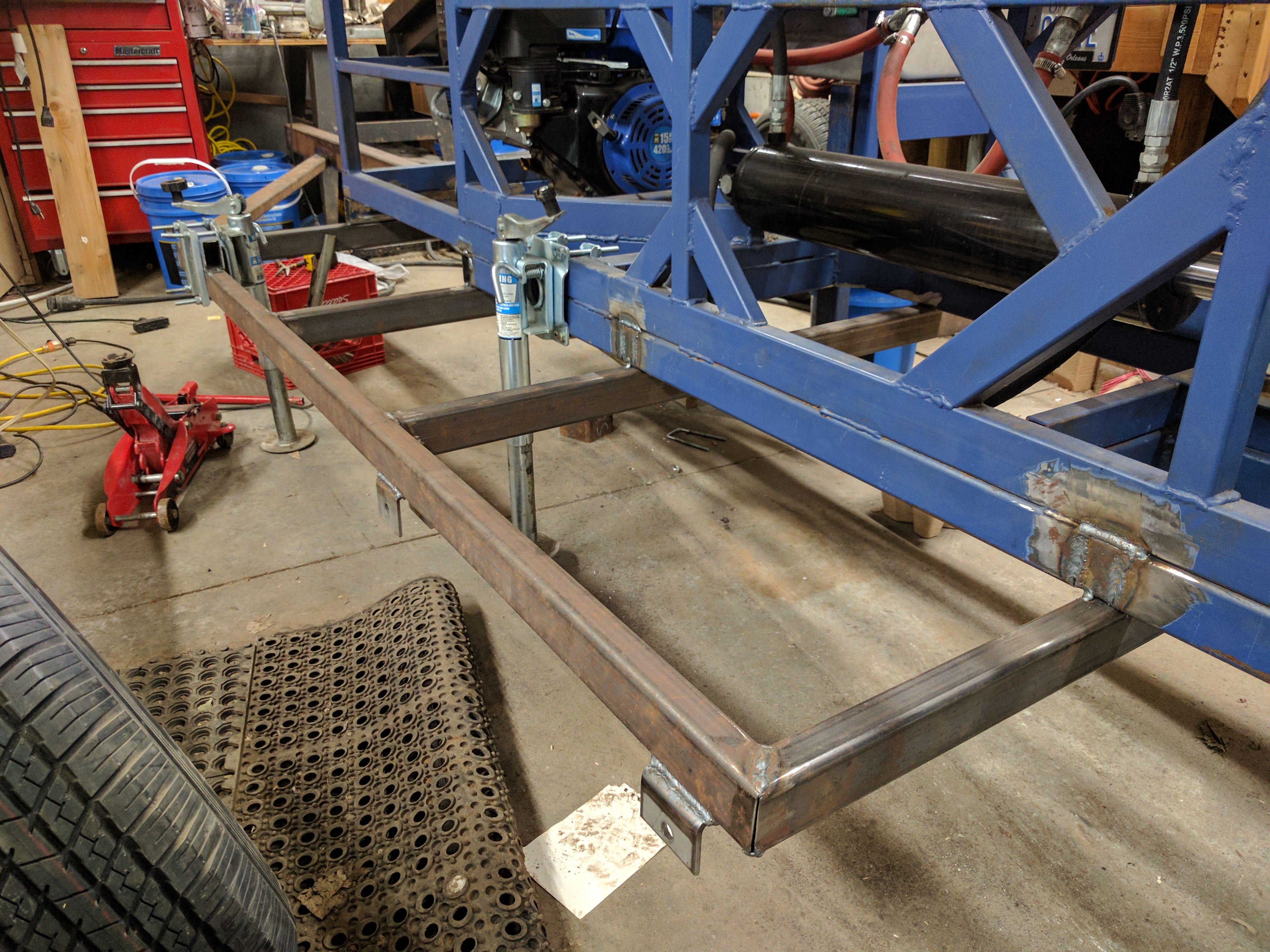

The new frame in place.
Front of the processor re-enforced and the tongue in place. I also moved the two front legs to the edges of the trailer frame. I'll move one more leg to the front of the tongue.

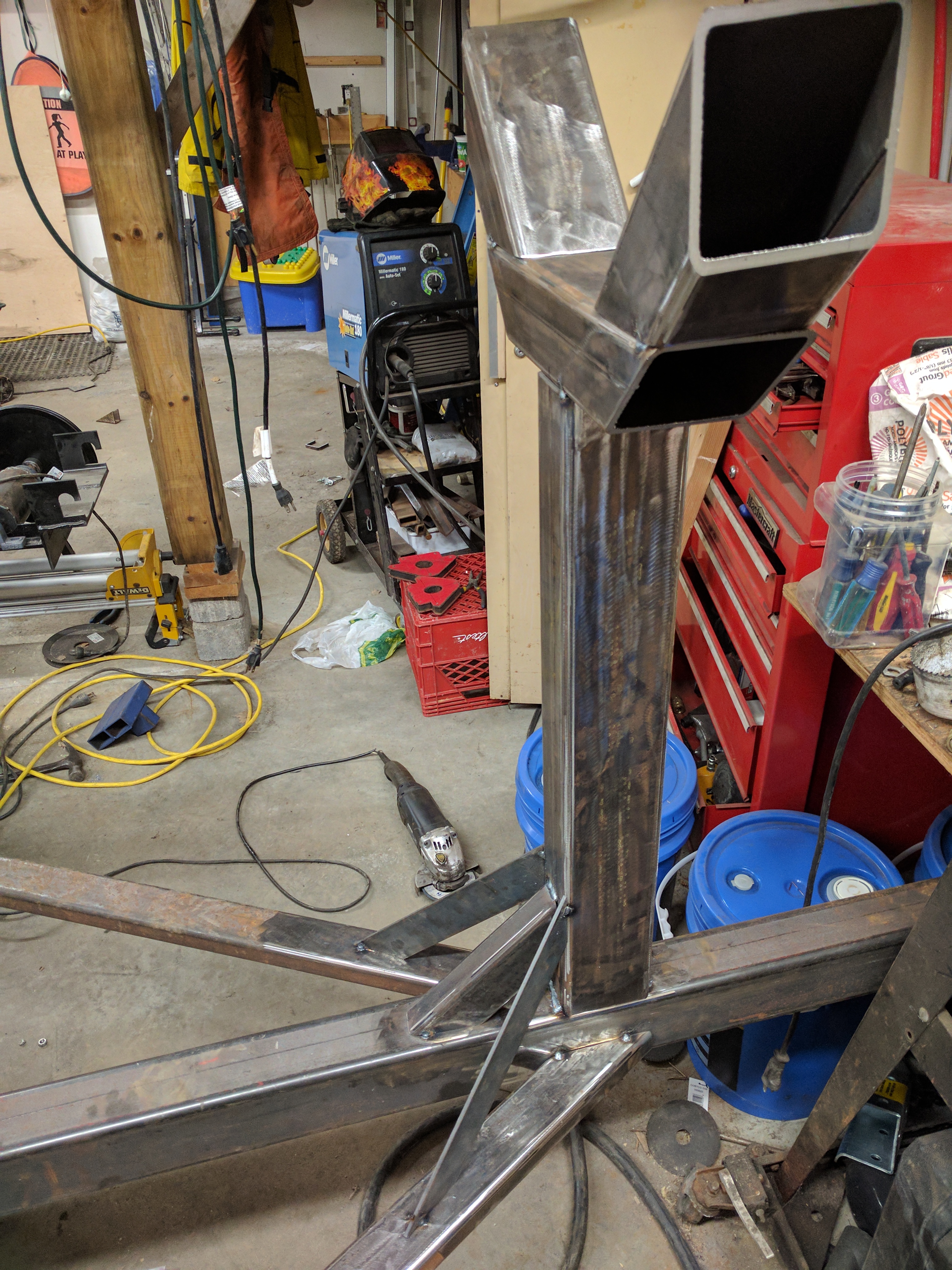

One of my main motivations for this upgrade was to be able to process 16' logs. The logger I've used for years switched from 8' to 16' last year and I had to cut the last bunch in half. To do this, I added an extra long tongue and a stand to support the end of the log.
For now, I'm going to try this cradle approach to hold the log. I will be adding a 3rd support to my log deck that will attach to this cradle. I'm hoping the drive system I built will be able to feed the 16' logs but if not, next year, I'll have to add one more drive wheel all the way out on the cradle.

kiotiken, you might want to add a roller to your cradle. Unless you wood is super smooth or you have no knots, which is impossible since these are trees you will be processing, you will be making your drive system working harder than it has to and putting undue strain on the cradle if it a log binds up. Even if it's not powered a roller will let the wood "slide" better.

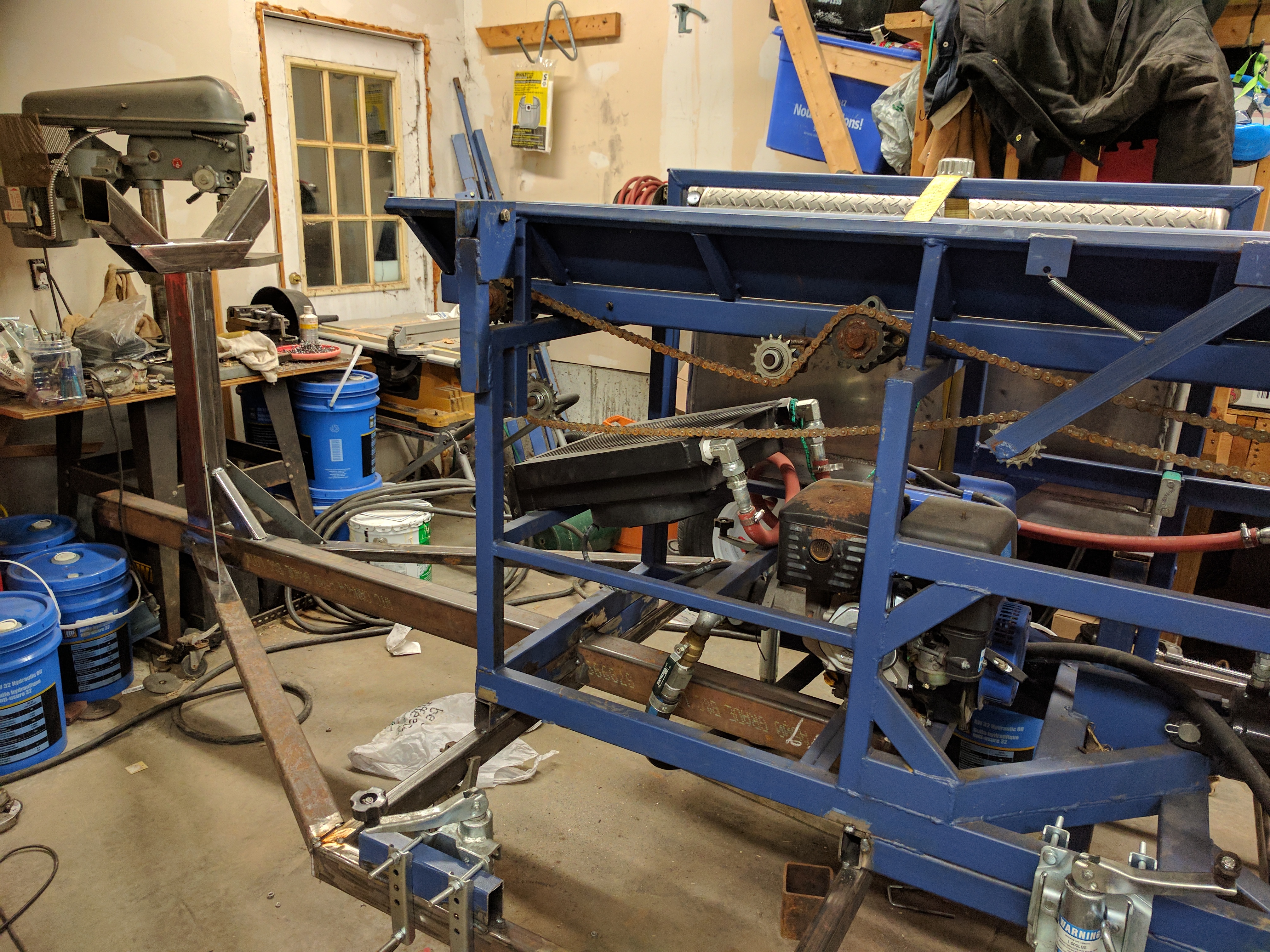

The processor has been modified repeatedly over the years and needs more work right now. Here's an update on what it looks like now...
