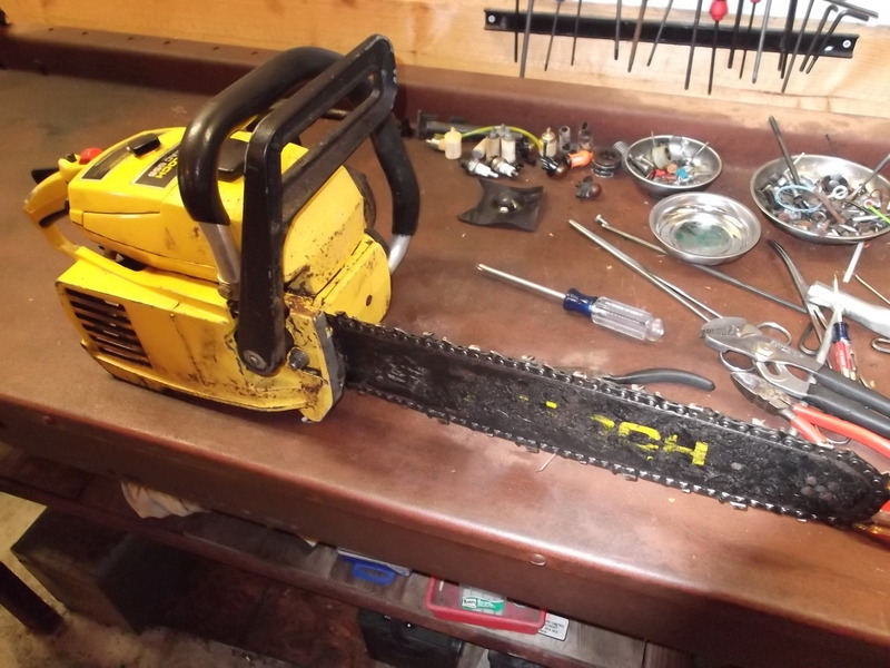

Just in from "the saw bench" , perking up the 10-10s
It's in pretty good shape, but hasn't really been run in a couple of years. I did buy it new, and have only dropped a few trees on it ;-).
Dirty though! I can't imagine "people" putting a saw away so filty with sawdust, bar oil, and exhaust grime!
It's much better now ;-)
But, an interesting observation... even though the muffler fasteners were snugged up fine, with the locking tabs still bent over, there is no gasket at the port flange!. They are not spendy to purchase, but considering how simple a part, I'll just make one out of some sheet copper I've got kicking around.
Both fuel and oil tanks were empty, but still "wet" inside. the fuel tank was sloshed out and the pickup filter given a bath. Fuel hose still flexes. But I must have bent the throttle connector rod, because there is not enough room to get my finger under the trigger after it has been released. I should pull the carb anyway, just for a look.
I should pull the clutch and grease the roller bearing, but the nut is tight. I may be happy just to oil it.
This post might better go in the "another junk chainsaw" thread, as I'm just rambling.
A pleasant rainy afternoon in the shop!
