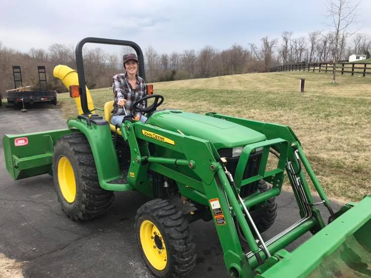

Hi all, I've been a member here for a bit, bought my first compact tractor with recommendations from the site (2010 John Deere 3032E) which I bought new from Mutton Power due to a tip here. That machine held it's value unbelievably well, and I sold it last weekend, after purchasing a 2105 ToolCat to handle my finish mowing and snow blowing requirements from the comfort of a AC and heated cab.

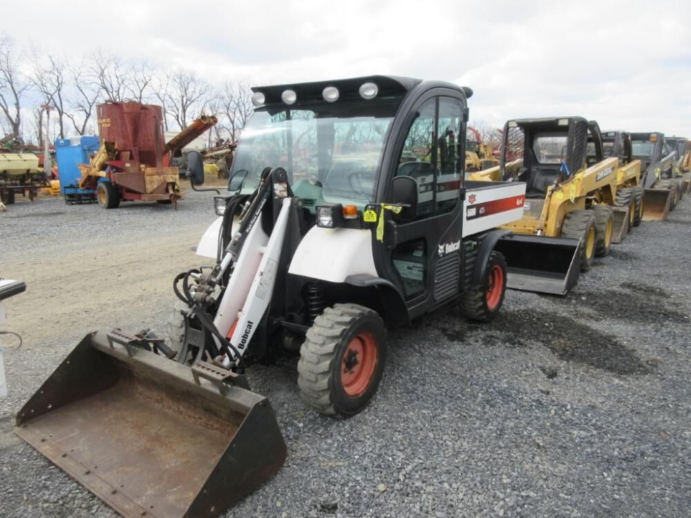

I bought it at auction up in PA last week, it's a 2015 unit, and I believe it was from a campus environment. It is equipped with the high flow option, driving lights, traction control, keyless start, power bobtach, and a few other things I'm figuring out still I think. All and all it's a much quieter unit thanks to the Doosan engine I suppose, than a 2010 I had tried out a few weeks back, and I think I'll be relatively happy with it. the only down side is a little bit of surface corrosion under the bed, as I think this unit must have spent most of it's days doing snow blowing and salt spreading. There's no salt spreading in it's future, so I'll be spending the next few weekends with a wire brush, primer, and the proper Bobcat paint to get it all under control.
I've been reading everything I can find here on the forums, and I'll post more about how my ownership experience goes over the next few months.
Auction photo:
Last day of ownership of the 3032E and my wife, who learned to operate a tractor on it. She's somewhat upset that the Bobcat isn't a nice green color....

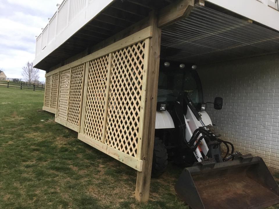

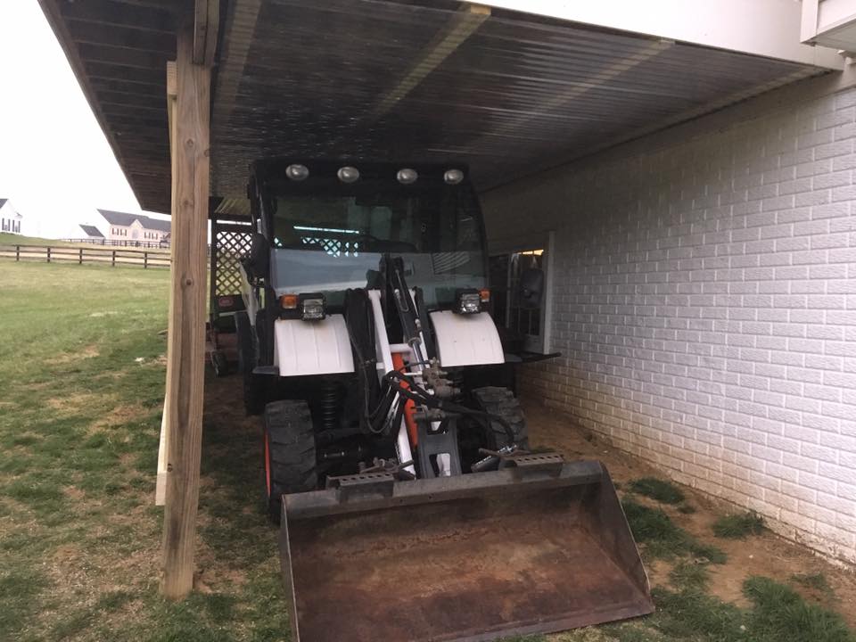

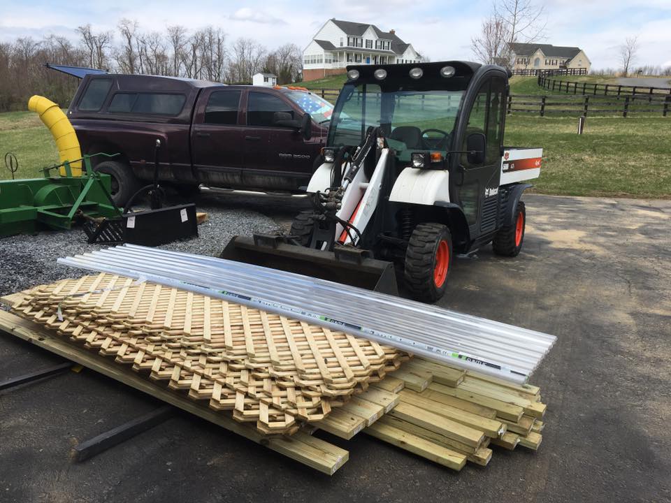

The ToolCat has a new home. Found a nice guide on line in how to build an under deck storage location. We screened it in a bit as well. Need to move some more things around in there to make it all fit nicely, bu basically it's the ToolCat, the 3-pt PTO adapter and the 90" finish mower attached for the season, and then the snowblower. I need to slide the snowblower back a bit further. Also planning to dig it out a little bit more and level it nicely so there's more vertical height available etc. The ToolCat easily lifted all of the construction materials off the trailer and carried it to the back yard.
/ First Post - 2015 5600 Toolcat #6
Worked out great :thumbsup:.

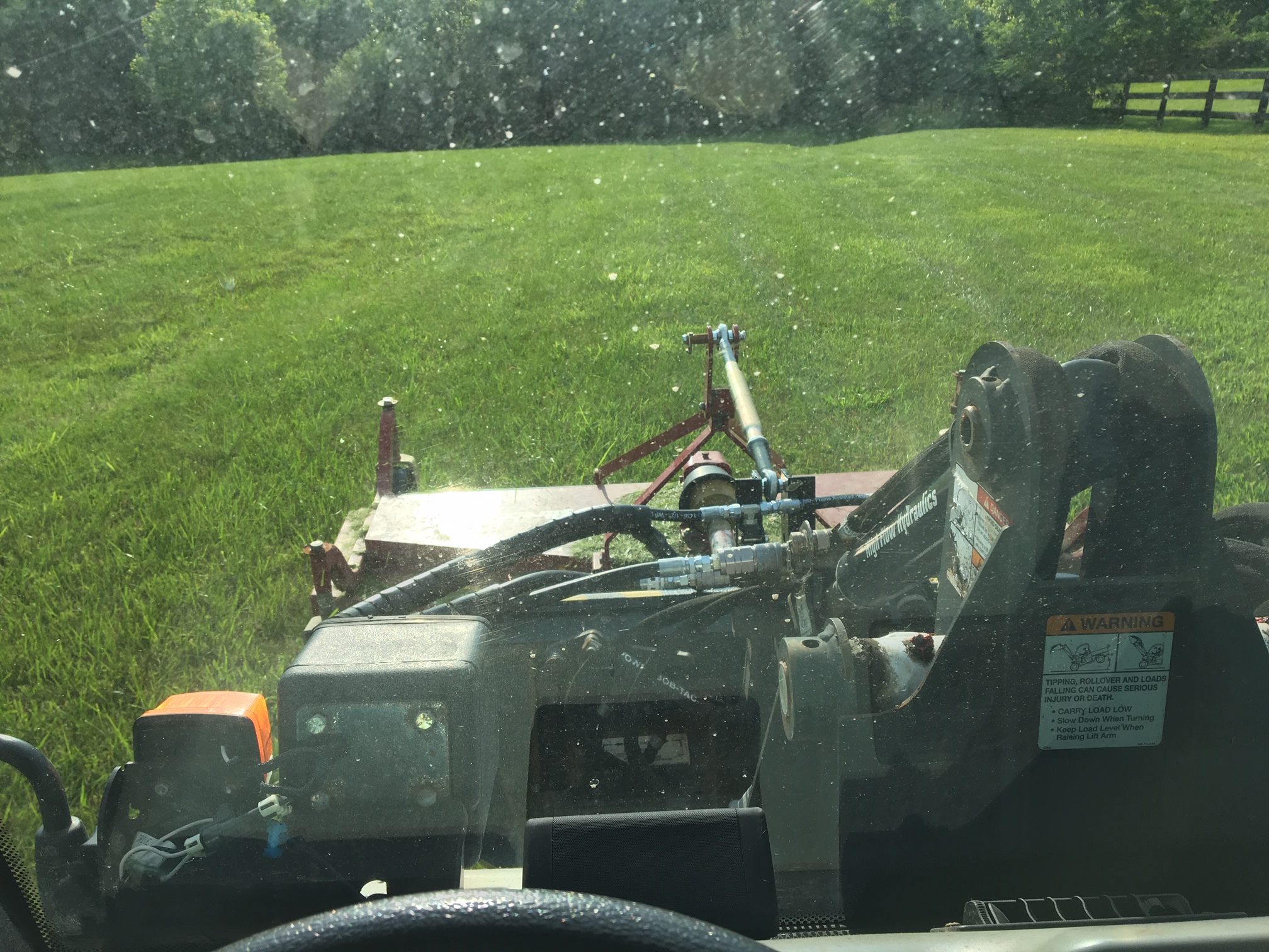

Just a few updates. Not long after completing it's new home, the alternator bearing seized up and smoked the belt. New alternator order and a new belt, and that parts back together. While playing around with the alternator, I realized the AC clutch is shot, and that the AC isn't working. System had pressure which was good, but time for a new AC compressor, drier, etc. and at least one belt, as one of the hoses died while being removed. I've got all the parts in but the hose, which had to be ordered. With any luck I'll have functional AC again soon.
#9
One general note on the belts, has anyone changed the AC belt on their machine before? There's no tensioner, and there's no adjustability in the AC compressor mount, so I can't for the life of me figure out how the belt is put back on. Any ideas?
Well, ran into another what I hope is a minor issue, but I couldn't sort it out, so I dropped it off at Frederick Bobcat this morning. I'm not getting any, or at best very low aux hydraulic flow. Seems to be generating plenty of heat, fluid levels are good, and it was changed along with the filters not long ago. No weird noises, clearly some engine loading when it's on, but no flow. We'll see if they can sort it out.
#11
Some good news! It seems the issue with the auxiliary flow was simply about coil on the valve. They fixed up the AC system as well, so I'll grab it on Friday and get to mowing with my finish mower!

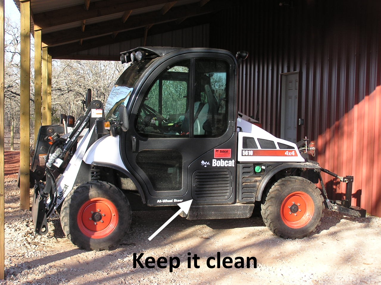

To keep cool when mowing, carry a brush in the cab that you can use to brush off the condenser coil behind this side door:
/ First Post - 2015 5600 Toolcat #14
Yep, good news :thumbsup:.
I found that a paint filter for 5 gal pails work good as a dust filter. Just open the side door, slip the paint filter over the door, then close the door. After mowing, pull the filter off the door and shake it out. Dandelion season is here and the white fluff will pack it full. They do sell a side screen kit that fits inside the door #7199661.

We'll she up and running, mowed my first 4 acres with it, and I'm very impressed, especially with the AC!
Might need to find some more turn friendly tires. Any suggestions?
