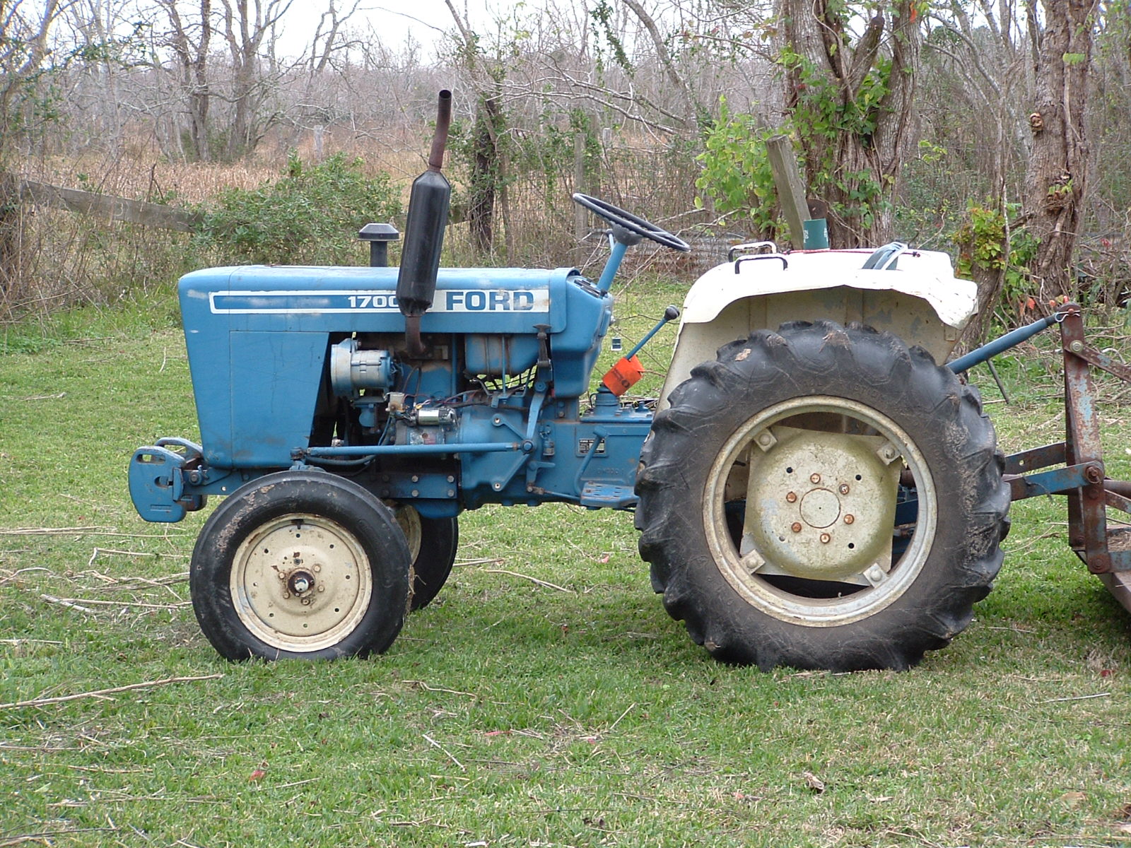

Hey JC and jones, do you have a recent picture of your 1700?. here's one of mine. A little worn, but runs great. Took that picture today, a balmy 60 degrees here today. Was out clearing the property.

Nice JC. Some times I wish I had turf tires to change into when the ground is wet. I noticed that you have a full rack of weights in the front, are those factory, or can you get after market ones that fit? Or maybe I need to get lighter implements! lol I've been pulling around this 5 ft cutter, pretty heavy but the Ford doesnt complain too much. Looks like you have plenty to mow out there yourself. Thanks!
