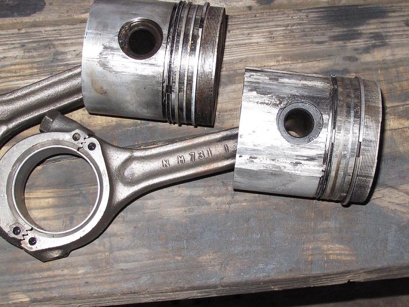

Well I didn't tell the whole story of my tractor(s). When I got the first one I took the head to have someone look it over. He said that it was too bad for welding because the crack went through the valve seat. But he said he could "pin it". I found out this was reaming a hole and pressing a pin in, drill another hole and another pin until the crack is gone. Well it took several months and several phone calls before I got the head back and it still wasn't finished.:mad: So that project fell by the wayside. Later I was looking on ebay and found a 1700 2WD and danged if I didn't buy it for $2500.:eek: That tractor ran good but I really wanted the 4WD. That way I can get deeper when I get stuck in the mud. Now I get the bright idea that I will rebuild the engine on the 4WD and take the good head off the other tractor. I will take the best parts from both tractors, fenders, hood, whatever and build one good tractor. When that one is finished, I will look in to getting the cracked head fixed and get the other tractor ready to sell or part out.
Now JC's message said that I wouldn't have to go past pulling the head, pistons and oil pan..... Well.... I went a little further than that as I am now up to my ..........elbows in torn down tractor parts. The 4WD tractor was abused the last year or so of its life and the only way to have confidence in the tractor is fix it right. Besides the picture at the end shows why I had to buy pistons and have to get it bored 0.20 over. The main and rod bearings looked good but the crank had to come out to find out for sure. I didn't have much time for pictures tonight. More will come later. My parts came in today so I need to check everything before going to the machine shop.

Boy JC those pictures show a pretty robust block and head and those connecting rods could be weapons, why is the inside of the block red? is that from the factory or machine shop.

The whole casting gets covered with the finish inside and out. It is not powder coated but it is a pretty though finish, probably enamel. The Ford Blue was painted afterward. when they spray painted my tractor they missed a few spot right under diffy and it is red and exact the same finish that you see on the inside and next to crankshaft. when I opened the lift piston assembly it had exact the same finish as well. I agree it is a good and robust looking cast. With proper oil(lubrication) and water/pump (heat removal) would be difficult to kill this thing. Using explosive gases to get the tractor started in my point of view is strictly prohibited.
