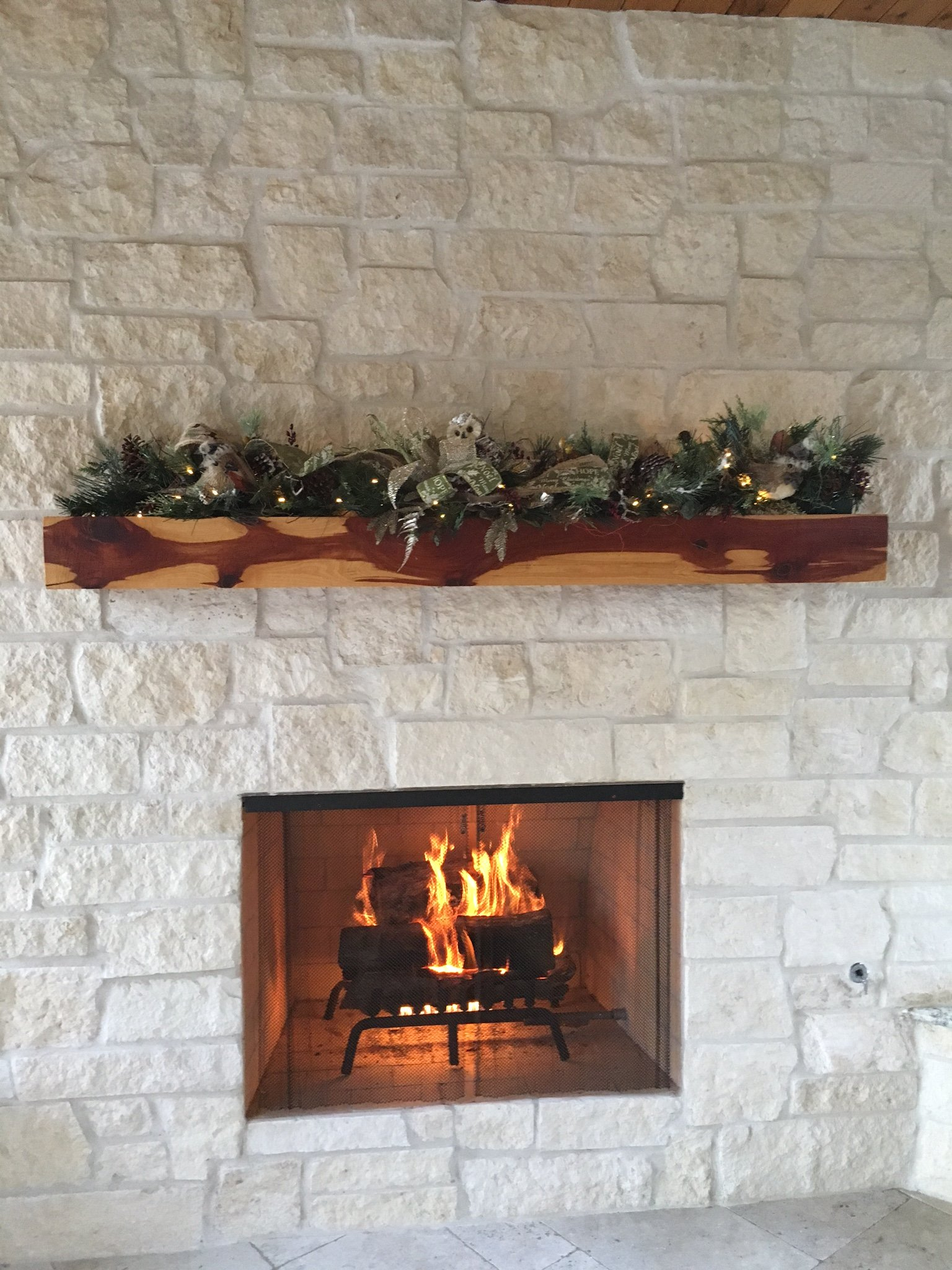

Thanks Sranch. Under very extreme conditions, might get some horizontal rain, but I’m going to apply 5-6 coats of polyurethane to every square inch both too, bottom & sides after all woodwork completed. The wood was milled in 2017 so it’s fully cured. It’s the same wood that I made the fireplace mantel, as shown.
