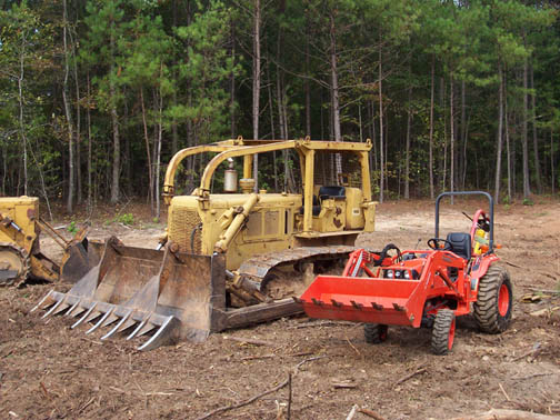

Looks like it will handle the situation well. Just remember to bring along some padding to protect the machine from the chain that is going to bring it back on its "feet". How are you going to get it to where you are going to service it? I suggest that you consider having some old tires along with you in the event that it needs to be pushed somewhere. That blade looks like it can do a lot of damage without even trying. See if he can push the loader closed while you hold the valve before it is uprighted. That will minimize the possibility of damage to the arms in the uprighting process.
