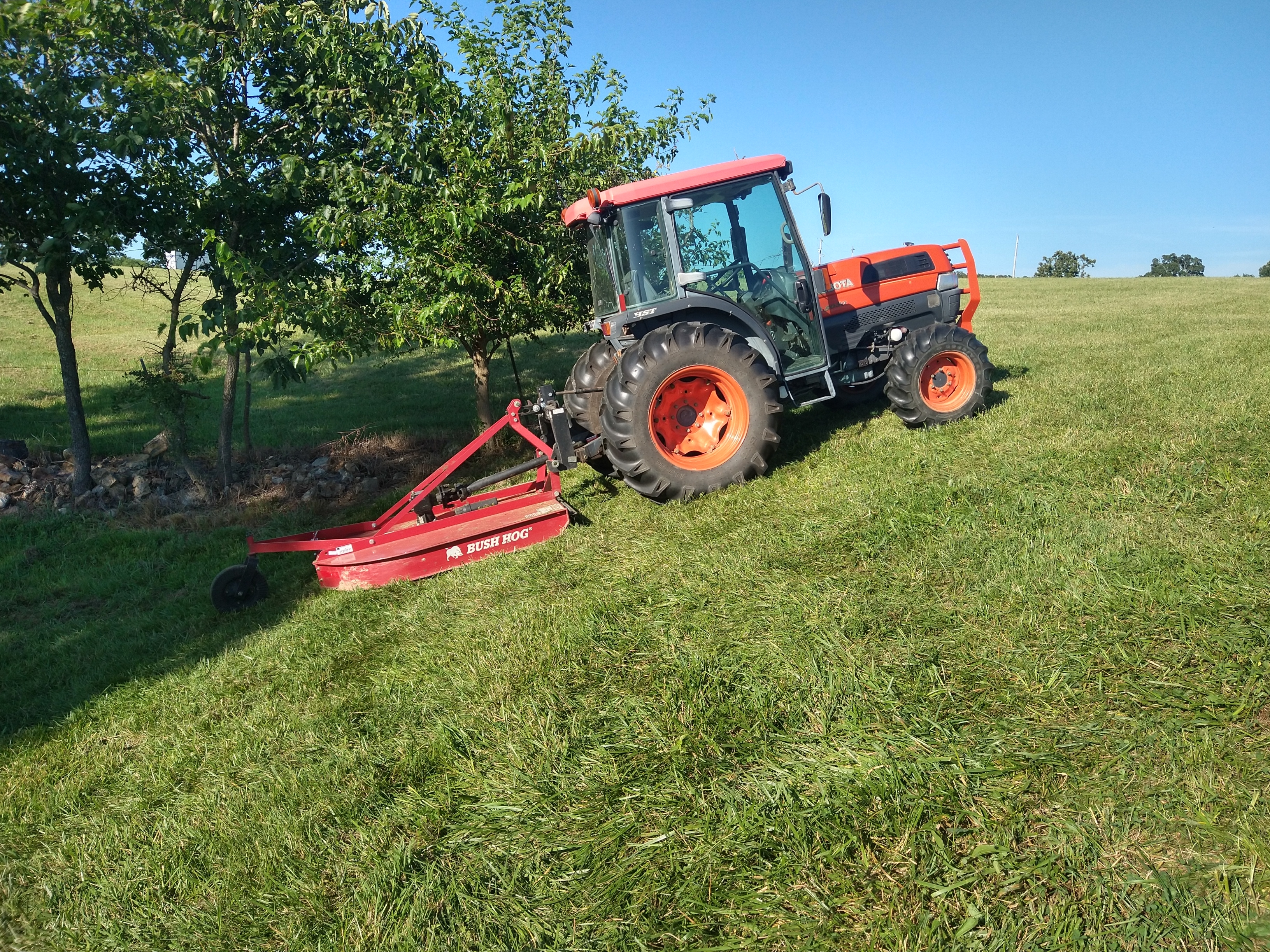

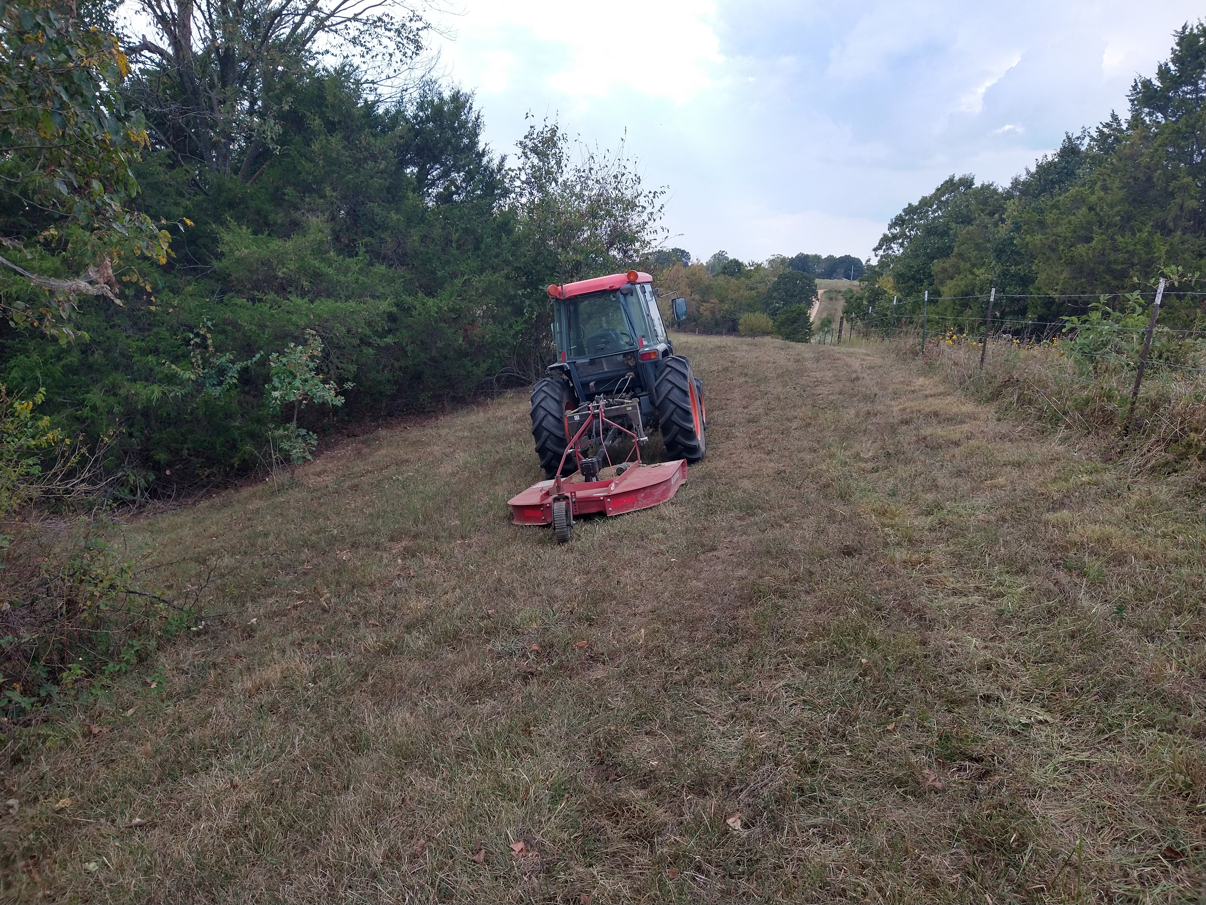

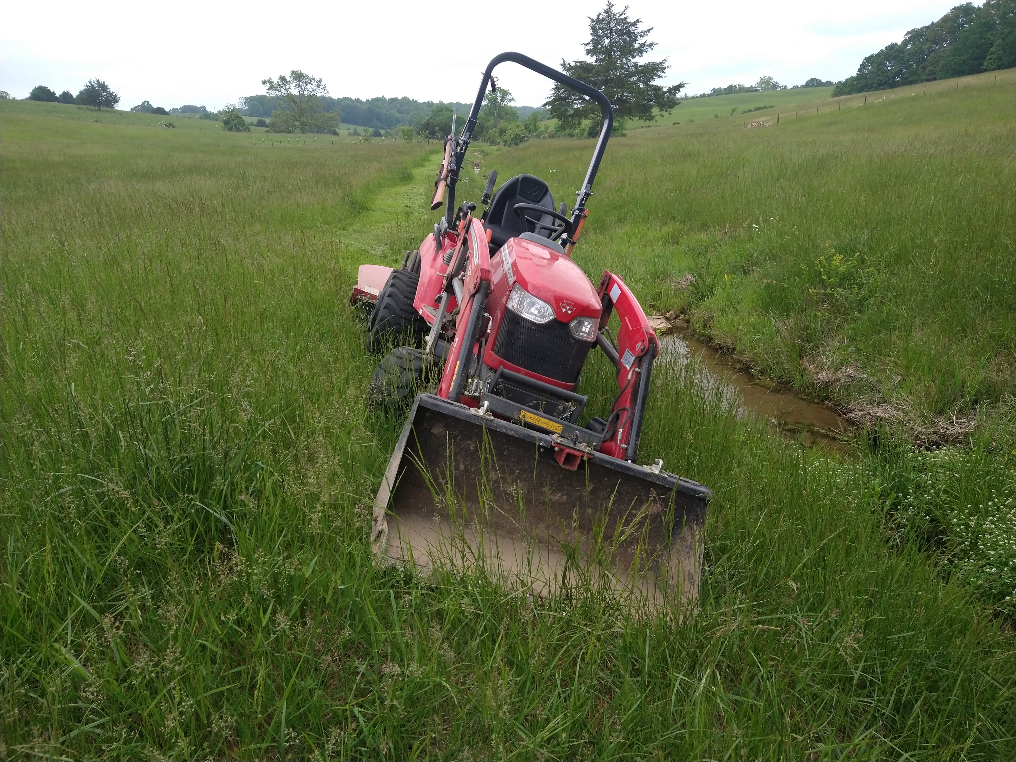

The manual on my Kubota L5030, in the safe operation section only says to set the wheels as wide as they go for widest practical application ... Nothing about reduced weight capacity or increased wear ... The wheels have adjustable spacing, I have them at there widest.
My Massey Ferguson GC 1725 MB doesn't have adjustable wheels, and doesn't say anything about wheel spacers, I have 3" spacers on the back, and 1.3" on the front ... Haven't noticed any "wear" or problems in the 735+ hours I have on it, I bought it new ...

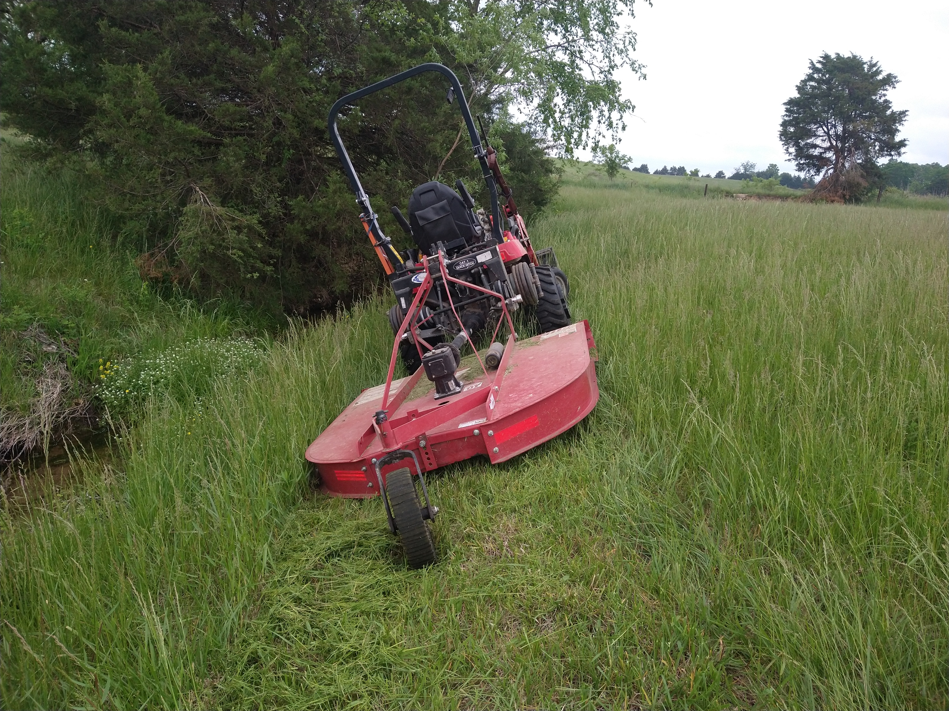

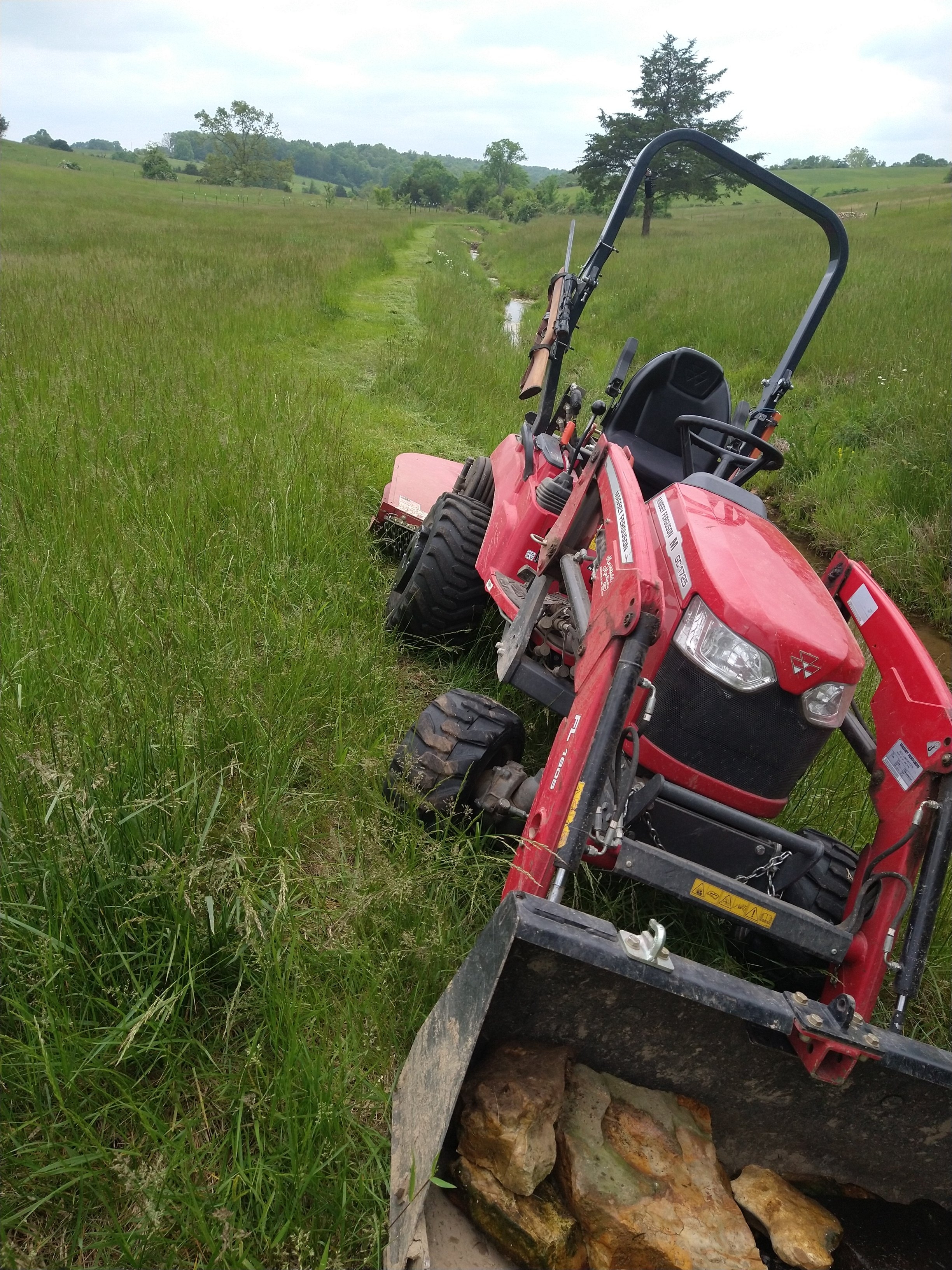

My "seat of the pants meter" went off at this point, my front tires wouldn't pull/steer up hill in 4X4 .. the 5' brush hog on the back is a bit heavy for it, and I had forgotten to put rocks in the bucket like I normally do for front ballast ...
I gingerly got off the top side holding onto the ROPS hoping it wouldn't tip over, it didn't ... I gave it a little "shake" ... Rock solid ... Gave it a "PUSH" , still stable ...
You can see how the front tires had spun a little trying to pull me up ... I probably could have just backed up, but I didn't feel like it, plenty of weight on the back, and down low, tires are filled, 70 Lb steel wheel weights on each side, and 275 Lbs mounted on the BH frame, plus the brush hog , rear tires had not broken traction ... Once I added a few rocks, the front tires could steer, and I just drove out!
I can easily mow this hill sideways in 2 wheel drive with this Kubota, rear tires are not filled, but the MF needs to be in 4X4 ...

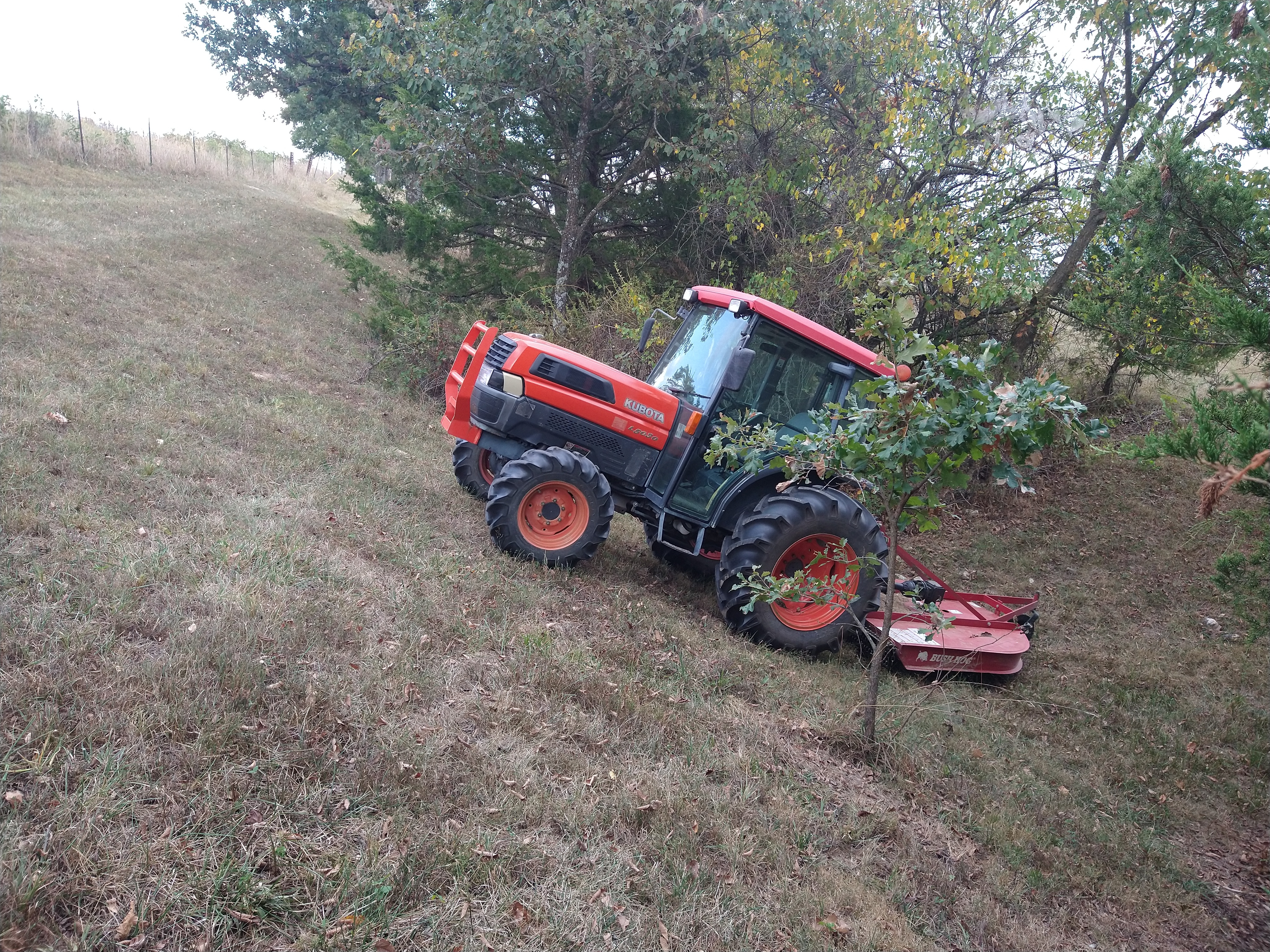

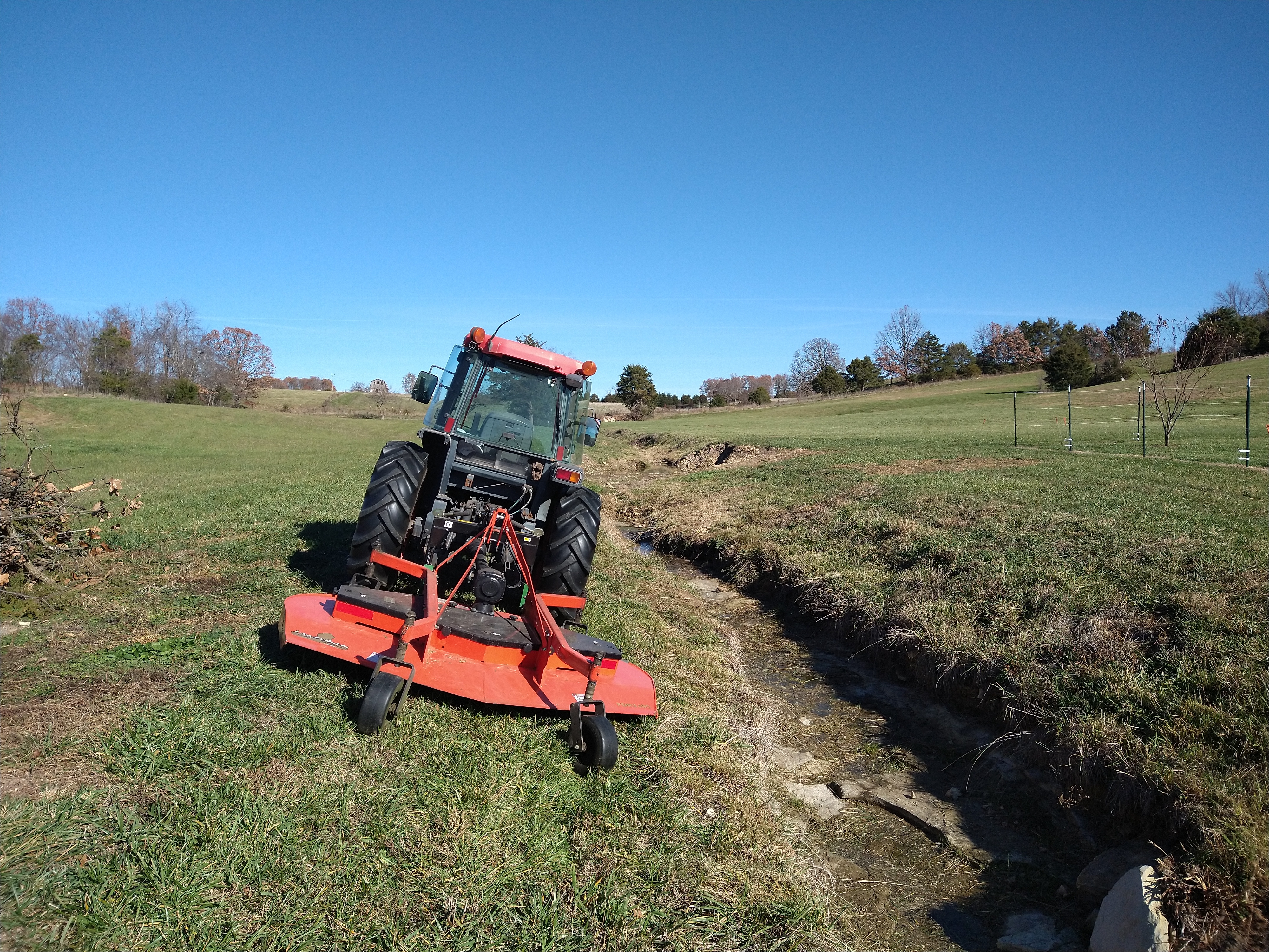

This next picture is the same place as the previous picture, the little tree near the rear tire is the same as the one 10' to the left in the previous picture, with the 5' brush hog I can mow this in 2 wheel drive, but with the 90" finish mower, I need 4X4 to pull it back up, it weighs twice as much, and all the weight is on the ground ... I mow sideways on the hill until I get to that little tree, then go up and down to get beside it ...
Now it would be interesting to take a 2x4 that's as wide as your tire tracks and lay it across the areas you were concerned about, then stick an angle finder on it to determine the exact angle it was on. Do it in several places if you do it.
