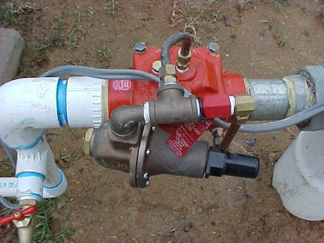

The other side of the Cycle Stop

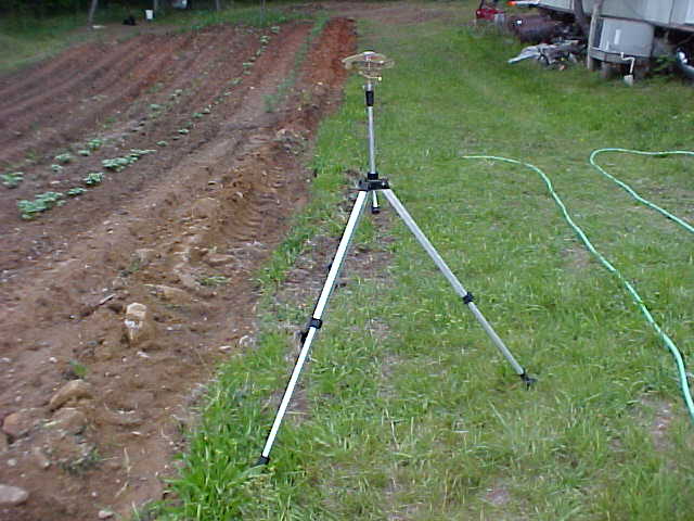

Here is a Picture of the TriPod Sprinkler we have purchased to use until we get the irrigation system installed. They will also be used to spot water if and when needed.

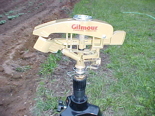

A close up of the head. These tripods are easily adjusted.

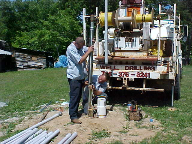

Putting pump motor on the pump

Pump, motor are over 6 feet tall. It was installed 260 feet below surface.

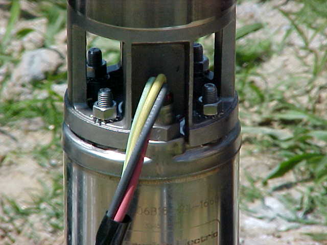

Water Intake before screen is applied.

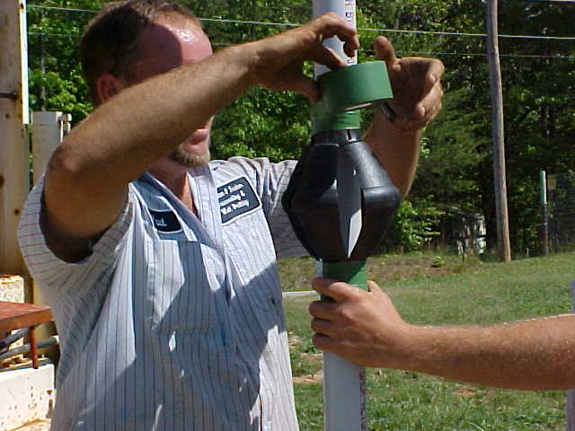

2 inch schedule 80 pipe was used and antivibrators was put on for the first 60 feet to prevent pipe and pump from being damaged on startup.

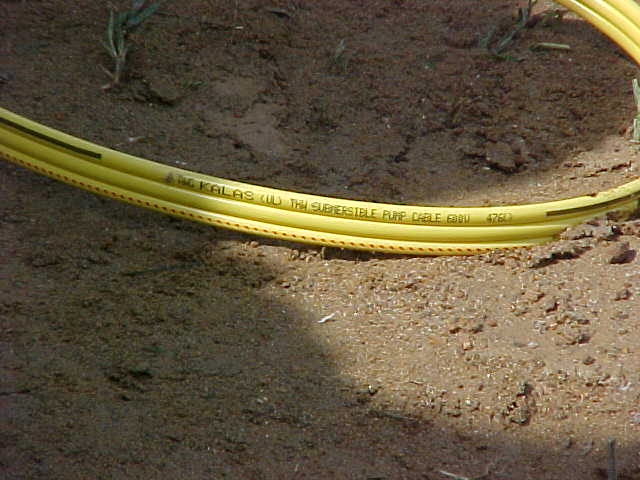

This is a picture of the three wire that the four wire was replaced with when they had to repair pipe that came apart.
