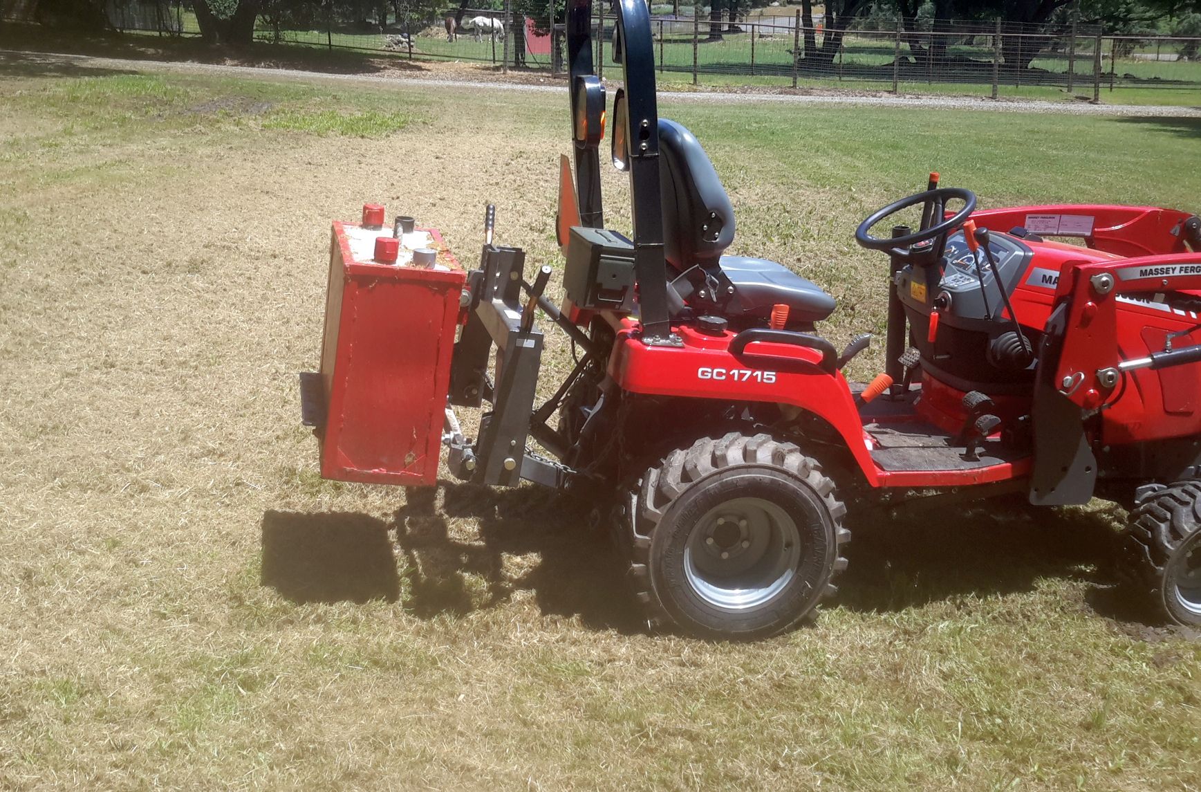

I have Massey Ferguson GC 1715, and so far I get by (for 2 years now) with a 5 gallon diesel fuel can (the small engine just sips fuel), an $25-$30 manual grease gun (that takes tubes of grease) and some basic hand tools........Biggest time consumer is checking coolant and engine oil and sight glass for HST fluid ..... Real problem are lynch pins and "R" pins that go missing and small hardware like clevis's and rings to attach chains and ropes for dragging stuff and getting implements matched up to quick hitch... Oh yeah, a quick hitch...
Do not go out and buy a bunch of stuff because you "think" you might need it, buy what you need when you discover you need it, and for some items a spare...
One thing I highly recommend if you are going to do heavy lifting with front end loader is a rear ballast weigh on three point hitch....
And maybe some bucket hooks on bucket IF you are going to strap things in to bucket to keep from spilling them out of bucket... Good for lifting things too...
There will be other things as you go along, just get then as you need them....
