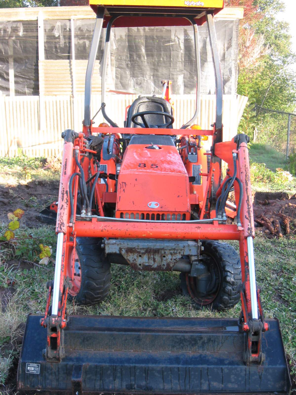

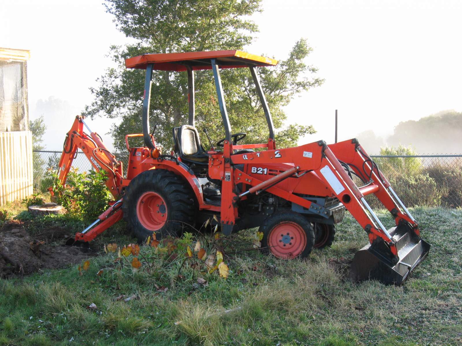

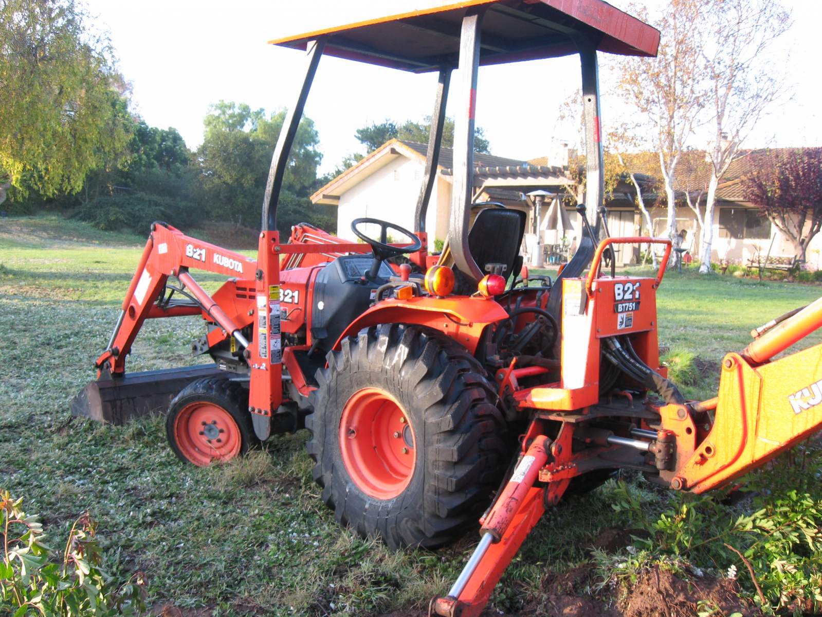

Here are the pics of my new-to-me B21.

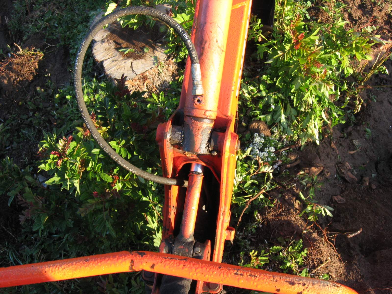

Check out the pic of my BH hose and tell me if I am missing something to protect the hose. It seems to rub more than it should and does not look right to me. However, I cant find a pic from this angle on another B21.

That does look a little strange, but it seems like if it connects on that side then it has to have the slack to avoid kinks in the line.

It seems like you could put a sleeve over the BH hose made of canvas, similar to those on the FEL and other places. Wouldn't hurt.

The hose in the picture is not properly routed. I have tried to find a picture but can't seem to this morning. I believe that hose should be inside the boom and then come out at the joint with the stick and loop back down to the cylinder. If I am not mistaken, there should be a piece of metal tubing from the cylinder fitting to the hose. I think the original hose or tubing got damaged and the person who replaced it was too cheap and/or lazy to route the hose correctly.
