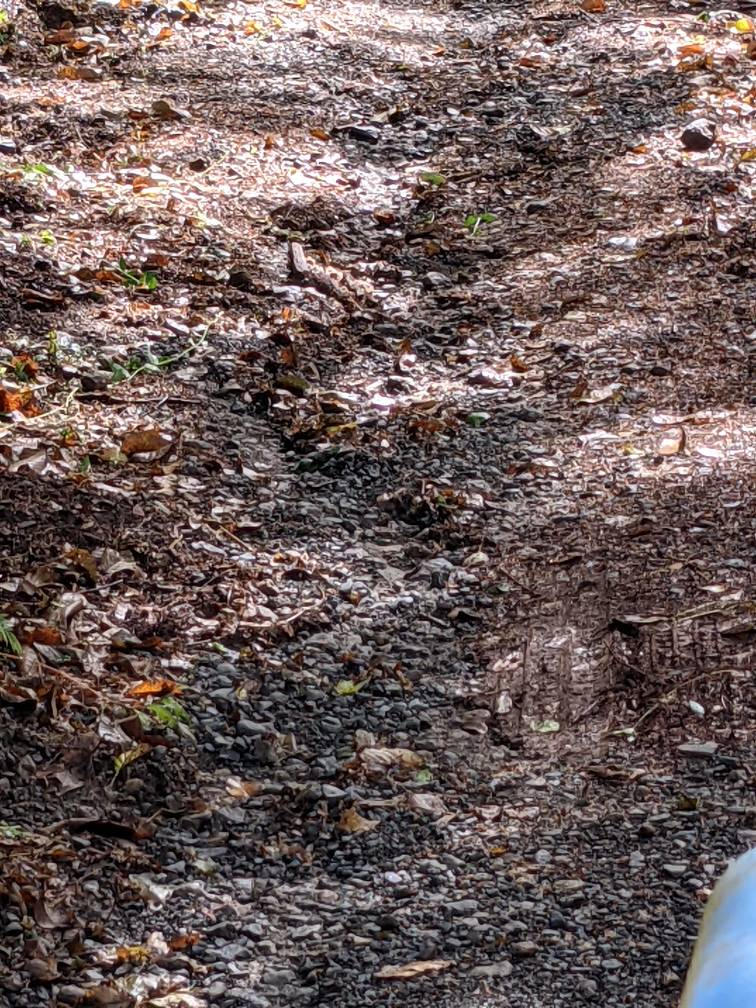

The part I worked on I used the drag harrow on the worst side to loosen the top a little and a box blade set so the cutting and smoothing edges were about level. The other side I just box bladed. It's much smoother on the side I harrowed, but it seems more dusty.
The driveway scraper grader would help to level it,
just moving material from the high spots and filling the low spots.
It would need to be done when the ground has some moisture in it to pack it back down.
Otherwise it's just loose marbles that will kick right out.

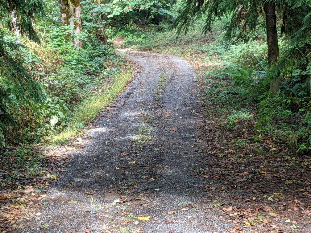

I am working on moving some dirt to make ditches again. I thought that dragging the dirt onto the road would be good and need the rain to pack and set? But that sounds like I need to do that in the summer. I will get some pictures of it today.
Just having issues getting the driveway. Would like to fix it before the long rains set in.

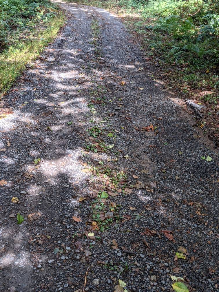

Here are some photos of my driveway

Recycled asphalt product yes, but not raw asphalt grindings. In the off season he asphalt plants around here take the raw grindings and run them through a crusher and make the 3/4 minus RAP which they mix back into the hot mix. The RAP is a little more expensive but worth the difference in price. Lay that stuff down on a warm day and rent a rolling compactor and it's almost as durable as hot mix asphalt. The problem here is the nearest asphalt plant is 40 miles and trucking costs add up quickly.
This spring I did order a load of recycled asphalt to repair some stretches of my drive.
True there is a bit of loose gravel that has surfaced but upon close inspection there was a well fused layer of asphalt underneath. (I actually took a broom to it)
The desirable good news is that heavy downpours have not eroded my drive.
It works!
Trick is to order early spring so that the hot sun can re fuse it.
