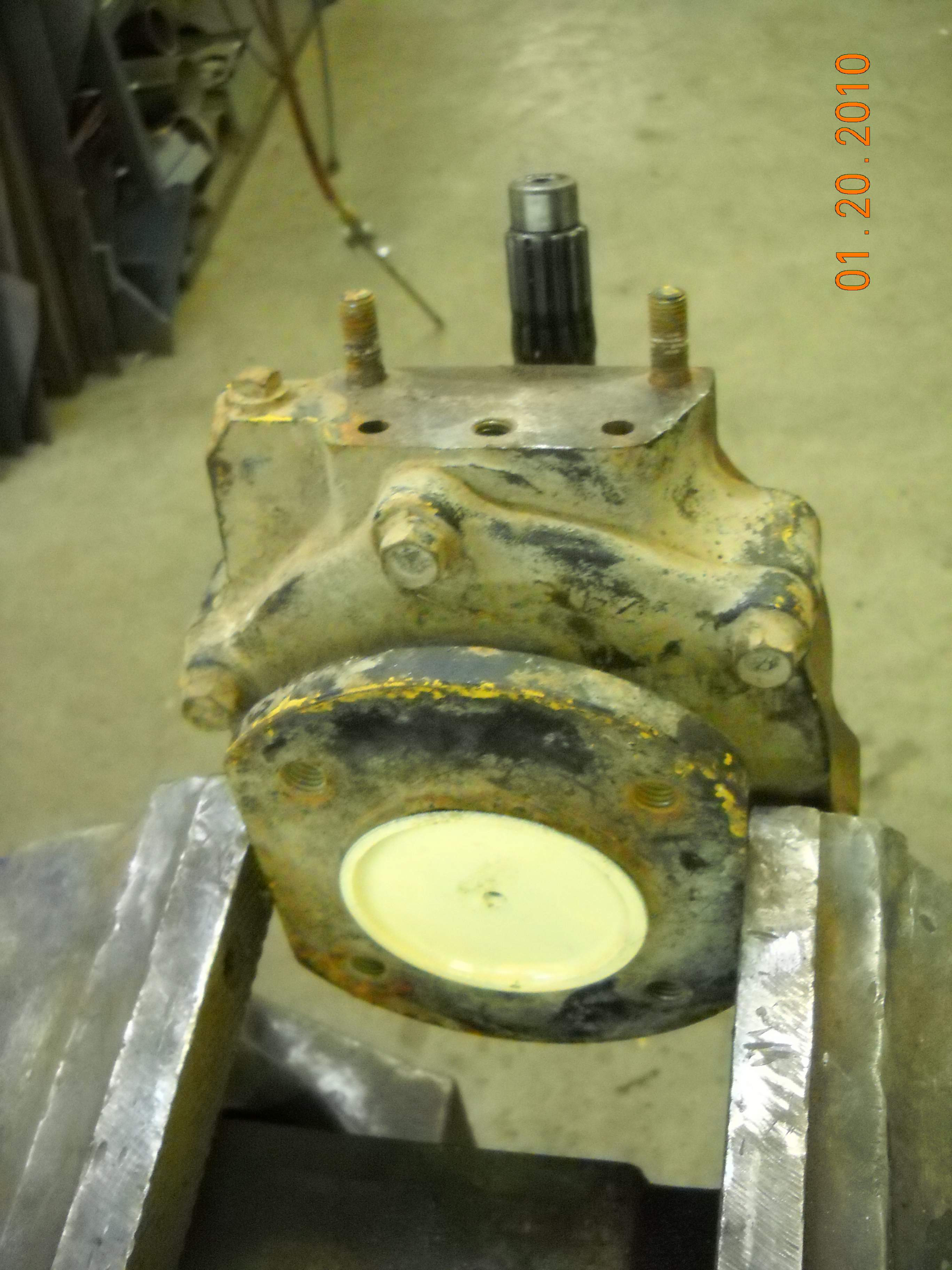

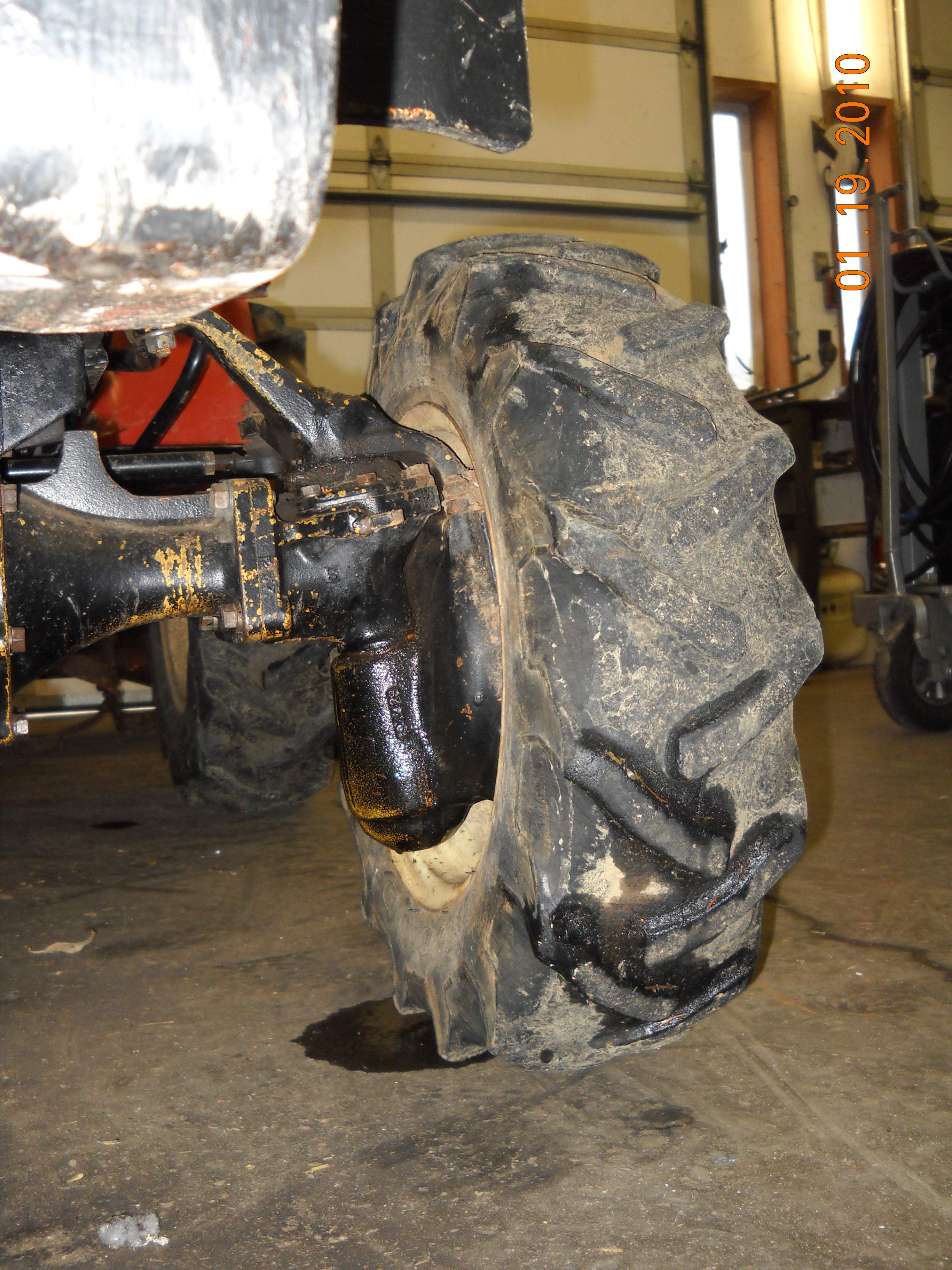

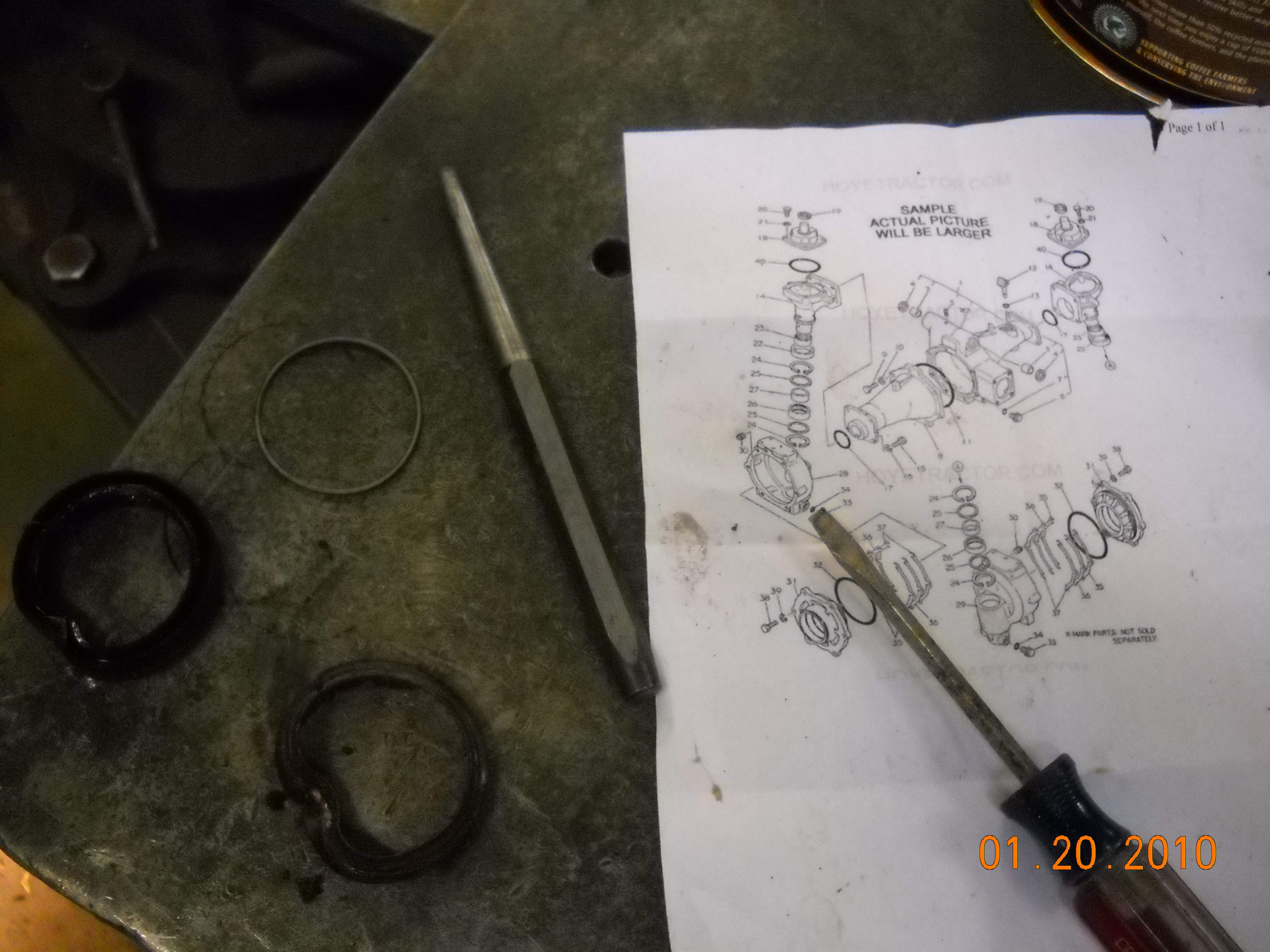

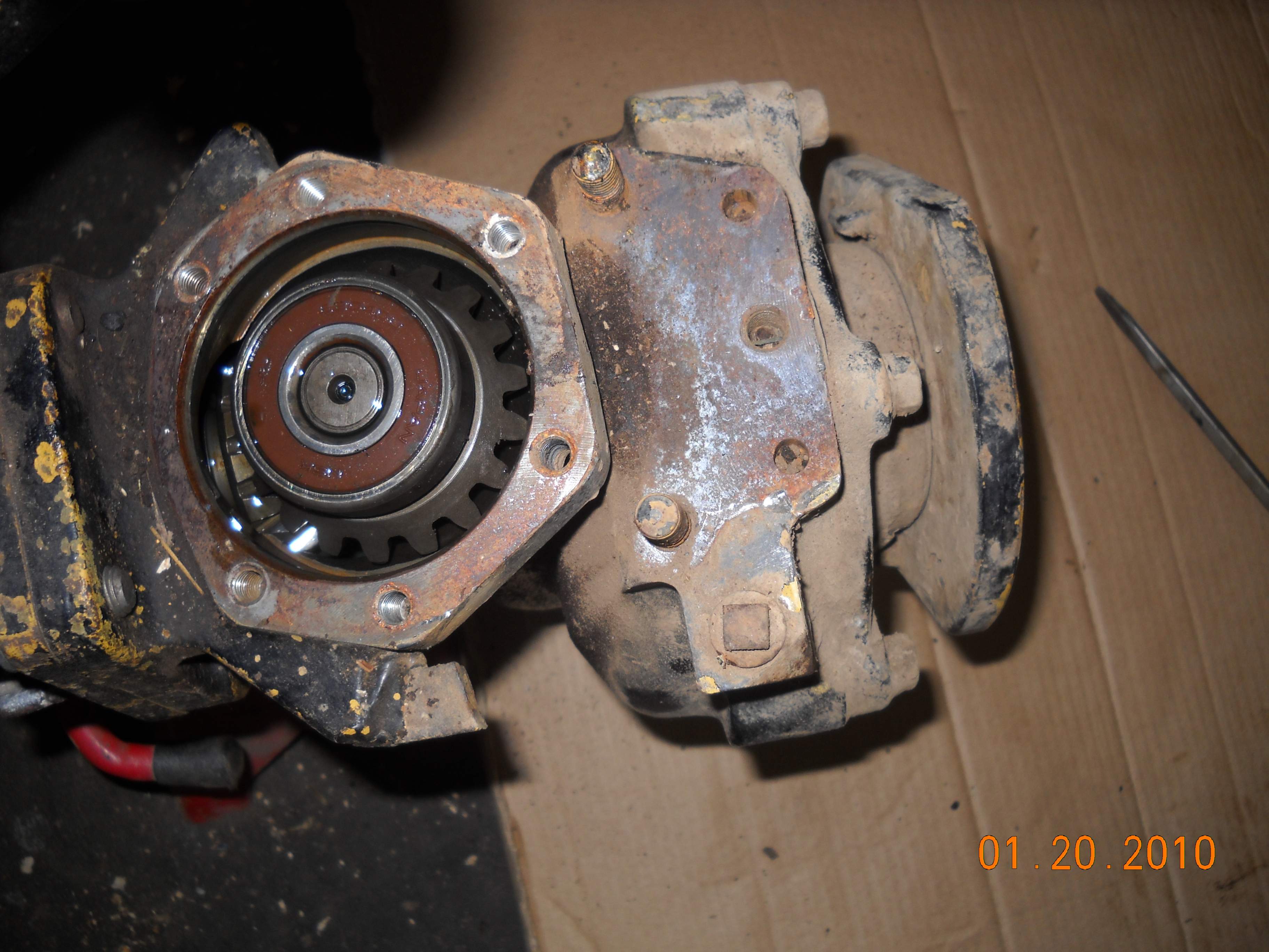

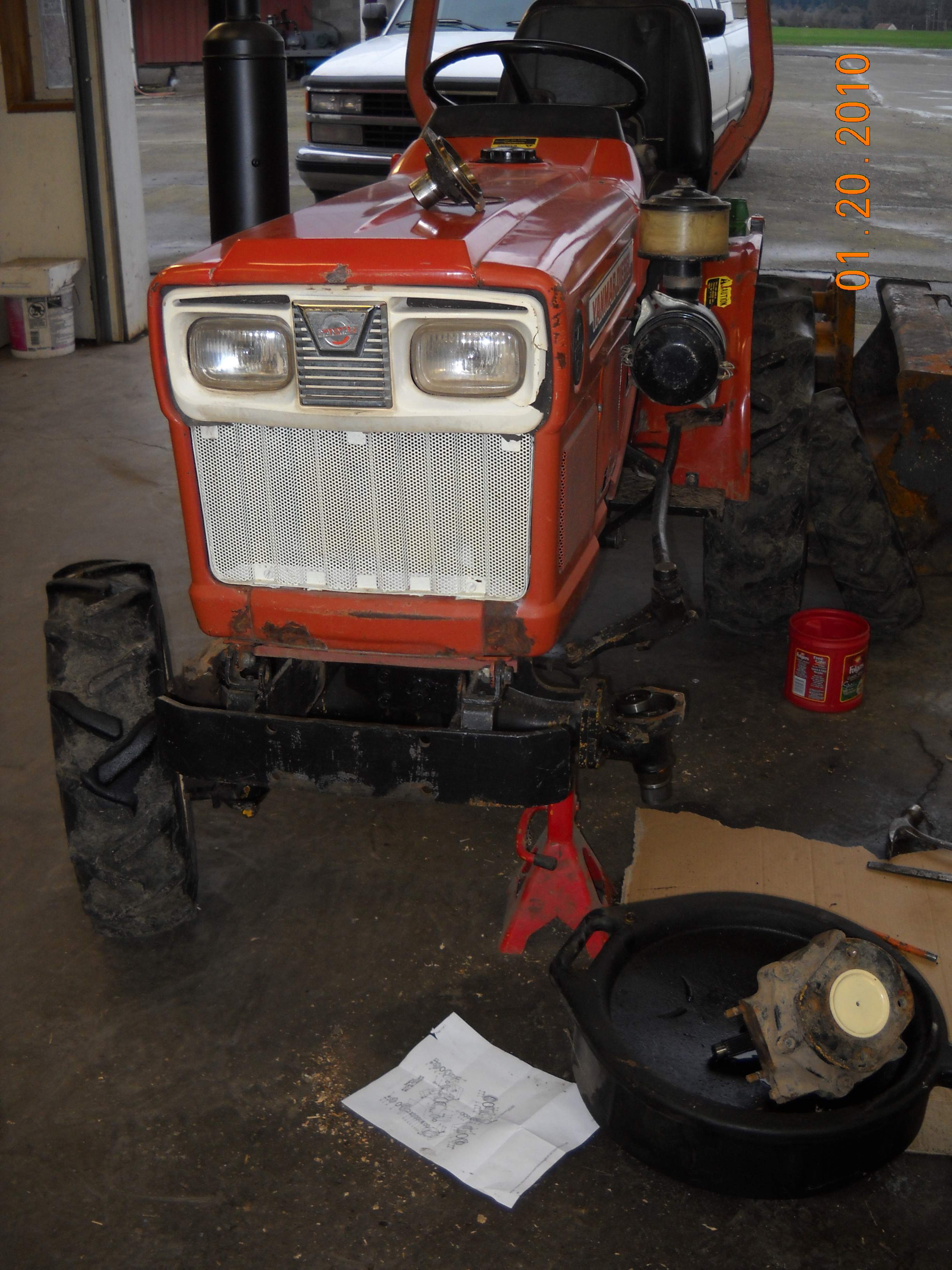

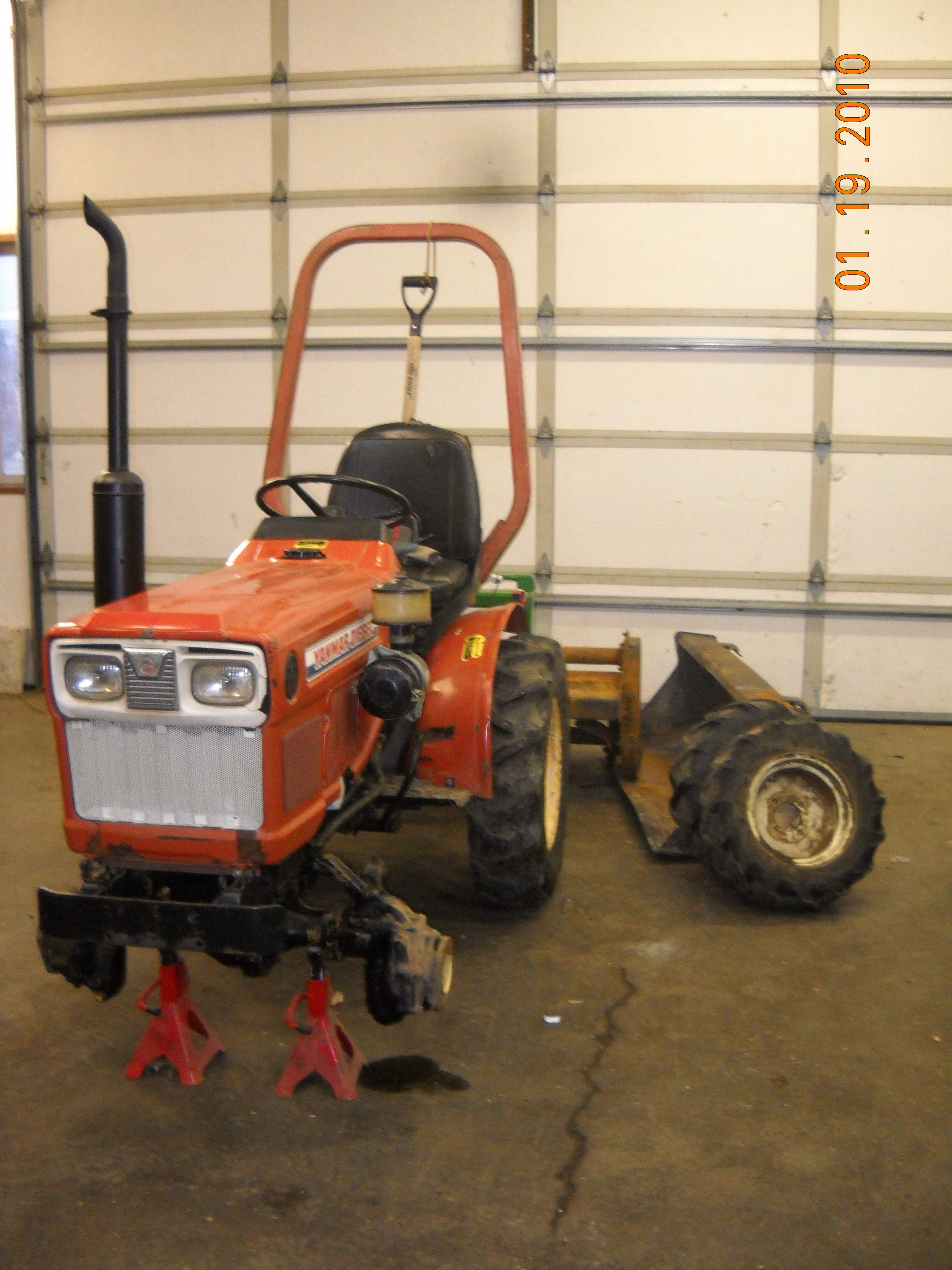

As many know on here, I have a Yanmar 169D tractor. Ever since I bought it, It has been leaking oil badly onto the garage floor. So I decided it was time to fix it. Yesterday, I started taking it apart, getting the wheel off and such and finally today My grandpa and I got it off to fix it. I took lots of pictures. Anyway, we got it off and got the seals out that are no good anymore. Tomarrow my grandpa is going to go to Napa to see it he can get the seals so i can get my tractor back together so i can earn some $$$ with it doing small jobs. What i'm wondering is that if I can get the seals from Napa, does anyone on here sell these seals? I checked hoye tractor's site and found nothing so far.

Better luck getting the seals from 1 of the dealers on the yanmar forum
/ Fixing my Yanmar #3
Jacob- I see your in "small town USA", but, I've found that for bearings, seals, gears, etc. I'm best off at a local Bearing Shop. If you can read the lettering on a bearing 'race' or seal that you need, your halfway to more reasonably priced replacements! Whether Fafnir, Timken, etc. most dealers have cross indexs that can save you big!! Even would make surfing for parts easier. Look for the numbers!!! Best Regards! ~Scotty
http://www.buffalobearings.com/bflobring_main.htm
/ Fixing my Yanmar #4
If you will go to Fredricks Equipment on line and look under front axle they list #s for your tractor. Don't know if they stock them but part #s are threre. Hope this helps. Have to scroll way down.
/ Fixing my Yanmar
Hey thanks guys, I printed the bearings and seals sheet off of Fredricks Importing and highlighted the bearings and seals that will fit my Yanmar. They are under the 1401D but since the 1401D is the 169D's cousin from Japan, the parts are the same.
/ Fixing my Yanmar #6
Just remember Jake, The Yamar part number, is not the bearing number, for cross fitting purposes! Follow me? ~S
/ Fixing my Yanmar
Hey thanks. Yeah I follow you.
/ Fixing my Yanmar
Well, I got the seals ordered. They should be here by Saturday. :)
/ Fixing my Yanmar #9
Good deal. I guess you've looked at the sealing area real good and have no grooving or pitting going on. Seals have to have a pretty smooth surface to seal on. Good luck to you and grandpa.

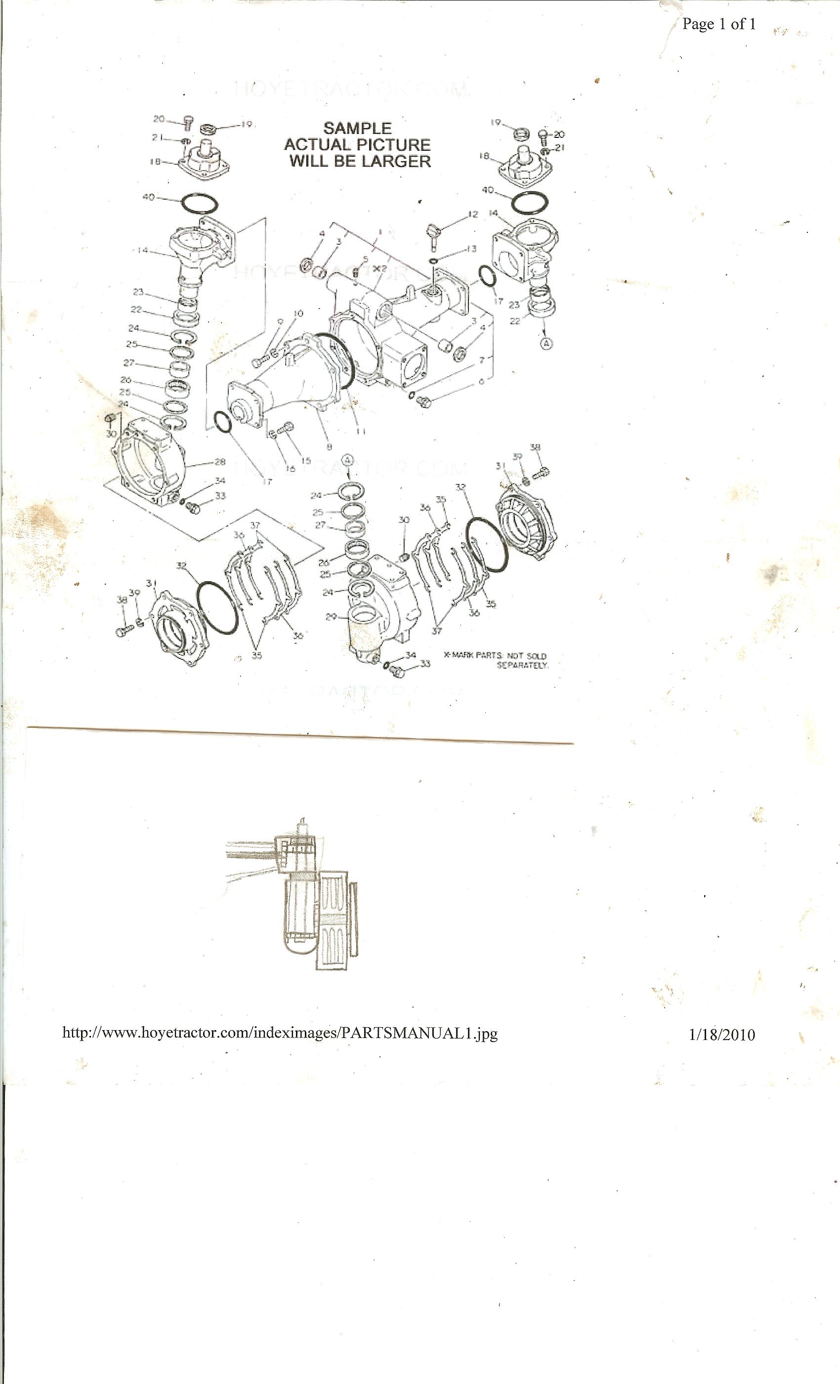

Thanks. Here is the diagram we used and the smaller one I drew. It makes perfect sense to me.

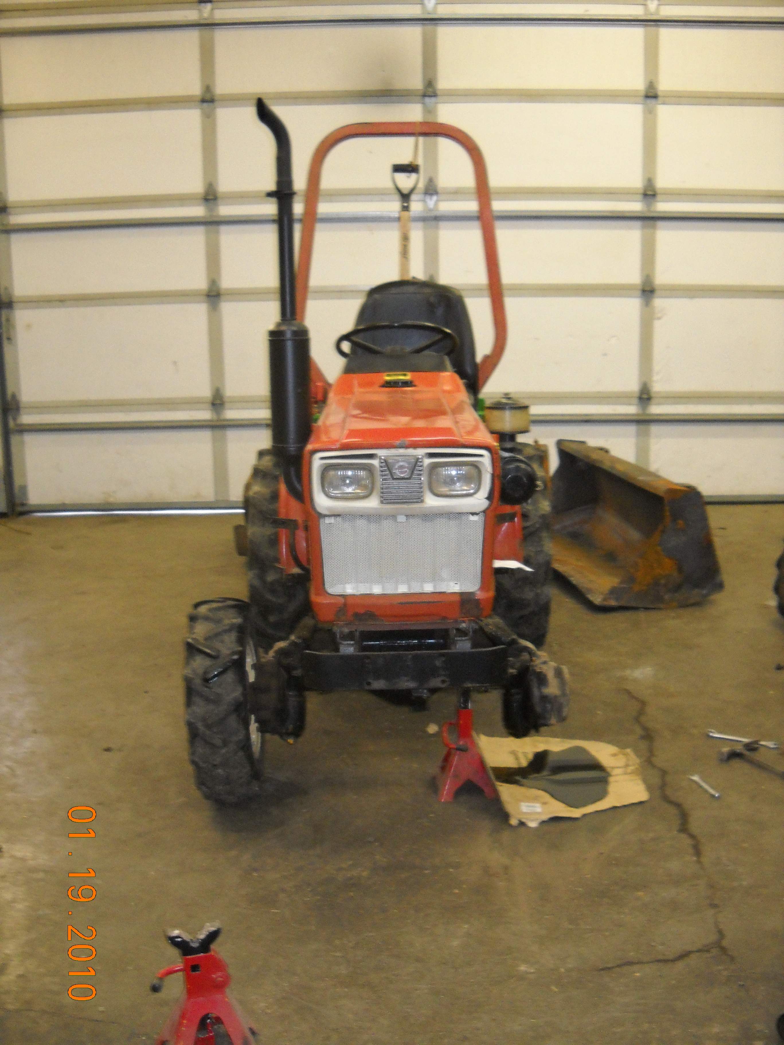

Okay, the wrong part came in but I managed to fix the cap so I got to put the transfer case back together. Put in the new seal, put the case back onto the axle, bolted it up, and added a bunch of oil. Then got the steering back on it, put the tire on, and tried it out. No leak!:cool: I did test out that rototiller, got WD40 on it and engaged my PTO. It did not engage the ground but it didnt have any problem working. The tiller tines turned perfectly, i just need to replace all the seals on it and repaint it. Im pretty happy with that tiller so far. Anyway, I tested the tiller, then drove my tractor down the road to my grandparents house. With those front tires reversed, It definatly feels more stable. Tomarrow, my grandpa may wire up that light on the back of my tractor so I can see better when working in the dark (moving snow) so i can see my rear blade.

/ Fixing my Yanmar #16
From what I have read, you really should not run the front tires reversed. First, it puts added strain on the bearings and hard-to-find (expensive) parts in the front drive hubs. Second, by moving the ground contact point outward you increase the steering difficulty (instead of pivoting on a single point of ground the tire must swing around in an arc.) And you give the ruts more leverage for some thumb-breaking wheel jerks. Third, the increased stability is only realized after the normal pivot action of the front axle hits the stop, which generally is beyond the comfort zone of safe tractoring.
Mike
/ Fixing my Yanmar #17
G'day glad to see everything coming back together good for you as for the front tyres we reverse them on all the tractors we sell especially if they are doing a bit of road work as we find that we get anything up to double the tyre life out of them and still get good assistance from them have not had any failures with f/end components that we could put down to the tyrs most of the time it is a lack of maintenance :mad:. Keep up the good work
Jon
/ Fixing my Yanmar
#18
Hey, thanks for the responses. I will probably Put the front tires back inward but for not, I have the tractor on smooth pavement and doing light road grading. After reading how it may break (expensive) parts, I now plan to put the wheels back to the in position. I did however get that front grill installed yesterday. Also got the back light hooked up for night work.
