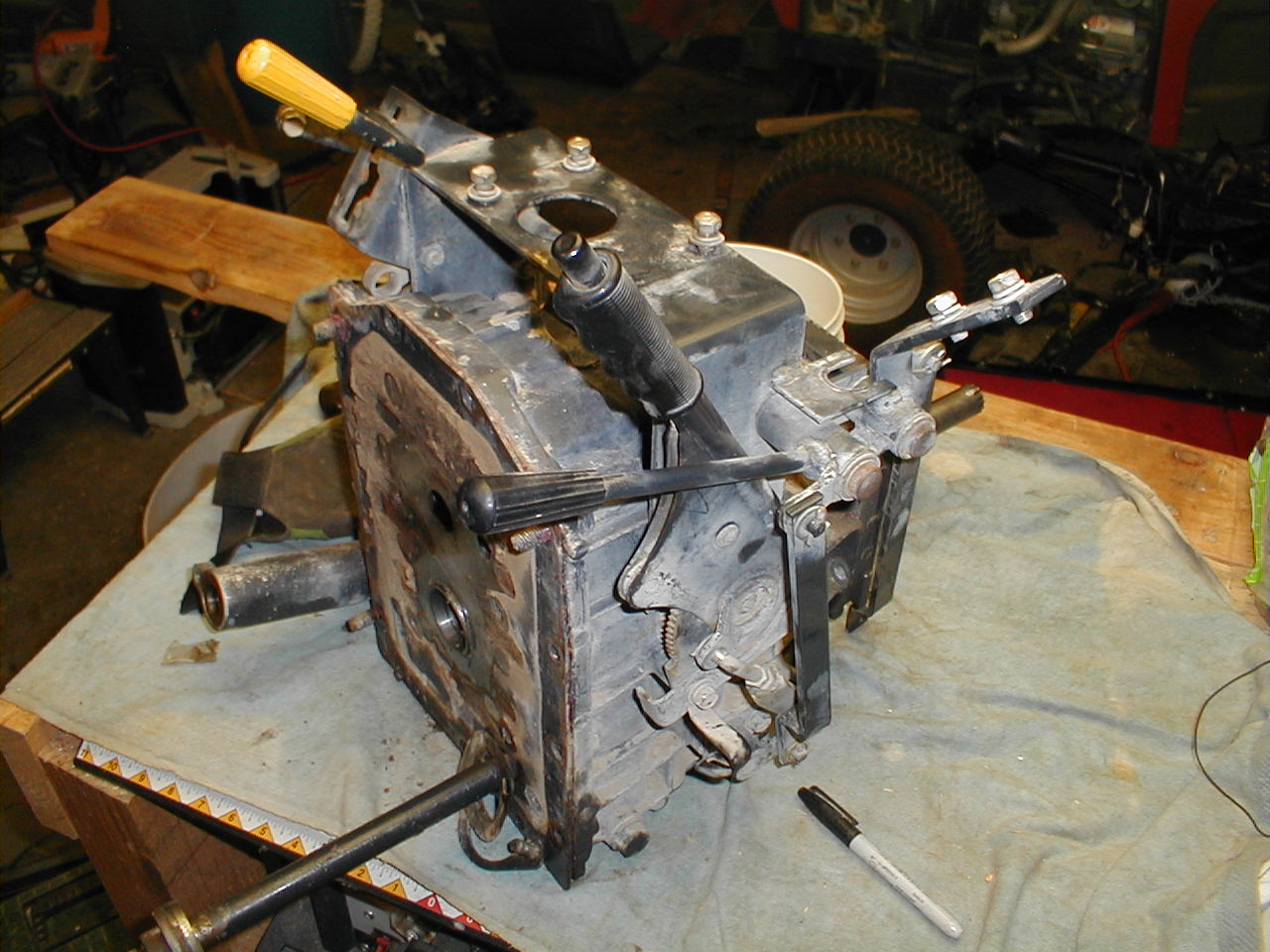

Here's a picture of the transmission sitting on the bench ready for "surgery"

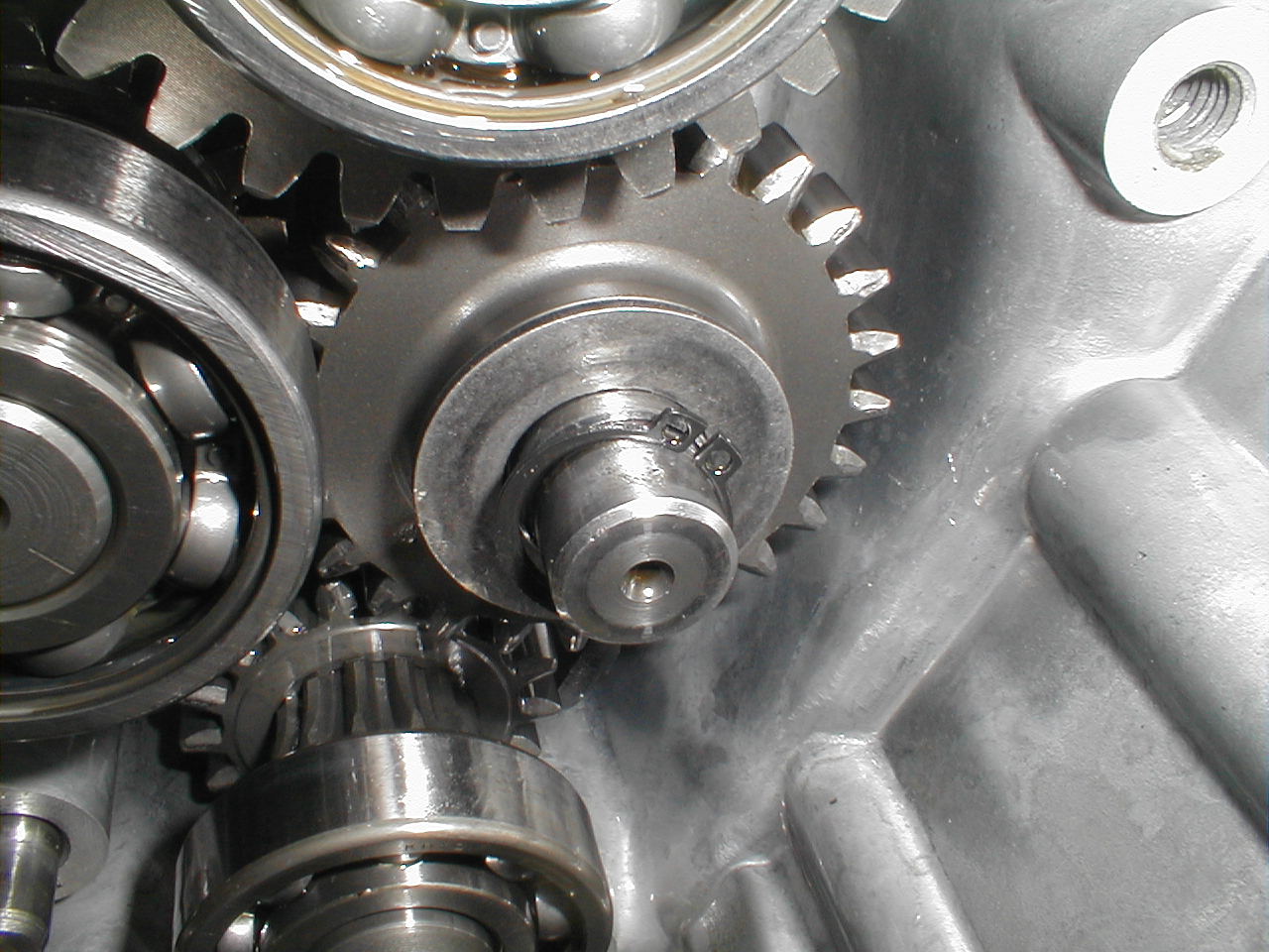

I've got good news and bad news. I'll start with the good news... The problem with the 4 wheel drive was nothing more than a bad snap ring. The attached picture is inside the transmission exactly as I found it. The snap ring had come loose and allowed the 4 wheel drive gear to move forward so that it wouldn't engage. That will be cheap and easy to fix.

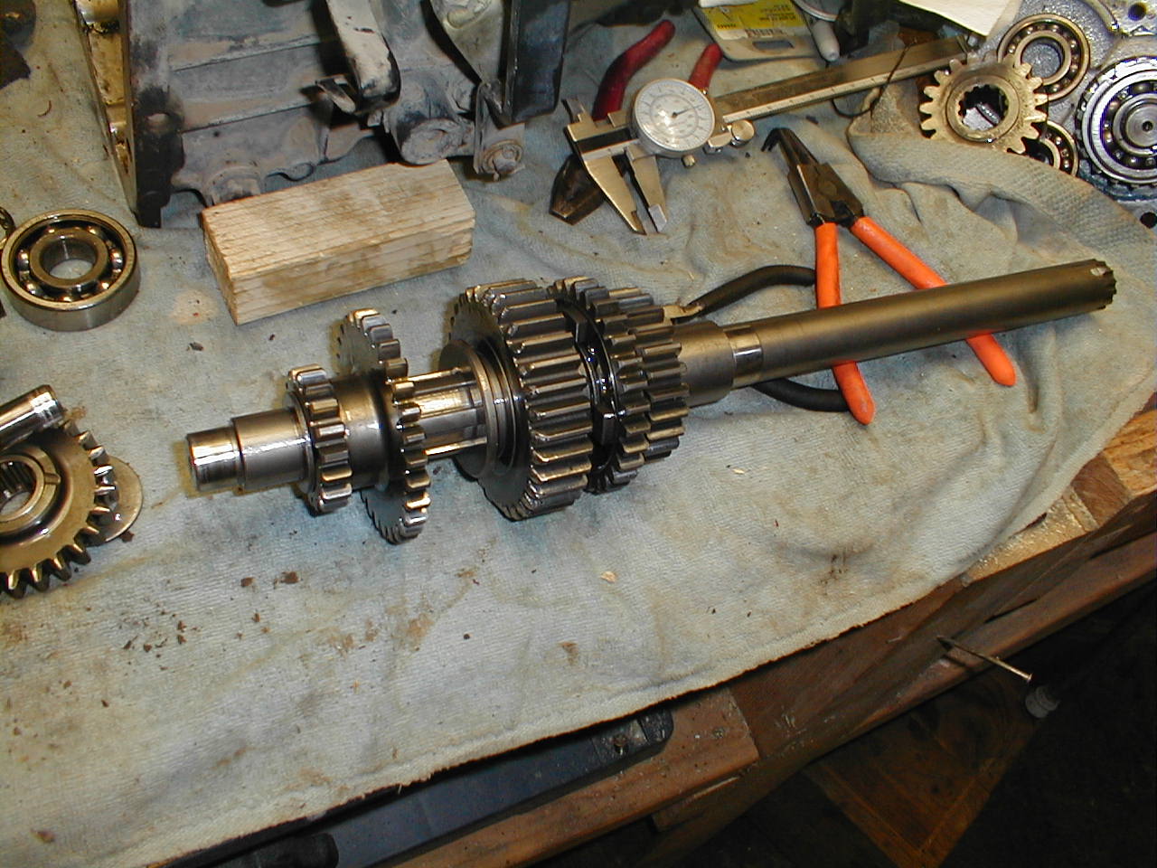

I've attached a few pictures just for fun. The first picture is the old PTO shaft. The second picture is all the rest of the guts of the transmission spilled out on the bench.

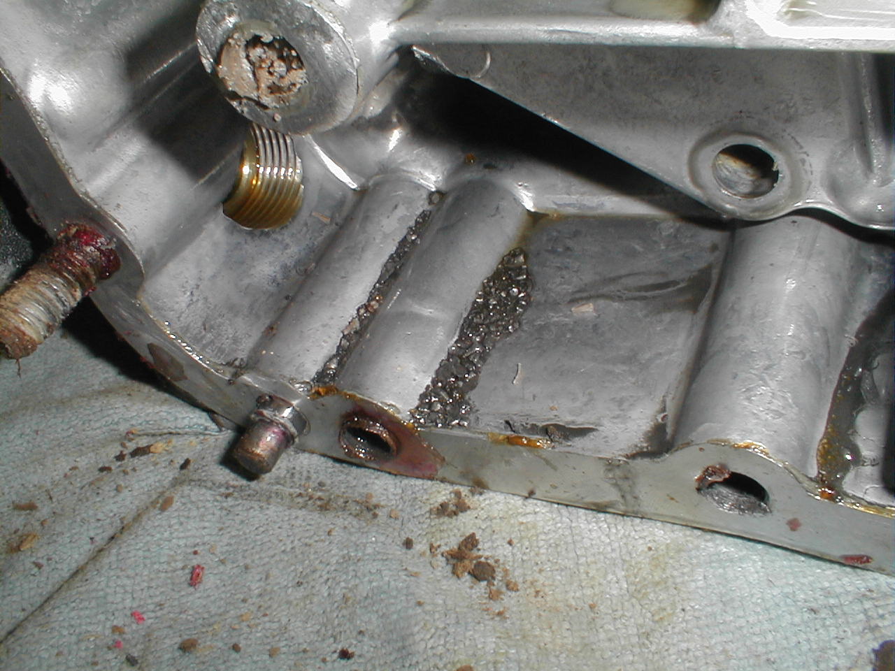

I didn't post this last night, but I got a shot of the sludge of metal pieces that was on the bottom of the transmission housing. This tractor has been used hard.

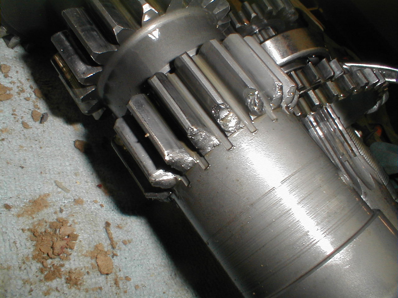

He pointed out to me that the gear had some pretty good wear on the one side of each tooth. Since every thing else goes onto this new shaft fine, I just ordered a new gear. Since the catalog specs that shaft as going to a Massey 1215, hopefully the gear from the same catalog will fit the new shaft.
Having seen the wear on that gear, I decided to check out the other gears in the transmission when I got home. There is one that is really bad. I think that's where the metal sludge came from. I'll call back on Monday and order that gear too. I want to fix anything that I can now so that I don't have to break this tractor down again for a long time
