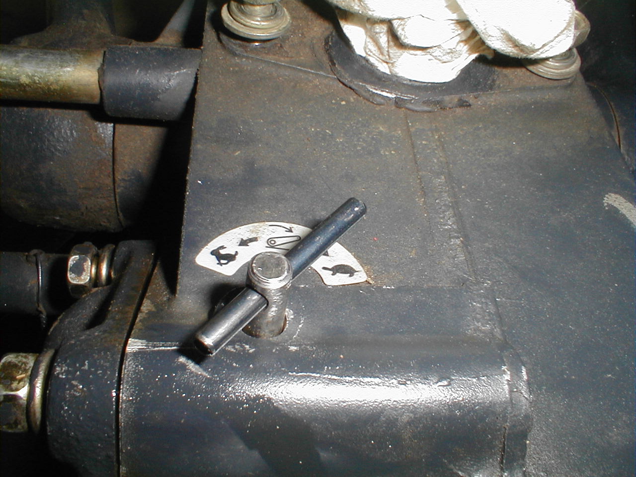

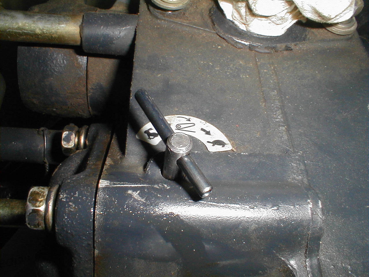

I put the valve back together tonight. See in the pictures that the valve will go to different positions now. If this was the only thing that got fixed throughout this process, It would almost be worth it. The few extra seconds I have to wait every time I lower the landscape rake (much lighter than the box scraper) really add up.
I hope the rest of it goes back together as easily as it did tonight. That has actually always been my strong point. If I can figure out how to get something apart, I can almost always get it back together easier.
The hardest part of tonight was getting the old gasket stuff off the surfaces so that the new stuff could bond right. I finally came in the house and got a plastic spoon. The flat parts of the handle worked pretty good to scrape off the old gasket without marring the metal surface. I used a very thin coat of red RTV for the new gasket.
