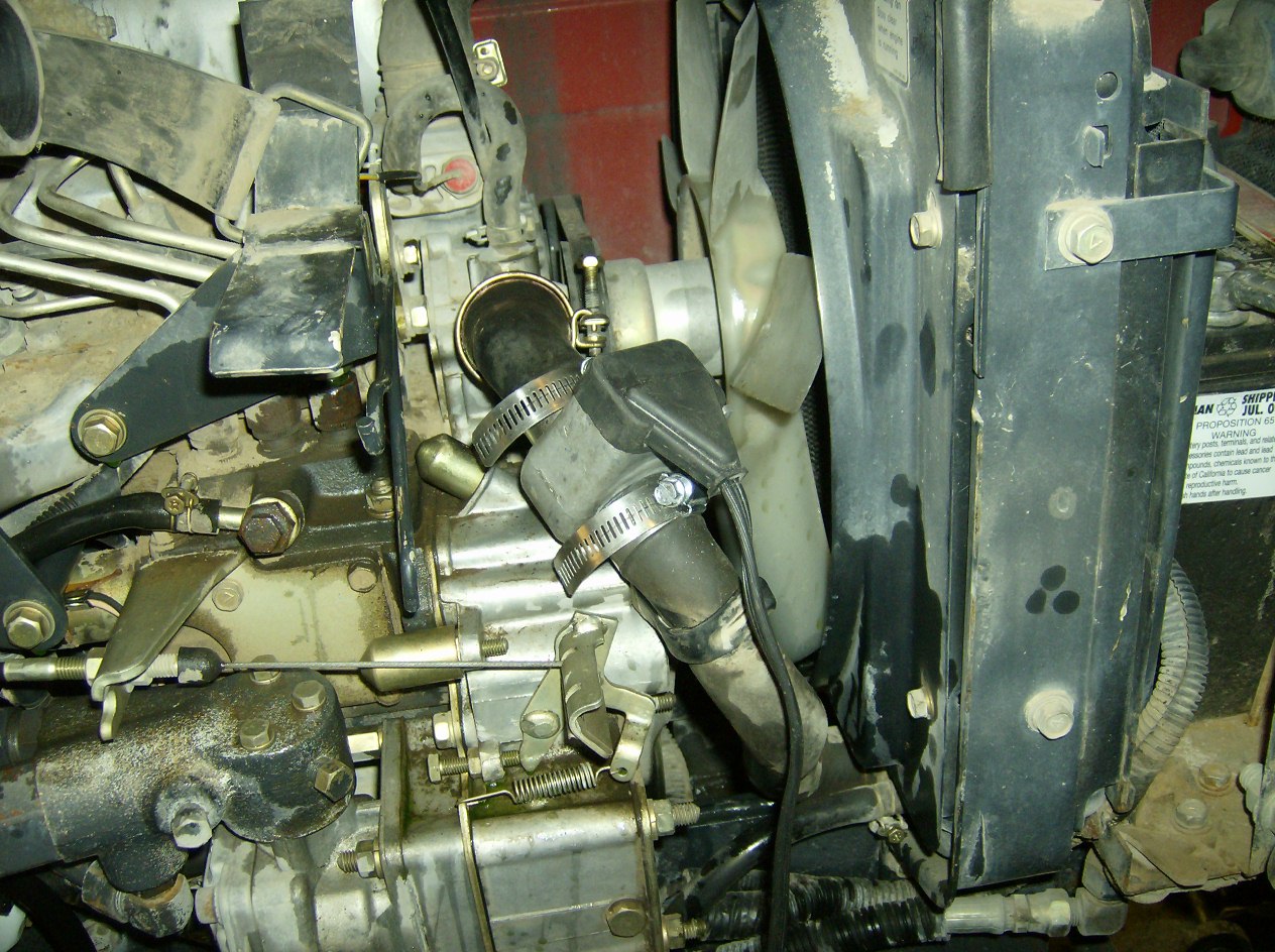

As a post script... I chose to take some time after I had put the tractor all back together to let the gasket material set up real good before I added fluid.
I installed a radiator hose block heater. I had picked this one up at a garage sale a few years back figuring that I'd need it someday. It's a block heater for a Volkswagen. It fit the hose perfectly. I know it's a little higher in the hose than what might be recommended, but that's where it fit the best.
Installing the block heater took about an hour and that was included in my time estimate in my previous post.
