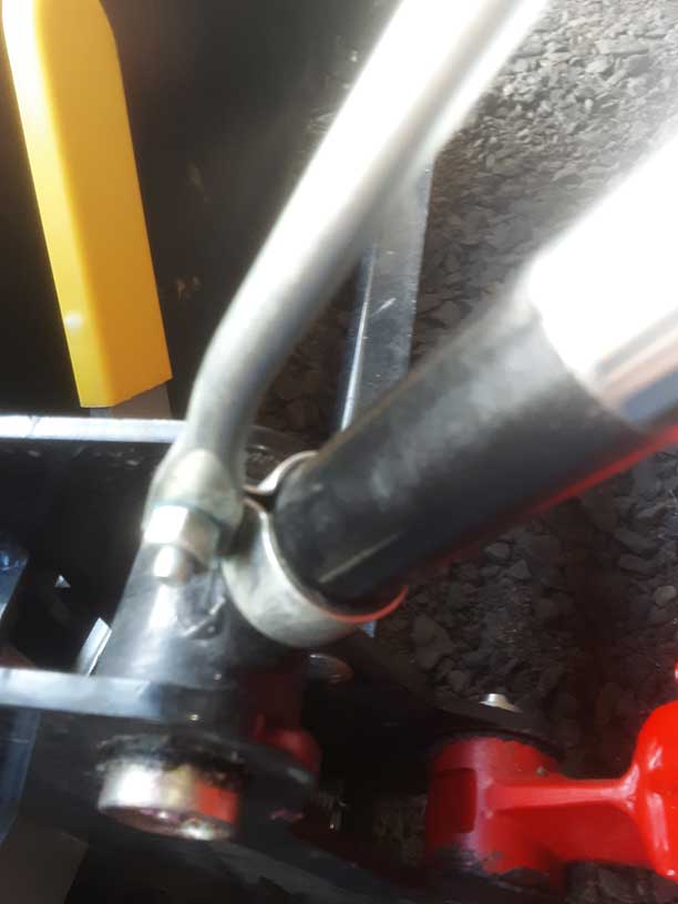

Whatever I end up with it will need to be easily adjustable.
I was wondering about that. I never checked to make sure the bucket ssqa mounting bracket is 90* from the bottom of the bucket. I know whatever set of forks I end up buying will be. It will have to be adjustable or multi-colored.
   / FL1805 Bucket Level Indicator?
#22
Here is a picture of how this one is attached just in case you did not watch the video.
It clamps at the bottom of the piston rod so it is independent of the attachment on the FEL. There is a bushing that allows the rod to move with the clamp tight. The clamp can be move up and down to adjust.
