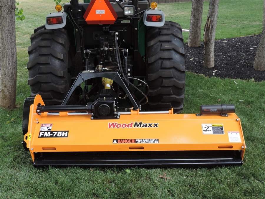

Had my FM62 Woodmaxx since 2017 and it gets used a few times a year. No issues. I got it with Y knives and I mow my lawn with it and cut tall grass and small brush it with. Does striping equal to a baseball field when done right.
Picked mine up right from them and they are very good people to work with!
I run it on a BX2200 too.

I purchased the woodsmaxx 62 couple years ago
So far great behind our B2601
Have the Y blades

Personally Betstco and Woodmaxx will be your best choice for parts.
I went with Woodmaxx because if I got in a true bind, I could load it onto my trailer and take it over to their facility and they can repair it at my cost.
