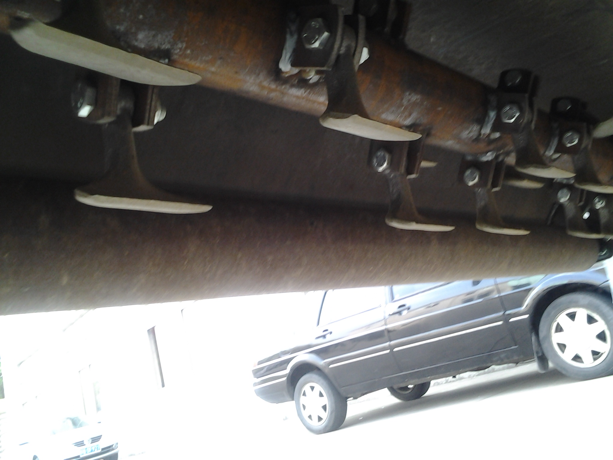

generally, different blade can make very big different effect.
View attachment 347141View attachment 347142
for example, the second blade in the first photo, it is small H blade, and the first blade in the second photo, it is also small blade. BUT, because of different material, the second one's price is double as the first. After testing and compare with both of them, the second blade is much better than the first one.
BUT, till now, now customer would like to buy the second blade, because of its price.
By the way, you can find your blade in the first photo.
Thanks for the pics. I believe the 2nd blade in the first photo is the hammer blades I purchased optionally as they were what Betsco was selling and I had no experience... I have not tried them yet as I see no reason it will mulch leaves any better. But I guess I should go ahead and replace them as the current Y blades do nothing to leaves. May change them out tomorrow morning.

I think till now, the only way for you to get these blade is directly buying from my factory in Chinese. Because of its expensive price, none of my customer buy this model blade till now.
Here are photo which I took when we test this blade, you can see, it have a much sharper blade than the H blade which you are using now.

I think till now, the only way for you to get these blade is directly buying from my factory in Chinese. Because of its expensive price, none of my customer buy this model blade till now. <img src="http://www.tractorbynet.com/forums/attachment.php?attachmentid=347147"/><img src="http://www.tractorbynet.com/forums/attachment.php?attachmentid=347148"/> Here are photo which I took when we test this blade, you can see, it have a much sharper blade than the H blade which you are using now.
Yep, that's interesting and looks like it could be sharpened. Hope they become available.
