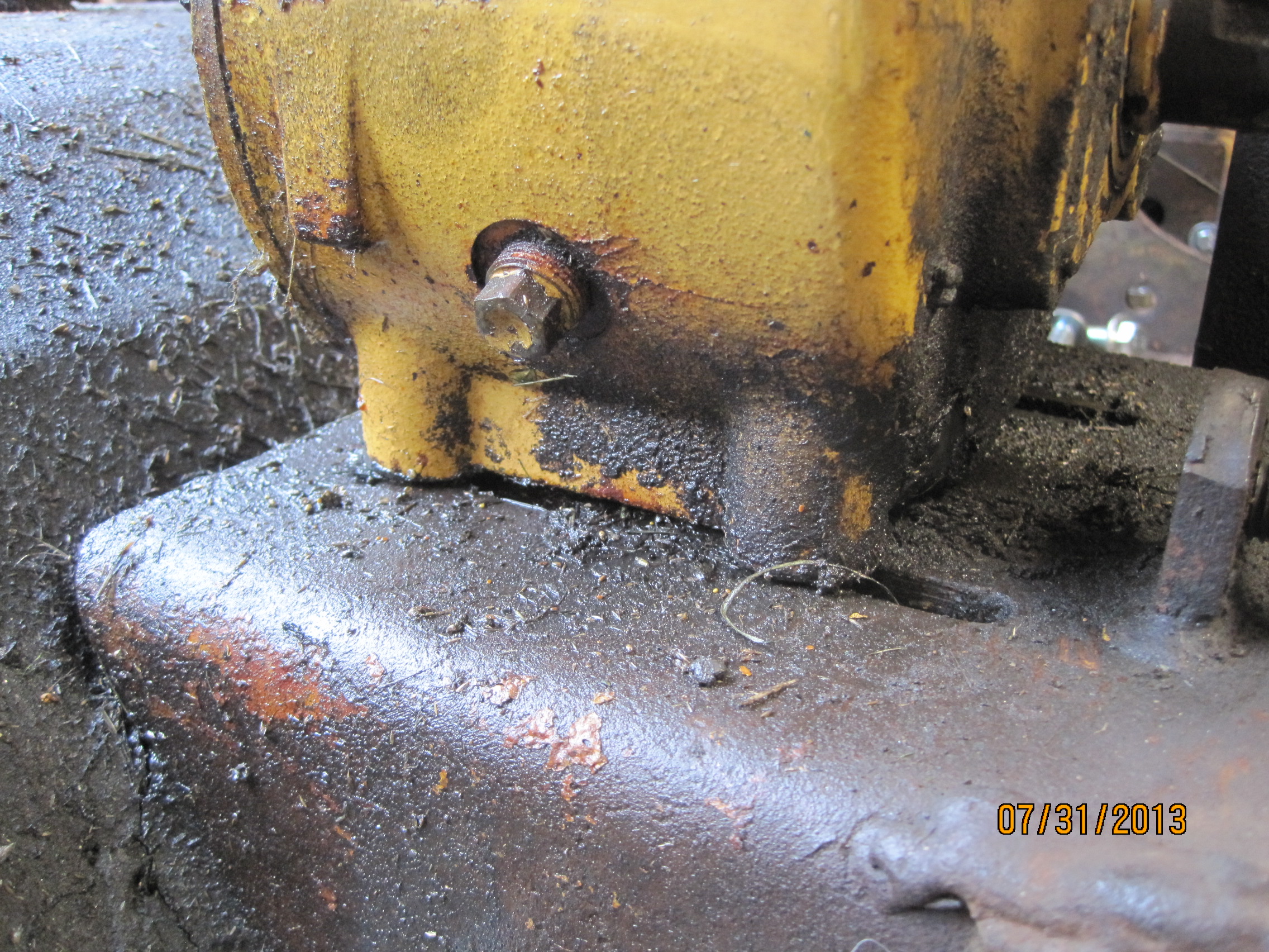

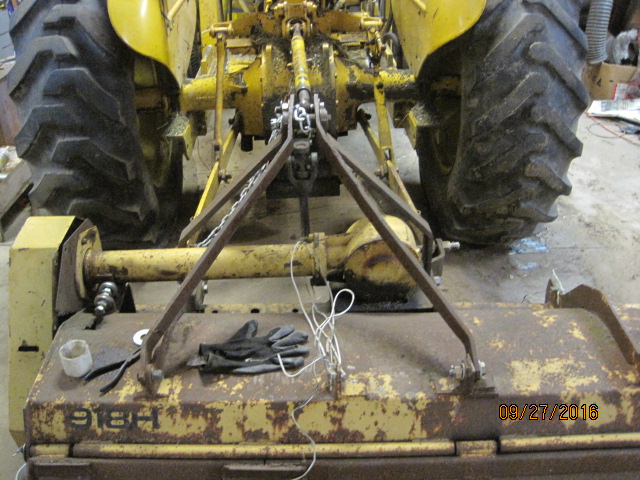

Gear box keeps loosening in spite of lock-washers and or red thread loc. All the heavy duty tines are in place and the flailer appears balanced but there is tremendous vibration.
Anything I am not doing ???

If it's vibrating badly, something is unbalanced or bent & those vibrations are causing things to come loose. Have you checked to see if the rotor it self got bent at some point. Generally that totals the impliment as the are over $1k + shipping to replace.
/ Flailer/Mower Ford 918H #3
Yep, something is bent if all parts are in place and properly functioning. It doesn't take much. Mine has 33 knives and if I lose one I immediately know it.
/ Flailer/Mower Ford 918H #4
Bent rotor, bent driveshaft, universal joint failing you definitely have a turning part failing
