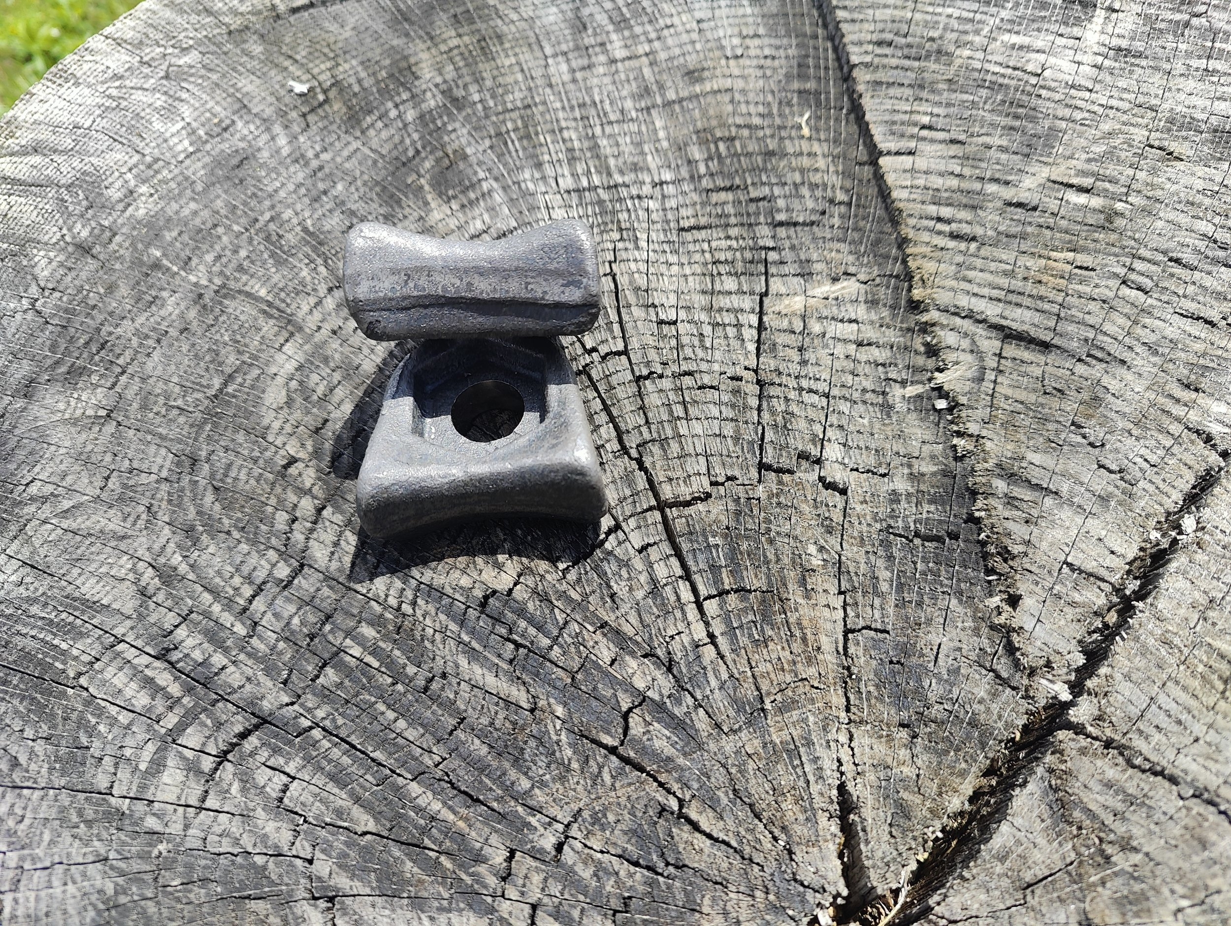

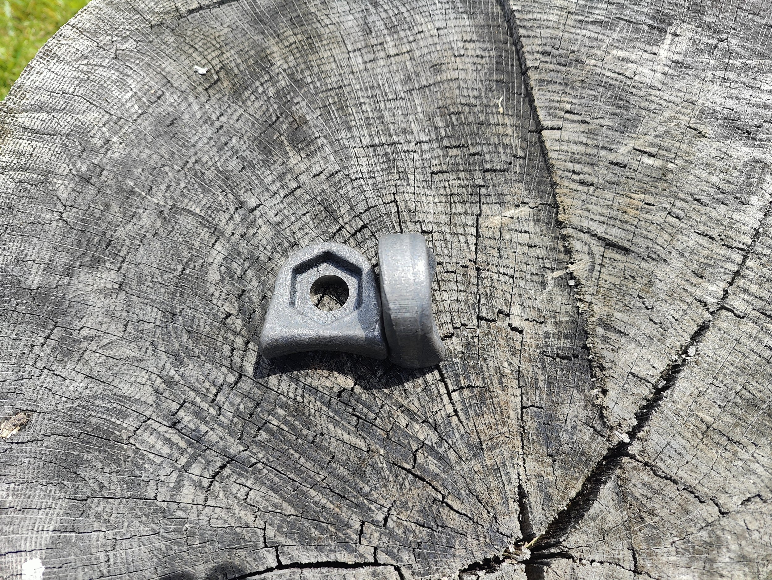

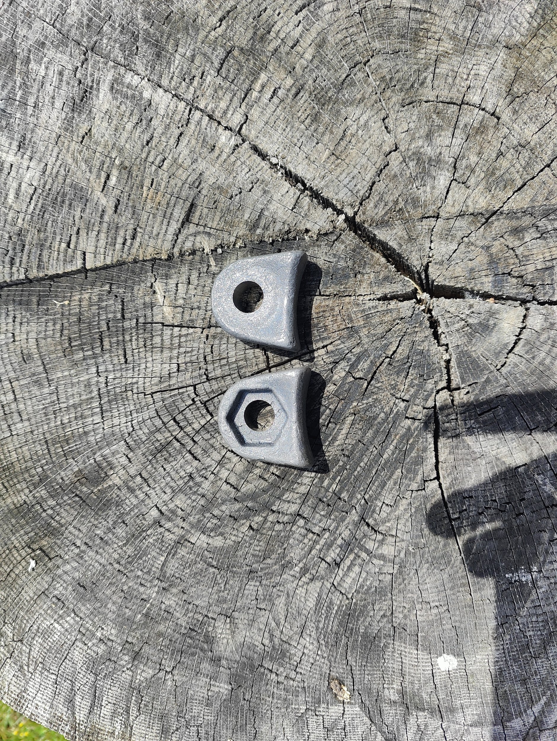

Hey Doug, the hammer ears as you called them have a recess on one side for the bolt head to fit in. I put them on by hand until I had to use a tool, and mostly used an impact to tighten. You can see in one of the recent pics that the bolt head is recessed into the ear. That held the bolt and kept it from turning when tightening the nut. Worse case scenario you will have to weld the nut to the bolt

Hey Doug, here are some of the dog ears that I have. These are from SEPPI...
Yep, that's what mine look like. Now the hard work...removing the old ones.
