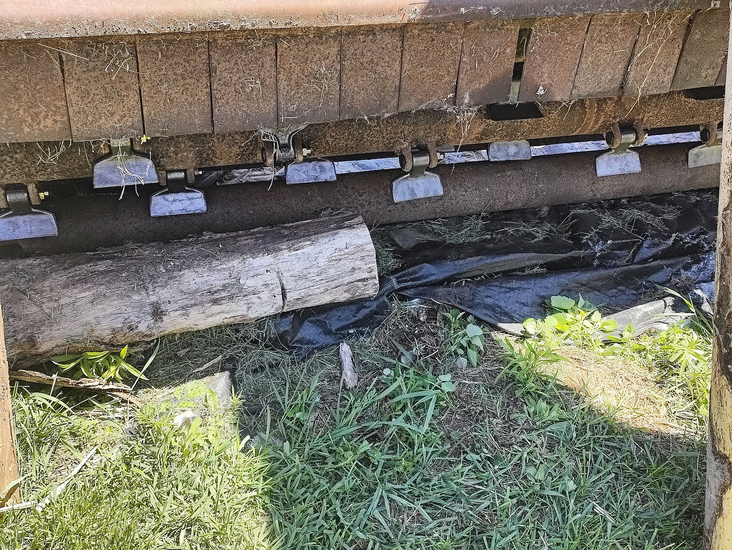

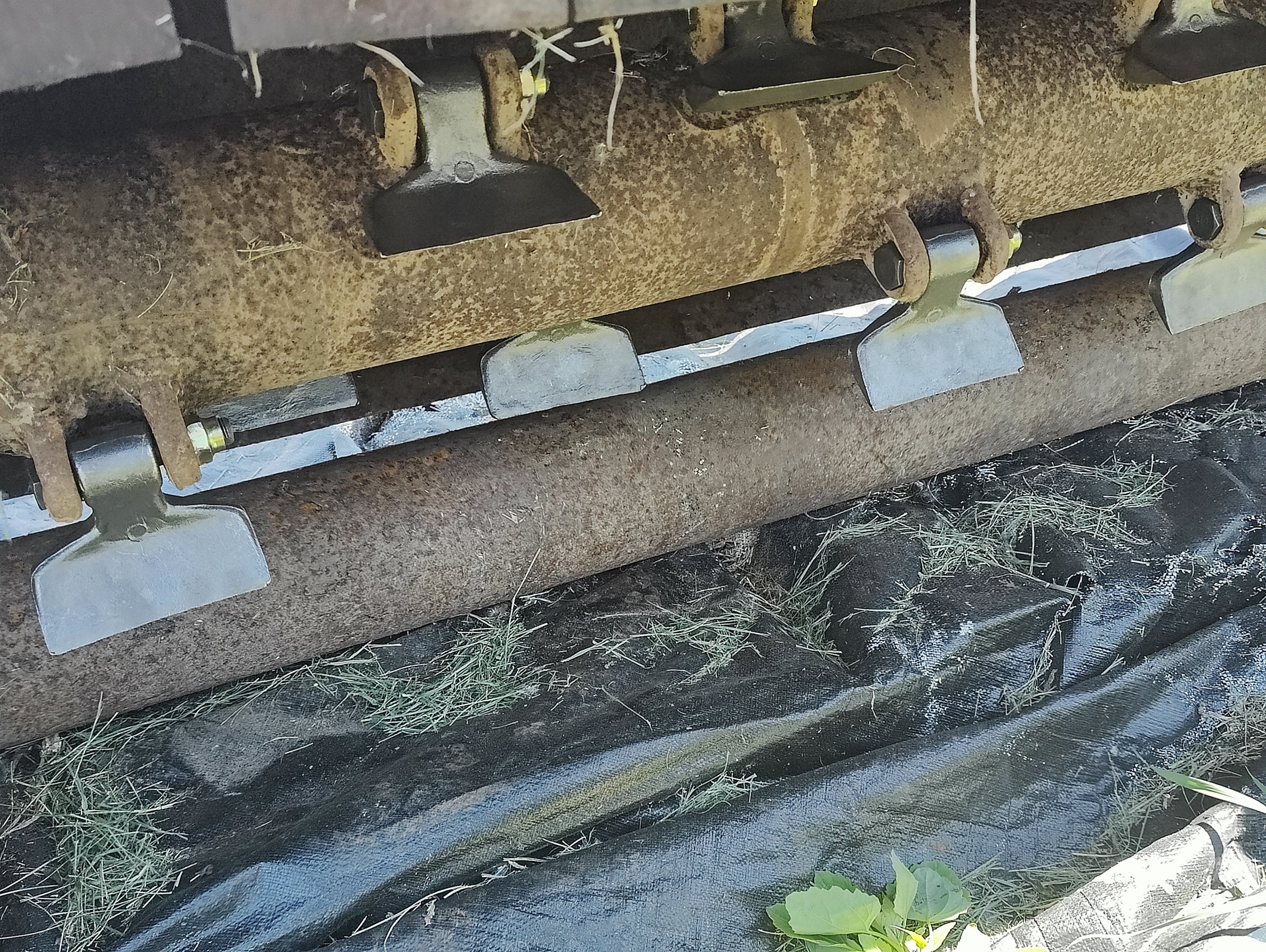

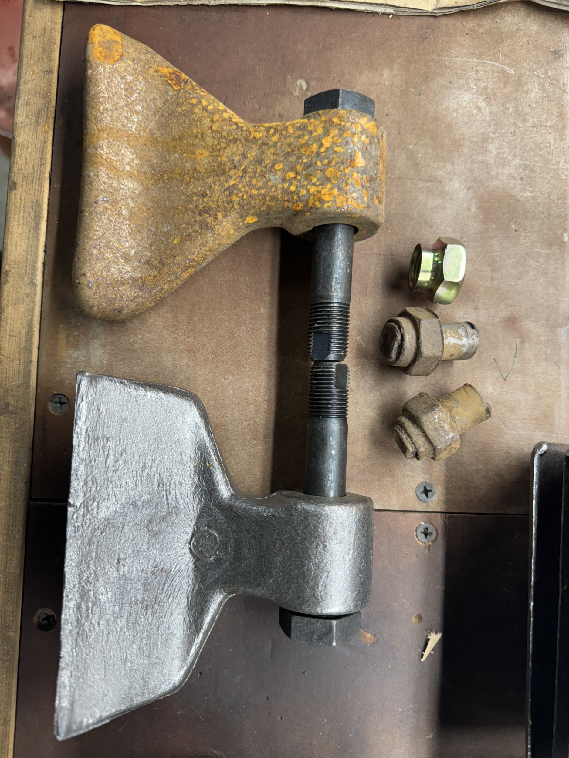

Wow, you are getting after it! here are a couple photos of the SMW hammer. After market from Clean Cutter Tiller Blades. item name MAZ07. Here is a picture of the SMW hammer front and back.
Ha! Your first sentence are the exact words my brother in law used:ROFLMAO:.
Apparently the existing hammers on this machine are not original equipment.

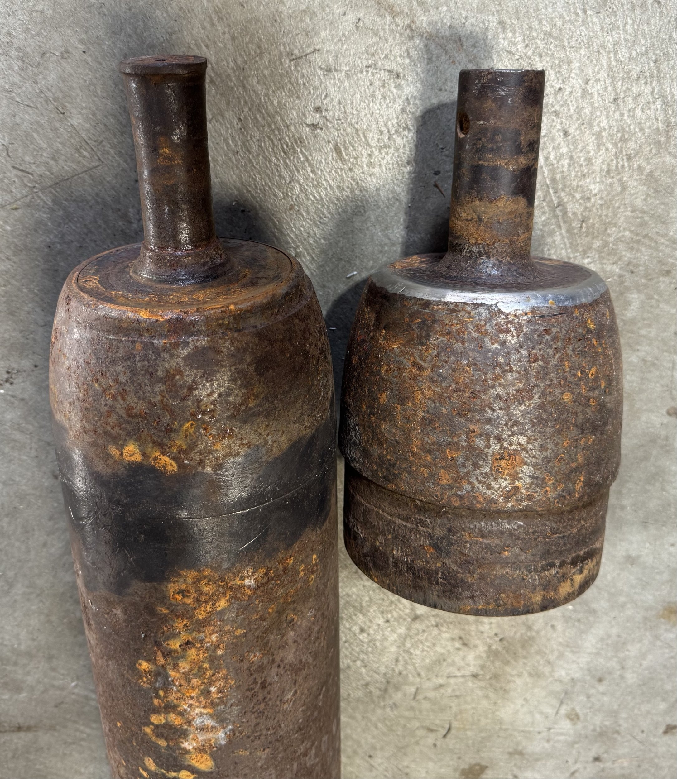

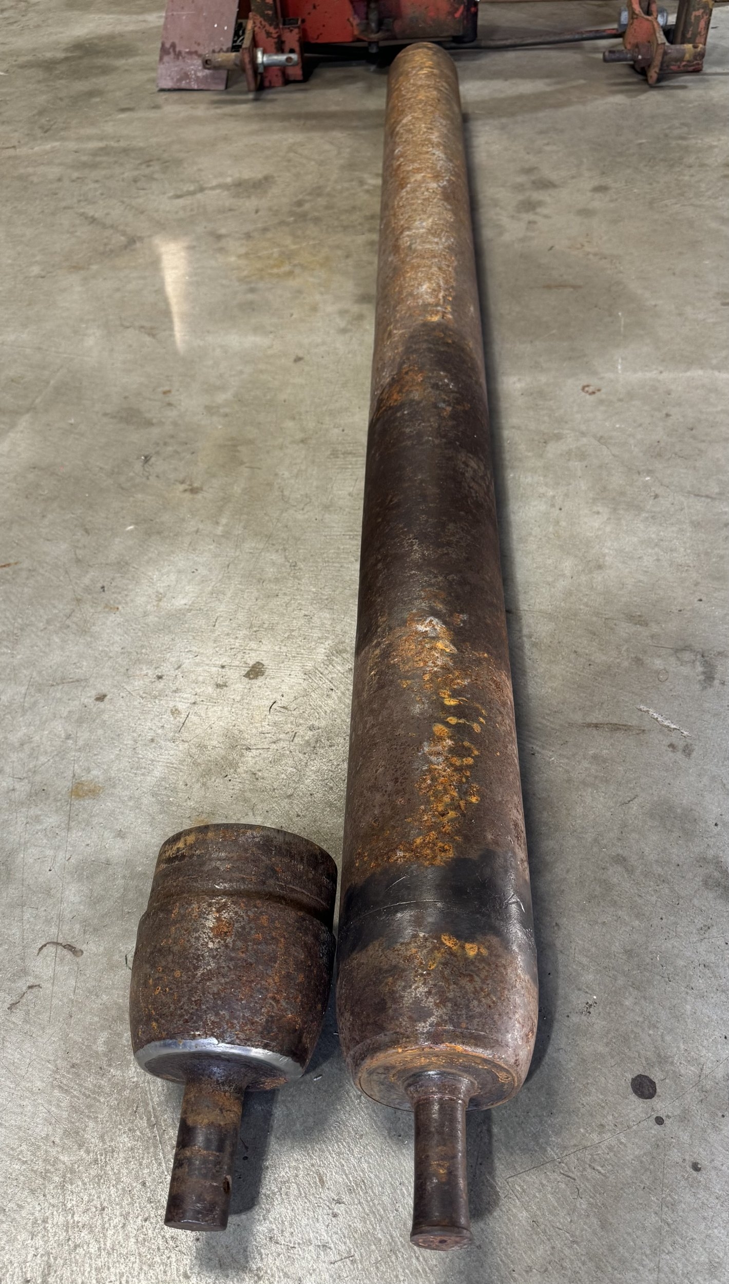

I was able to remove the roller yesterday. The end cap with the good stub shaft that was askew in the last pictures came off without too much of an issue. The end with the bad stub shaft is another story. It appears is was rubbing so long on the end cap, that the joint between the stub shaft and the rest of the end cap is not whole. I tried tapping down on that stub to see if the end cap would come loose like the other end...no cigar, stub hub broke loose from the end cap.
There are no separate parts listed for the end caps/stub shafts, so I am assuming it will need a machine shop rebuild OR an entirely new complete roller. $$$$

I did note that there are two roller assemblies listed in the manual. One is described as "prior production". Mine looks like the prior production part. The roller support brackets appear to be different between the two iterations of the roller. So, if I can't have the roller repaired, I guess I am stuck with an all new roller assembly, with brackets, bearings, etc.

Yesterday Pape got back to me with a parts order quote. Bad news about the roller. The bearing supports, and bearings are no longer available for use with the old roller (once repaired, if possible). The complete, current style replacement roller assembly would be $3K, shipped from Italy (half is the assembly, the other half is shipping).
I will contact a couple of shops next week to see what might be possible in regard to repair/rebuild of the existing roller. If that is possible (depending on cost), I will need to source some sort of bearing replacements, and the inner bearing supports, called a "labyrinth" on the parts breakdown.

This project is moving, albeit slowly.
I was able to have the roller rehabilitated. A prior owner had changed the bearing setup on it and now I know why. It was not feasible, at least for me, to go with all Seppi parts. The bearings are both grease-able Timken bearings in Timken pillow blocks. A local machine shop did the shaft repairs and re-welded the end caps to the pipe.
I was able to get all the worn out hammers off the rotor. Some I had to cut off, but many of the nuts threaded off. My shoulders and hands were sore for a couple of days after, but it is done. New hammers and bolts are ordered from Flail Master and should be here mid to late June.
