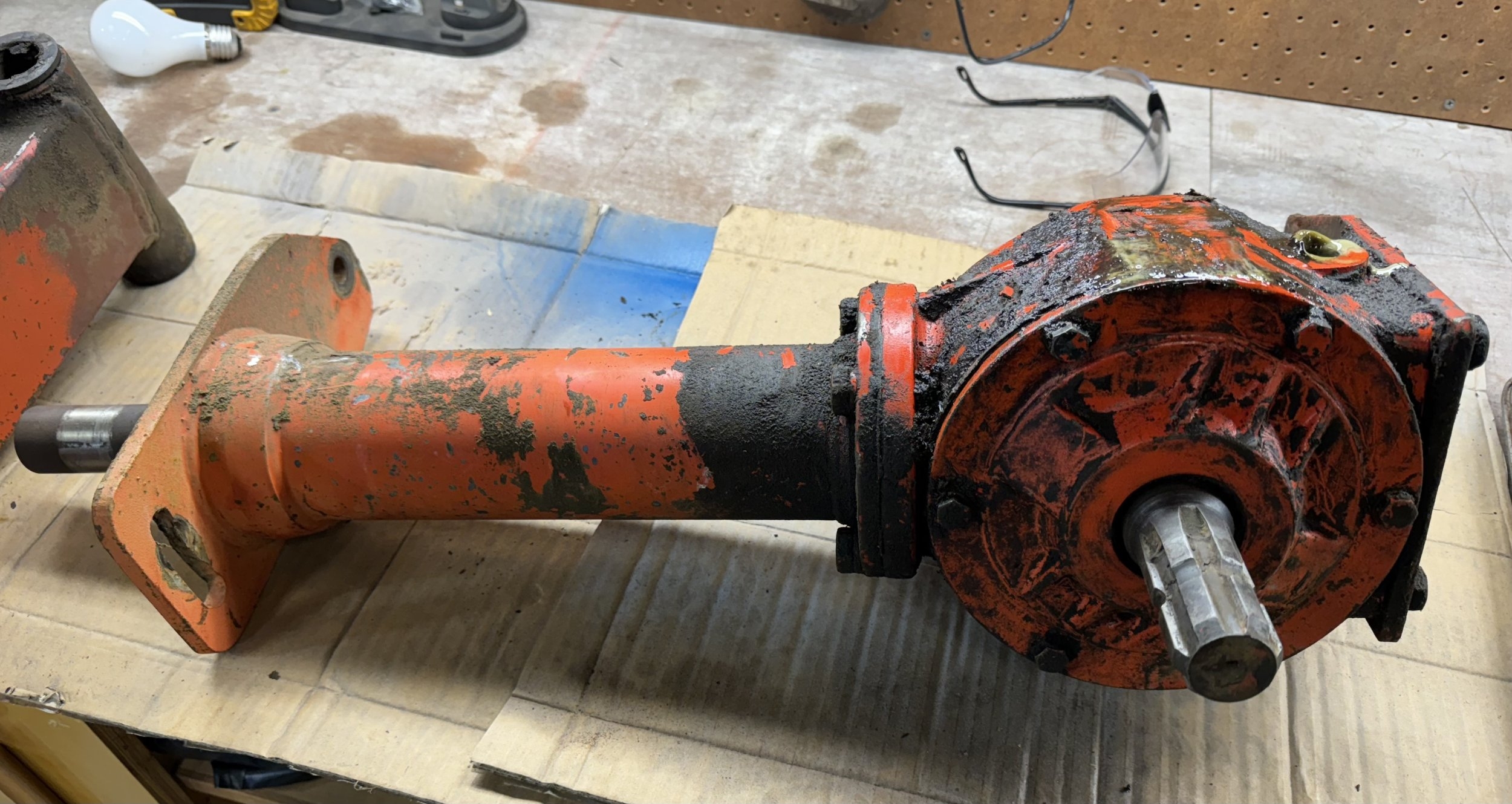

It looks like a spoke too soon concerning the gearbox input shaft seal. It is leaking. Not terribly bad, but it is leaking. This is a pic of the front of the gearbox right after I bought the machine:
Has anyone here ever changed a seal on a gearbox such as this?
It looks like once the front cover is removed, parts 5-29 will come out of the housing. Then slide the seal (part #5) off the shaft and then slide the new seal back on. Am I seeing this right?
Thanks for your time,
Doug
Hello Doug,
I replaced the input shaft seal on my old Ford 917L flail mower about four years ago when I bought it.
I have used 80W-90 gear oil since and it has not leaked at all - the shaft surface was in pretty good shape.

Gearbox is open. I measured the shaft with calipers. It is 72 mm on the nose. I ordered a new seal which should be here mid next week. If I have time during our bathroom remodel project, I will get it installed next week.

The seal replacement went well. A couple days later I took the mower out and mulched some garden materials. I ran it for 10 or 15 minutes. The next day I checked the input shaft seal and it is nice and dry. Unfortunately, the output shaft seal is wet, where it was dry after my initial 4 hour mow...I should have known that would be the case.
The horizontal output shaft housing design is dry- there is a seal on the gearbox end of the output shaft housing to keep oil in the gearbox. The other end, the sheave end, has a zerk fitting, with a seal on the sheave end of the output shaft housing. I bought both of those seals.
Now I can get more practice removing and reinstalling the gearbox. It's not all bad, dumping the gearbox oil will be good to flush out remaining contaminates.

I removed the gearbox and separated the output shaft housing from the gearbox housing. The output housing sleeves into the gearbox housing with a slight taped fit, and has an O-ring groove machined in it. The O-ring is shown in the parts diagram. There is also what the parts breakdown describes as a "gasket" between the mating surface flanges of each housing. When I opened up the joint, the O-ring was non-existent and the "gasket" was only half there.
I bought seals for each end of the output housing so I would have them when I had a chance to tear into this. As I was observing how the pinion gear and the bearing are located all on the gearbox side of the output shaft seal, I came to the realization that the output shaft seal would not seal the mating joint from leakage, it would prevent gear oil from migrating into the output shaft housing tube. The bearing on the sheave end of the output shaft is lubricated by a zerk fitting and has it's own seal, so the output shaft housing tube is to be dry inside, which is how I understood it to be. I do not think there is any reason to further disassemble the output shaft assembly, as there is no evidence that they are leaking. It appears that the O-ring is the seal between the gearbox housing and the output shaft housing joint where the current leak is evident.
I took the gasket to one of the local heavy truck repair shops to see if I could procure some gasket material to make a new gasket. The shop foreman looked at the piece that I had to match up and he told me that it is not an oil seal gasket. Due to the mating of the ring and pinion gears within the gearbox, he said that it is a shim. He measured it with a precision caliper and it measured .011".
The "gasket" appears to be metallic, but it was non-magnetic, so I was thinking that it might be aluminum or brass or...? I have done some searching on McMaster-Carr and have not found anything that measures .011". The closest I can get is .010, with the option of stacking a .001" layer with it. The truck shop foreman told me that he has used paper in a pinch.
I guess I will check with the machine shop that has helped me on the mower and see if they have any material or ideas for me. And if anyone has any bright ideas to share, I'm open to hearing them.

Buy the sheet gaskets from Mcmaster-Carr.
   / New to Me- Seppi SMO 200 Flail Mower
#49
Just to follow up. Made the shim/gaskets (from McMaster-Carr) and reassembled the gearbox/output shaft. I filled the gearbox on the bench and let it sit there a couple of days before I remounted the assembly on the mower. So far the o-ring seal is working...though not under much stress, just sitting there with cold 80/90 weight in it. We'll see how it does this spring.
