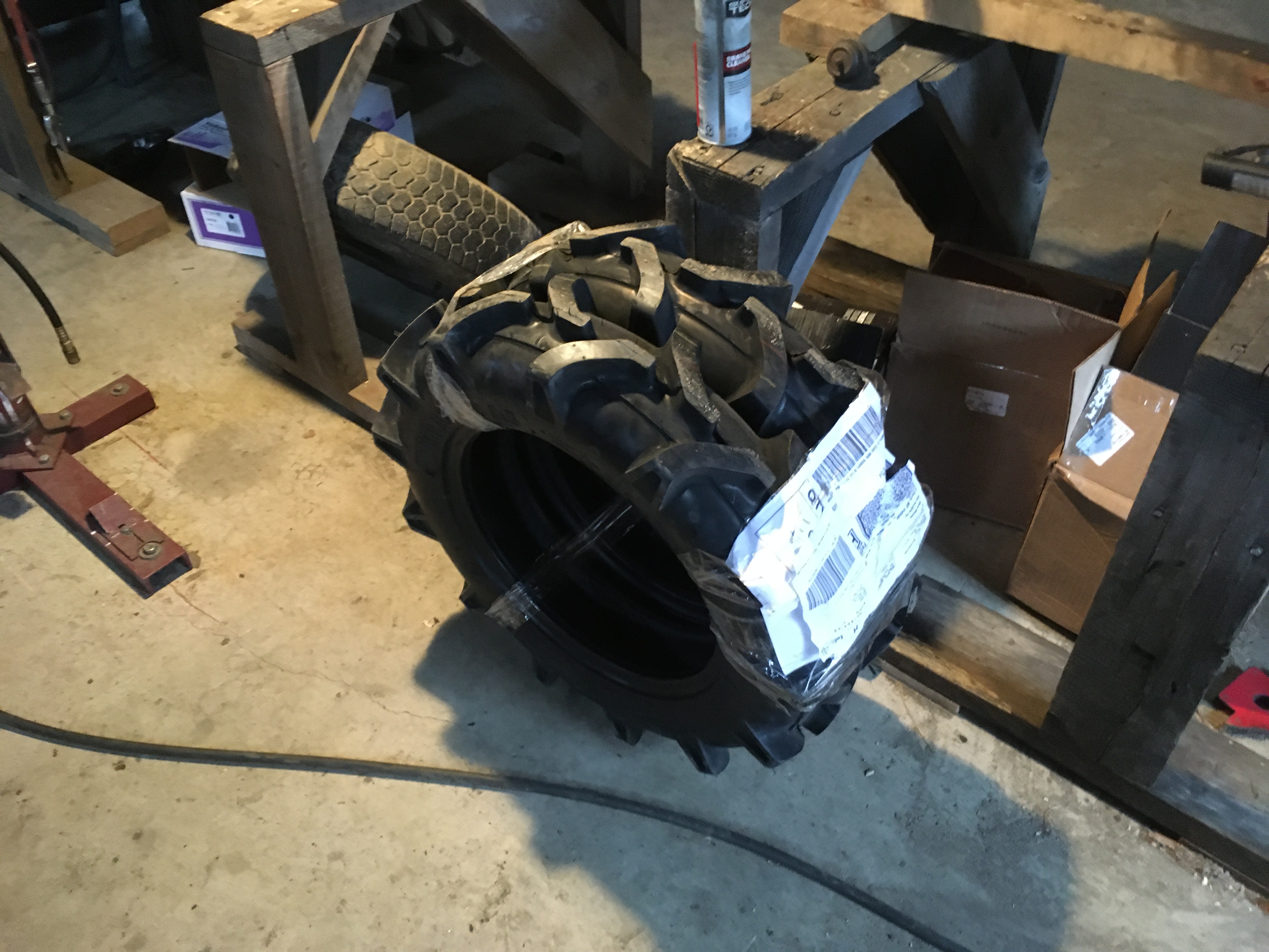

My fronts are 7-16 and rears are 11.2-24. Trying to macth up R4s might be possible I dont know, but it's going to take some tape measure work and then the rims match, it sure would be easier if someone already done this on their L3400 and I could just do what they did, but the tractor place said it cant be done. I have some 40 year old V bar tire chains somewhere

:thumbsup: Thanks for the link I couldn't find a place that sold them clip things, I'll order them sometime soon just to keep them on hand for the next time, oh I'm quite sure they'l be a next time.
My new $150.00 tires showed up today so I'll put them on this weekend. I ordered them Sunday night so they got here quick I thought.
