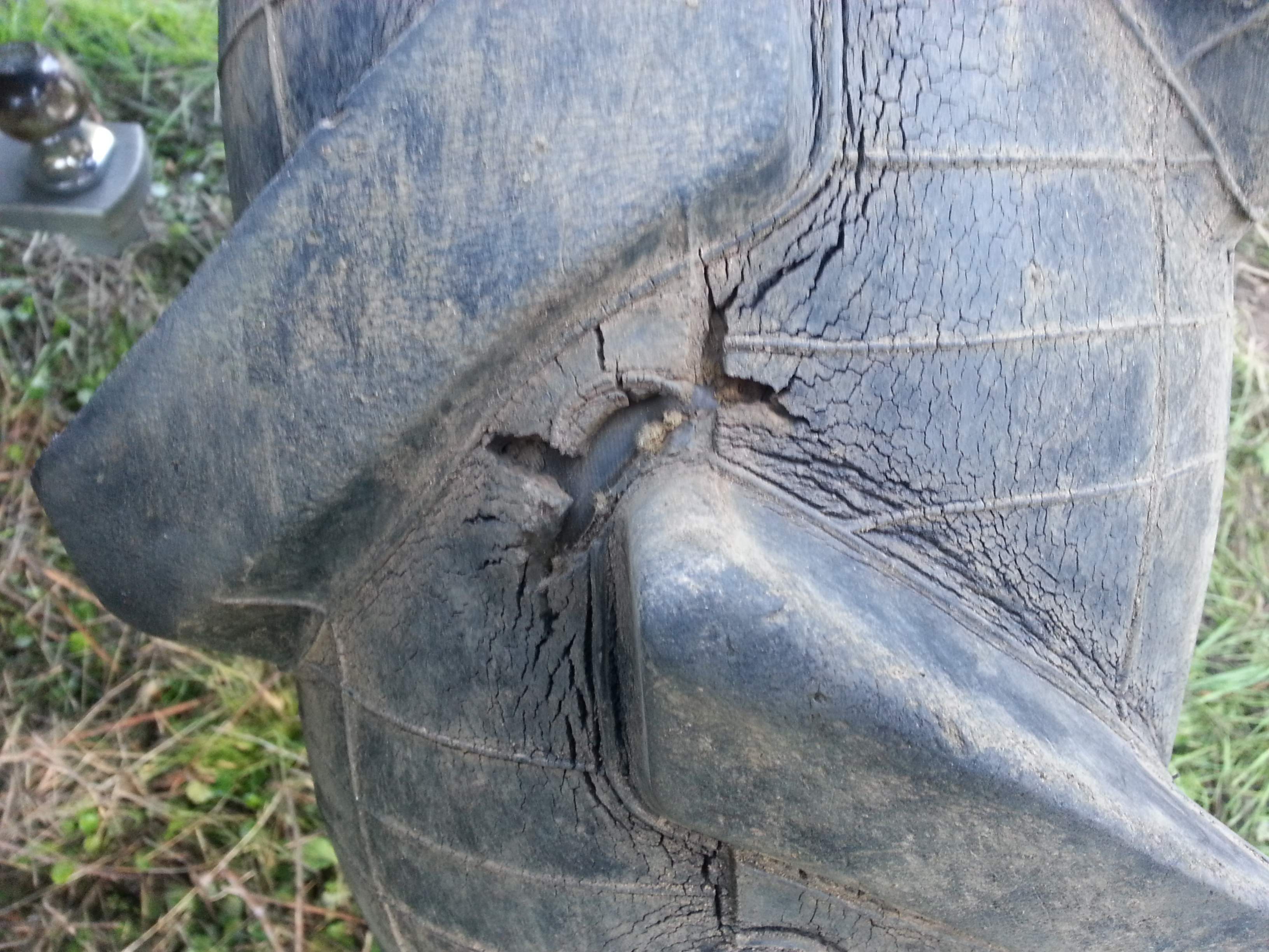

I'll bet Sound Guy's 8n and 2N have weather checking you would not believe. my step-brother has had a 9N for 30 years that had checked tires when he got it, probably original, about 60 years. They are still running.
i have a 951 that the tires are literally disintegrating. I just don't run it in anything but pasture.. so a blowout is no issue.
yep. I don't know what I'd do if I had a tractor tire that was NOT checked.. :)

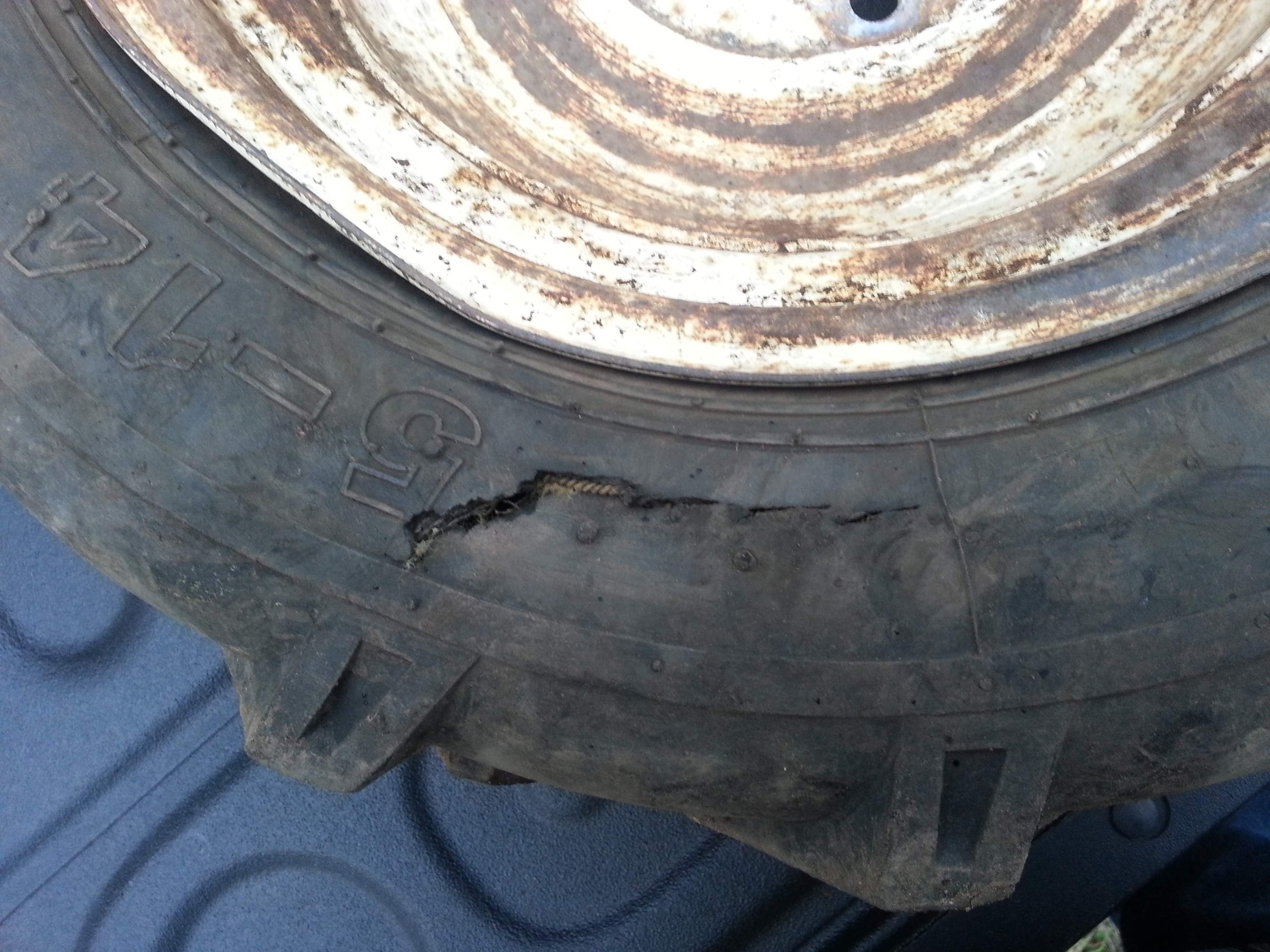

Just an update that I got the tube fixed, and had to take the wheel to a small independent shop to air it up. It does need to be replaced. There's a blowout the size of a silver dollar in the center of the tread, and the rubber is rotten. I am going to replace both rears fairly soon. I wouldn't mind starting with new tires. 20131029_150534.jpg

The way some talk. They would run that tire with a boot in it. I sure wouldn't. I go places where, I don't want to be changing a flat tire if I can help it. The way my property is, I would be asking for trouble using that tire

my old tires were like that, after having the first flat I replaced it with a used but still was dry-rotted tire, this is when I realize how thin made the tires for our CUTS are, I suppose no heavier than our tractors are they didn't feel like the tires needed to be heavy duty, No comparison to the tires on Heavier Duty larger farm tractors,

Well, not good. I just blew, and I mean BLEW my left front tire! Man, this stinks. I did notice a "Made in China" logo on the side. This tire will have to be replaced as I doubt any tire place will deal with it. The rim is bent, too. I happened to run over a stick which punctured it. Are there any stronger tires?

I would like to find a way to repair the front tire. I don't want to risk ruining new tires with all the branches and things laying around. I am surprised that the front blew out like it did.

Looks like a R1 front, so I assume its 4wd. If it is, get to make sure whatever you replace with is same size rolling circumference.
Hoyetractor has your front for $99, BUT says "this tire is an inferior Chinese tire, and you can expect several years of life from it, but expect weather cracking with in weeks"
If money is tight (when isn't it?) perhaps look for a 14" "donut" spare at a junk yard. Unless you match the overall height do NOT use it in 4wd. Im guessing a junk yard might have hundreds of donut tires, and although it might not be a permanent fix, it should get you working again.
When it comes time that you have a spare $1000, consider looking for a full set of 8 ply tires. Although they are more money, they are far tougher the the 4 plys you probably have now (which are about same load capacity as a passenger car tire)
Looks like 165/80r14 tire would be very close match, if you could find such a thing. Or a 185/70r14, might be a bit harder to get on rim (wider tire, same height) but this is a small standard equipment car tire, and any local used tire guy might have one laying in back yard.
