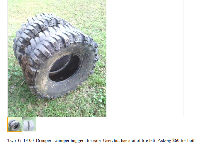

I once thought of getting some 10"wide Chevy 6 lug 15" or 16" rims, ( think someone said were same bolt pattern) and get a aggressive 36"-38's mud tires to put on the rear, would be approx the same diameter, although the rims would have to need a offset in order to clear the fenders,
These truck tires look like could be used on a tractor,
