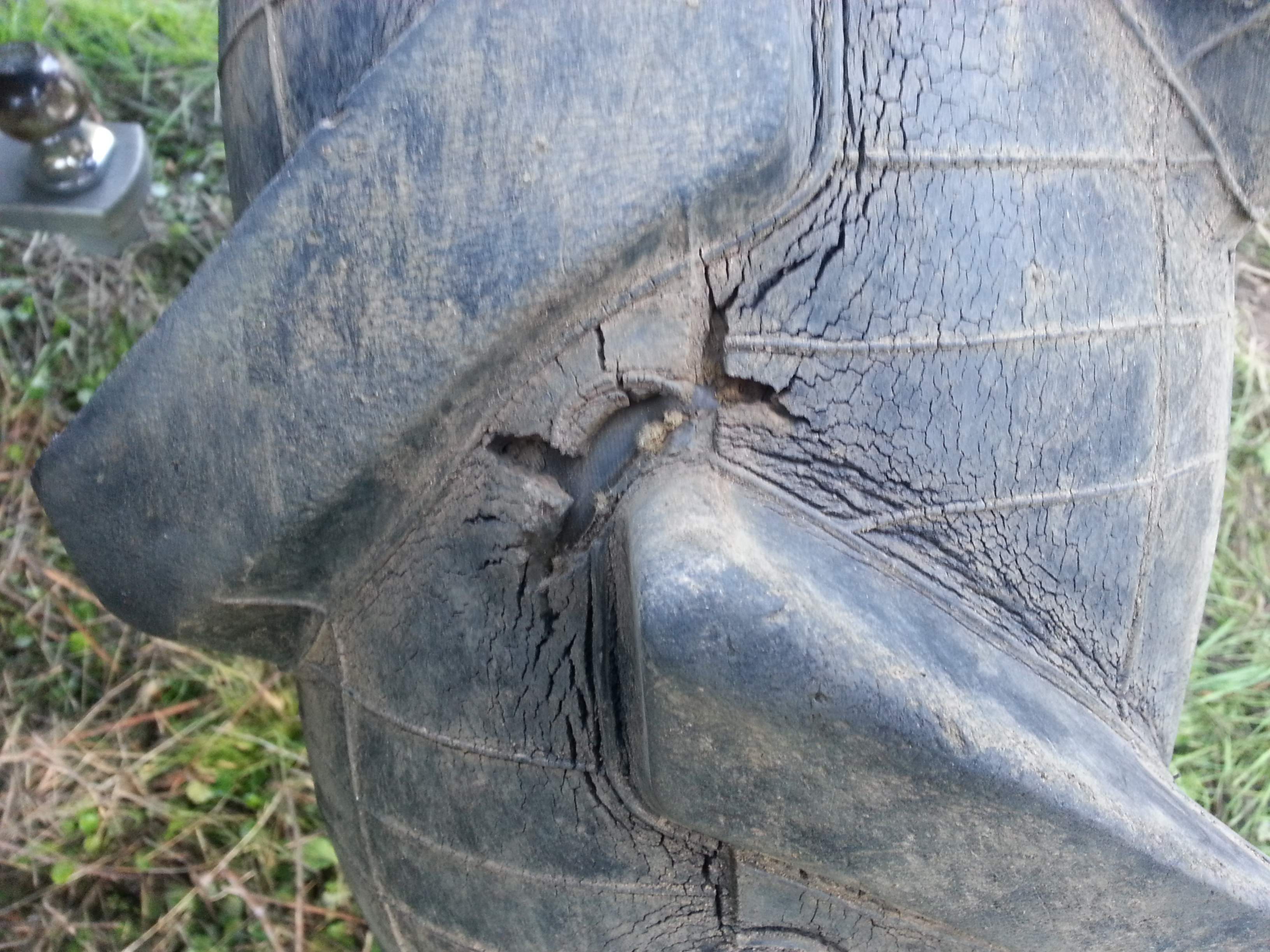

Well, I got my 5th flat tire today. I can't take it anymore. This is the right rear which has never been flat. So, both fronts went flat, one twice, and both rears have been flat. And, I'm not running over anything sharp that I know of. I'm at my wits end. I've NEVER had such a horrible time with flats in my life. The nearest tire shop is LESS Schwab where I bought my front tires, and I don't care for them.

Yeah, they have tubes. I don't know where the puncture is as I can't see it. And when I take the tires in to Les Schwab they try to tell me that they cannot work on them because they have weather checking and they want me to buy new rears. I already bought the fronts from them. It's just annoying to deal with them.
On edit it looks like the right rear is the same one that was flat before. I've lost track this has been going on so long. Thinking of just buying some new rear tires now.

My run of bad tire luck convinced me to have my tires foam filled... not cheap
On the plus side, there is no way it can ever be flat and I picked up a little weight down low to help with stability.
