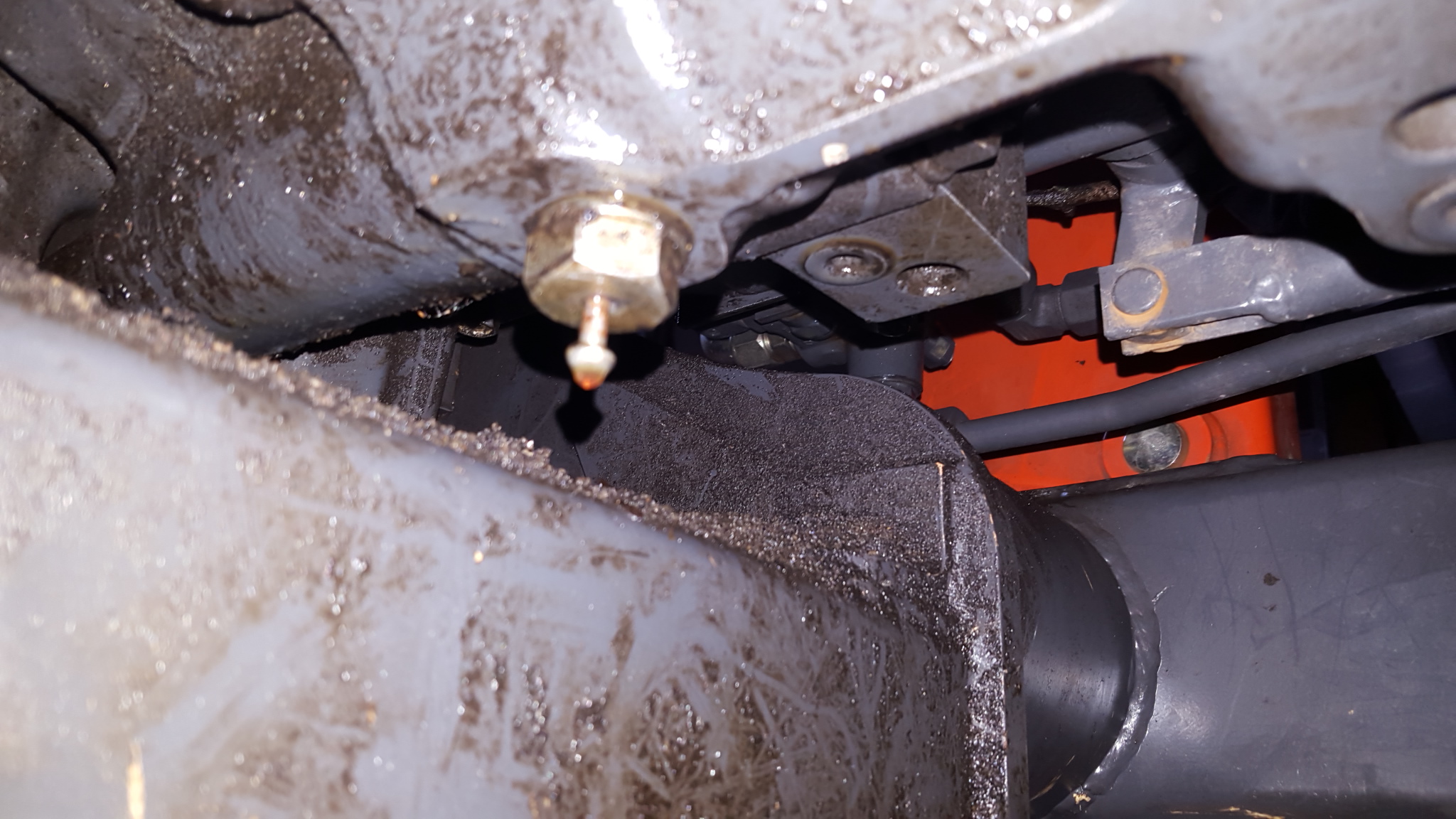

Got the injectors back from the shop...she is purring like a kitten. No smoke, sounds great. As for doing a total break down...I took a long hard look at those cylinders. Other than some normal discoloration for a machine with 450 hrs, they were perfect. They all came to exactly top dead center. I seen a engine with a bent rod and that piston was almost a half inch from top center. If those cylinders were even a .01" off. I would be breaking it down, but has of now everything seems good. I still may break it down before spring, because a still have to address that hydraulic fluid leak which requires me to break it in have. The fluid is leaking out of that drain nut on the bottom of what i guess would bethe drive shaft housing. The dealership said it sounds like the main seal. I would also like to thank everyone for there input. suppose to hit 60 tomorrow, so i'm gone to take it out and put a couple hours on it to see what it does...lets just hope we don't give soundguy a reason to say "I told you so" Lol.
