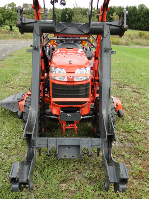

On the grand Lxx10 machines (and L48) Kub moved the front drive shaft inside. It's located at the bottom, well below the crank main seal. There have been posts about leaks where it comes into the clutch housing from the trans.
Unless it's leaking a flood, I'd fabricate an outside catch tray below the drain fitting to hold some high-absorbency sheets. My home-heating oil delivery guy uses them - they soak up a LOT of oil. It could run that way til you have full confidence in the engine? Just a thought. At $20/gal an SUDT leak costs too, but maybe with a little time the way forward will be more clear.
To split an L48 the outer frame has to go (see attached pdf).
TBN member messtrap took his off - (pic is a BX holding it). (orig thread here.)
  • L48 Main frame.pdf
