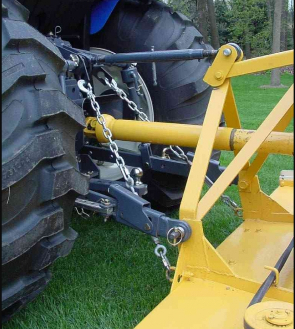

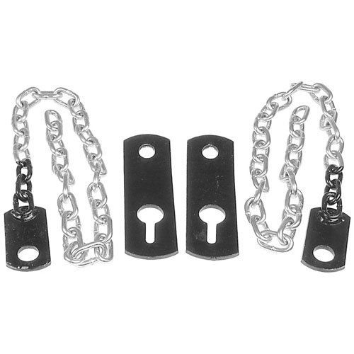

If your 3 point lower links won't stay where you set them, use a chain to set the mower height:

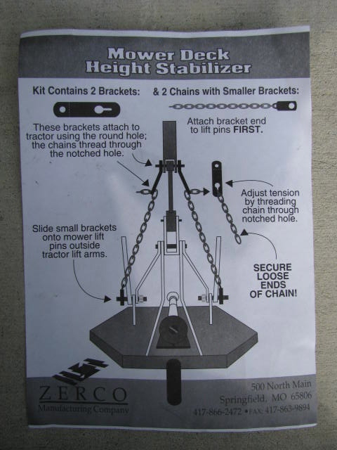

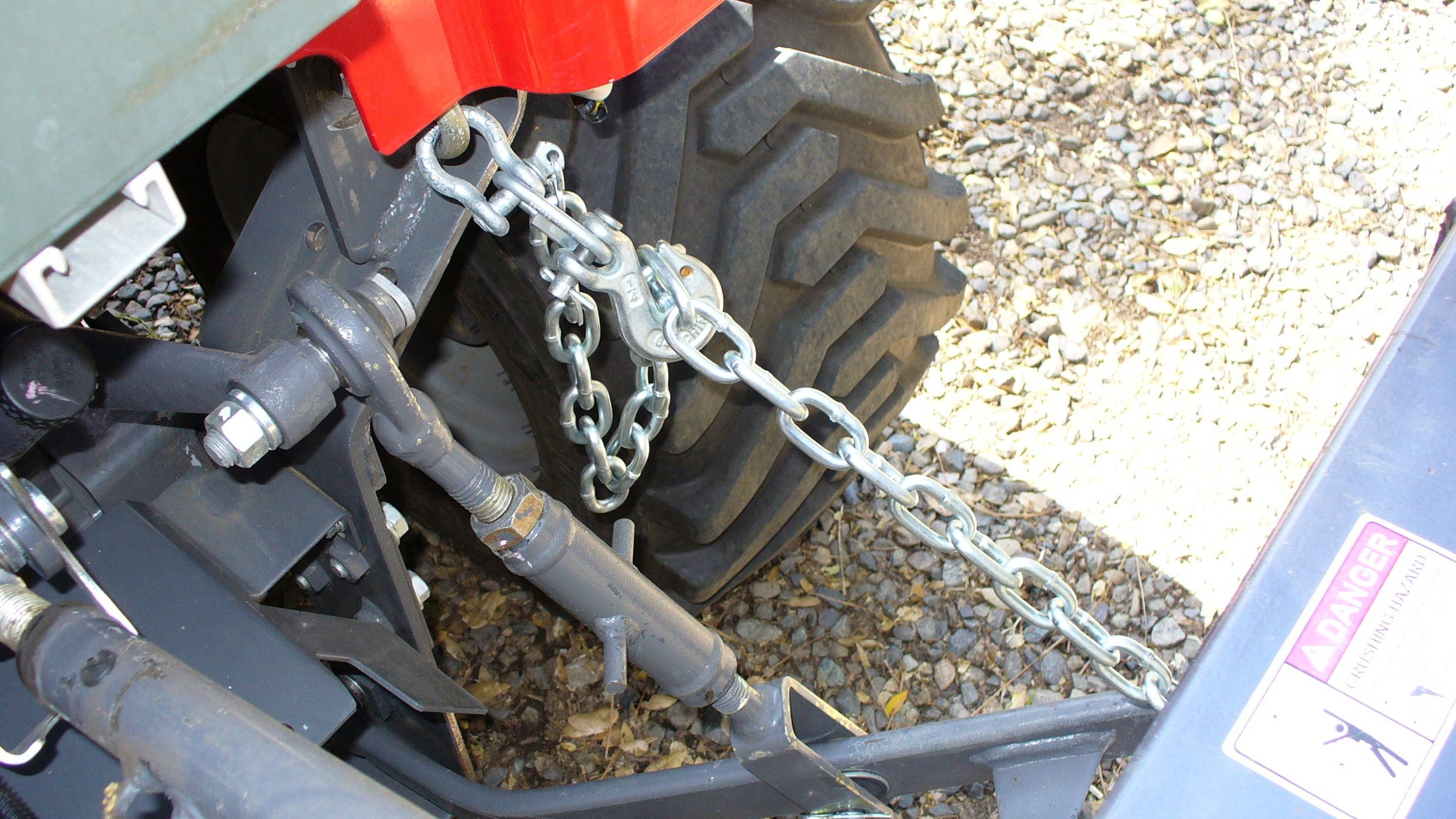

View attachment 745947View attachment 745948View attachment 745951
Chains come into use in many ways... One way for me is keeping rear ballast from creeping down when totally engaged in what I am doing with FEL (and not paying attention to ballast) ....
The funny thing is in your upper picture chains are installed completely wrong, chains are supposed to lock in keyhole bracket and hooks go to implement.... That way they are universal to whatever is on 3PH...
I actual made mine up from "parts" to stabilize my QH....
