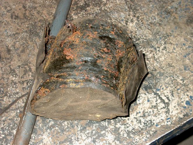

   / Foam in Tires
Here is a view of a core cut apart.

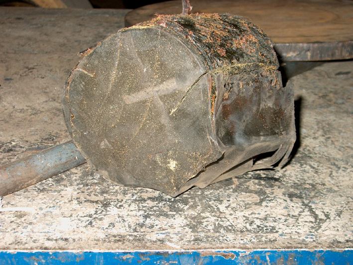

   / Foam in Tires
Here is a sideways view of the foam

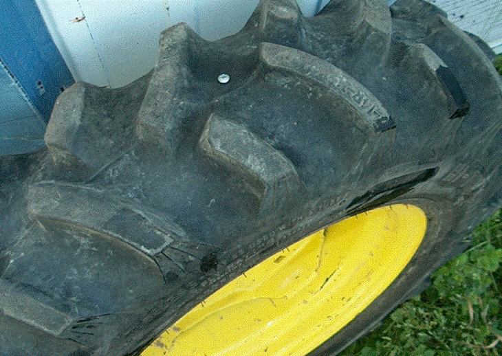

   / Foam in Tires
There is a small screw in each tire. I guess you can now say my tires are all screwed up /forums/images/graemlins/laugh.gif.
I believe this is where they injected the foam
