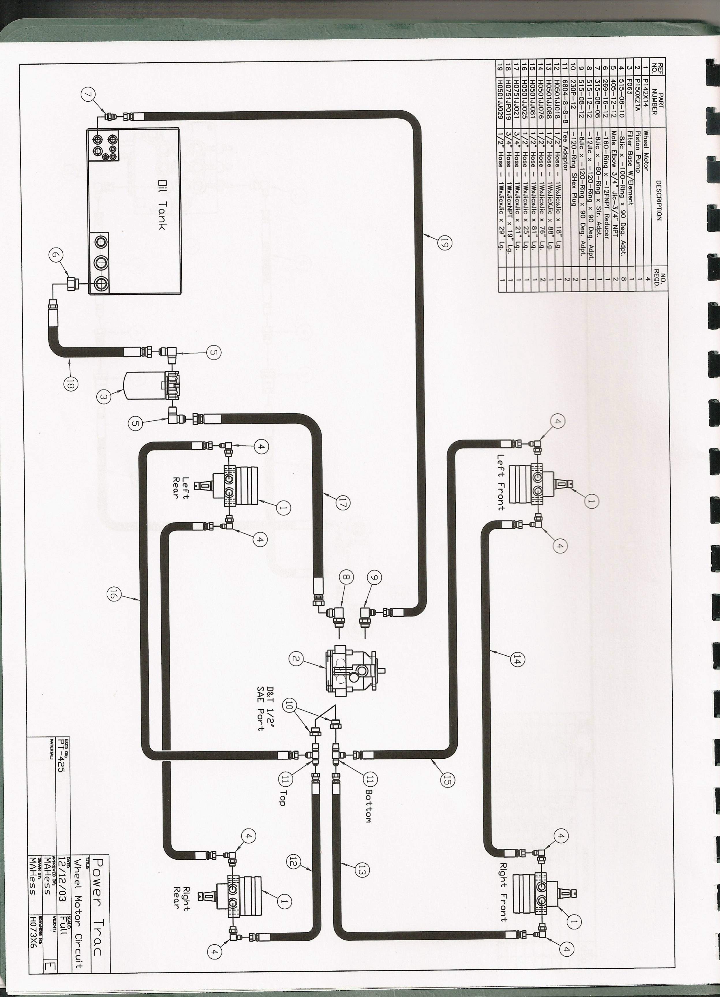

Now there is an occasional problem with the foot treadle. The machine suddenly stops moving for no specific reason. Everything works fine except the machine won't move backward or forwards. I shut the PT down and then restart, then I'm good to go with no further problem.
Here is the question. Can the valve that controls the forward/reverse movement be failing? And, what and how is the best way to identify if there is a problem?

Treadle is operated by the hydraulic circuit. I'm trying to figure out if there is a valve going bad or if the pump is failing.
I've attached the wheel motor circuit.
Hopefully you can make heads or tails from the circuit drawing.

There is nothing about the tram circuit on the schematic.
I agree. That looks like the tram pump, the wheel motors, the hydraulic tank and the filter. But there is nothing showing the treadle valve and hoses.
Anyhow, as someone else suggested, make sure the treadle pedal is actually operating the treadle valve first. That seems like the logical place to start.
