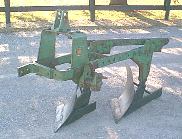

My thanks to all for the information about the Ford 101 model plow. But, back to my question = where on the plow do I find the stamped Serial Number???

If you are missing your aluminum serial # tag located on the left side of the plow A-Frame (standing behind the plow) you wont have one. Ken Sweet

Go to the first post in this thread, and look at the first picture. You can see the small aluminum tag that Ken is referring to.

That tag might have worn away enough the serial# doesn't show any more. And a lot of those plows get smacked with a sandblaster during their life on earth. But that little tag is where all the #'s SHOULD be.

Many thanks guys. I have no tag on the left side. Must have come off. Now I know where it should have been. I will make do. I have a good manual and parts manual which I should make out ok. If I need more help I will be back.
