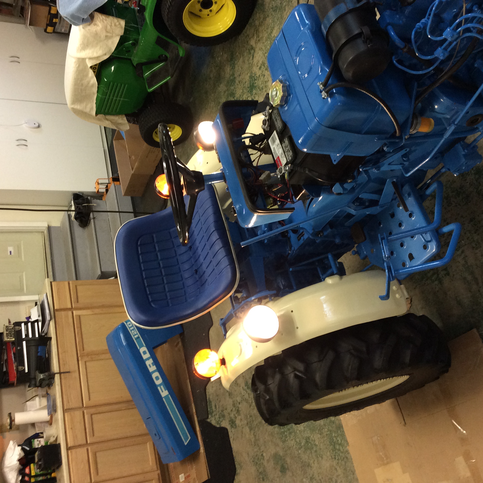

#111
Good news, bad news.
First the good news, got the fenders installed and all the wiring done.

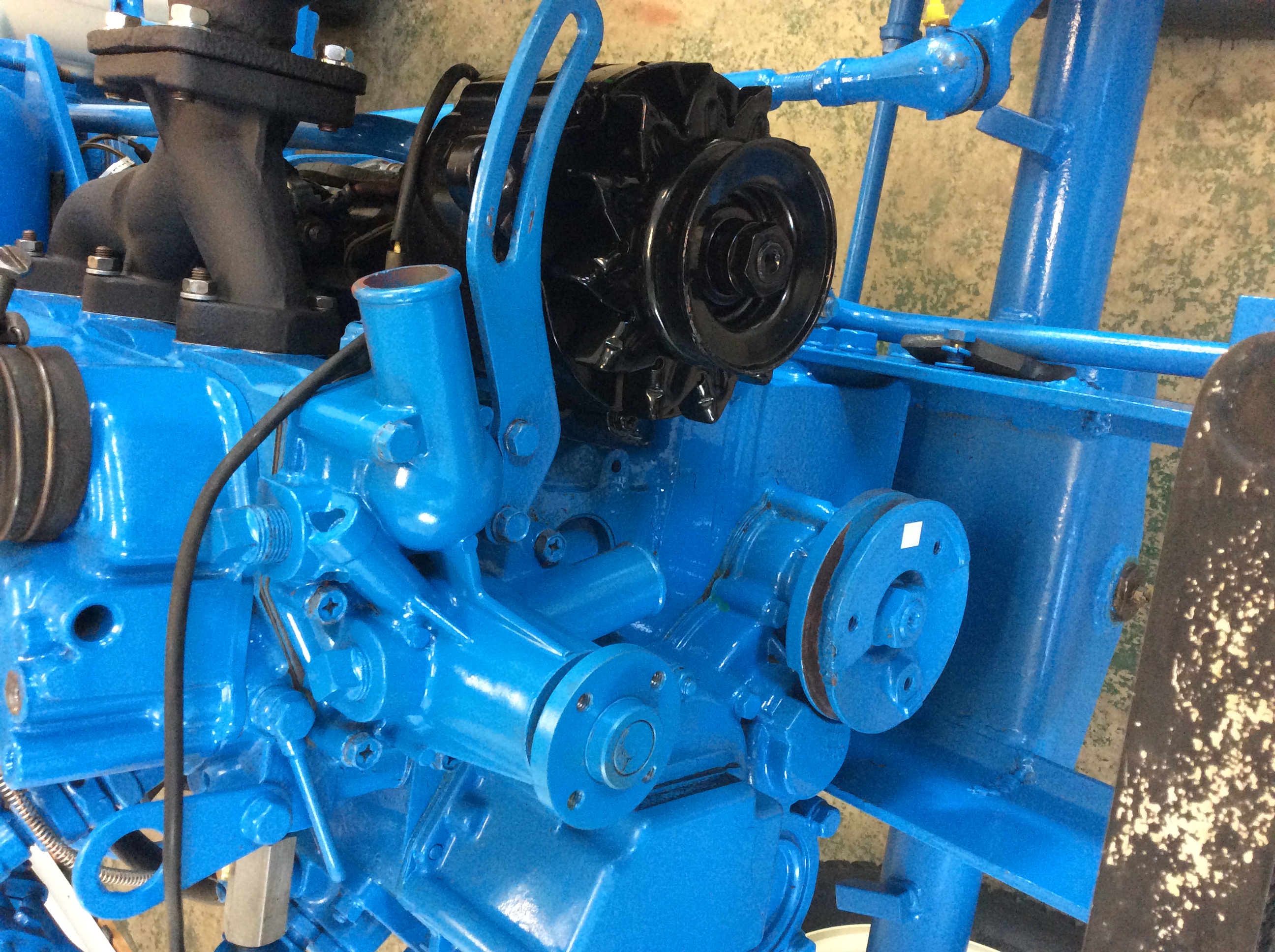

#112
Here is a shot of where the water pump is leaking from. There is a 1/8" hole on top of the pump that is not threaded or anything. The first sign of trouble was some kind of chunky substance squishing out that looked like dried silicone. Soon after there was coolant dripping out. It doesn't pour out, just kind of drips. I have a paper towel stuffed in the hole at the moment to prevent a mess. Anybody know what this hole is for? Can I just drill and tap it and install a pipe plug?
   / Ford 1210 tear down and repair #113
That's a weep hole to allow coolant to have a path out of the casting that doesn't spray it on the belts.
The seal is bad, plugging the hole will just cause the bearing to fail faster.
#120
Great news! The new pump is installed and working as advertised. Hope I don't jinx myself by saying that...lol.
It went pretty smooth and the test drive was fine. She started right up after some glow plug love. It is cold here today, maybe 35 or so.
Next I had my Father in-law help me mount the hood. She looks really nice now.
Still working in the garage, so will post some more progress latter.
