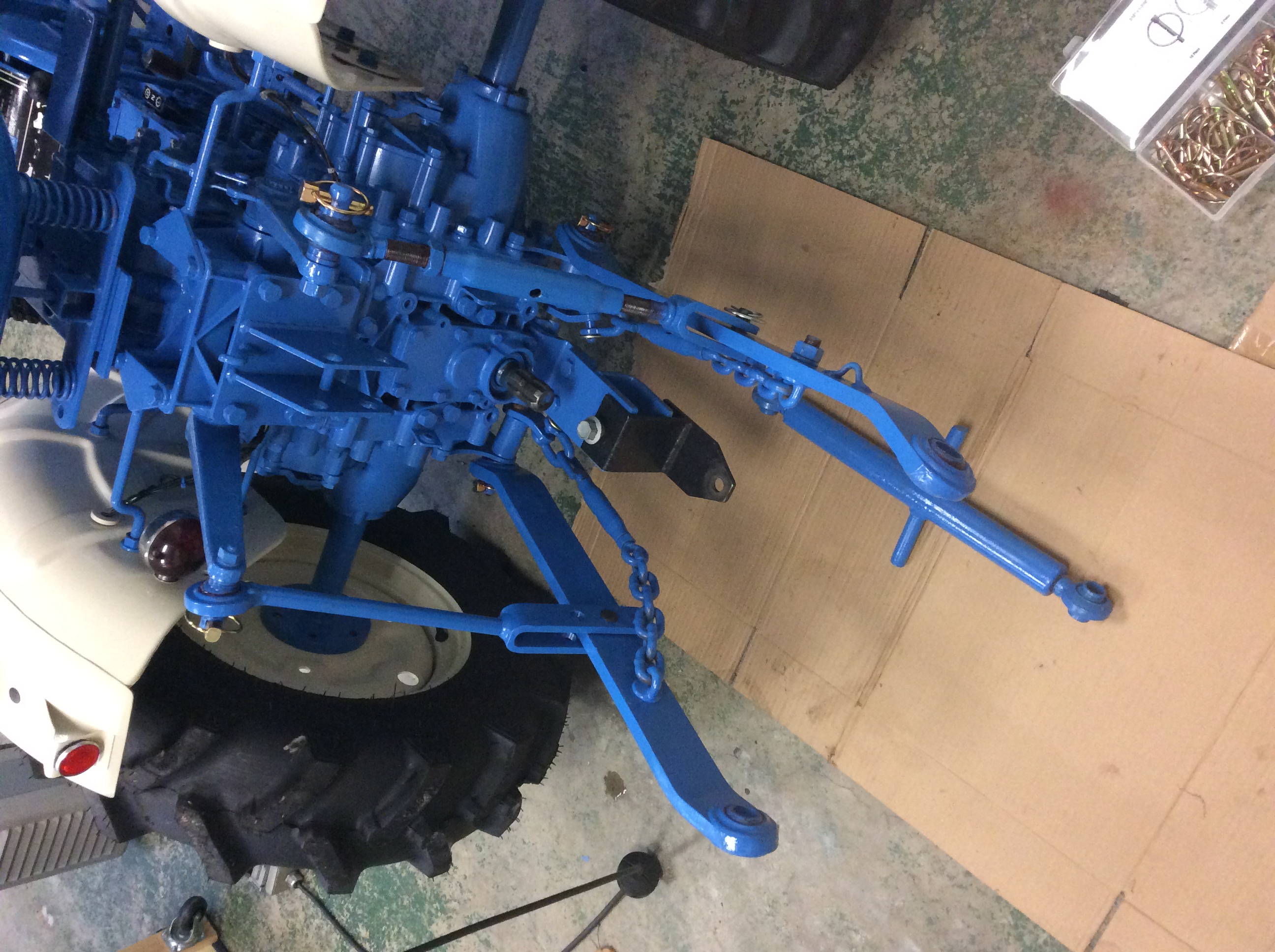

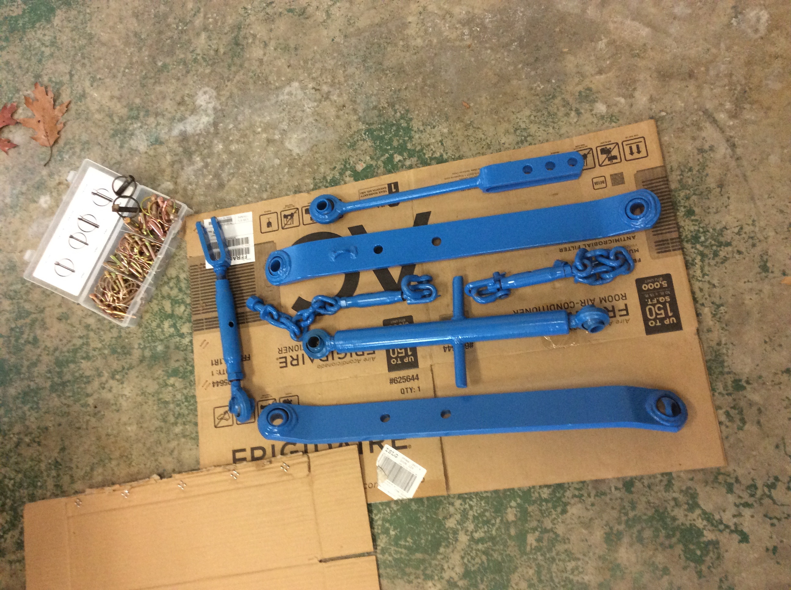

Got the three point installed. Never had a tractor with one of these, so will be learning as much as I can.

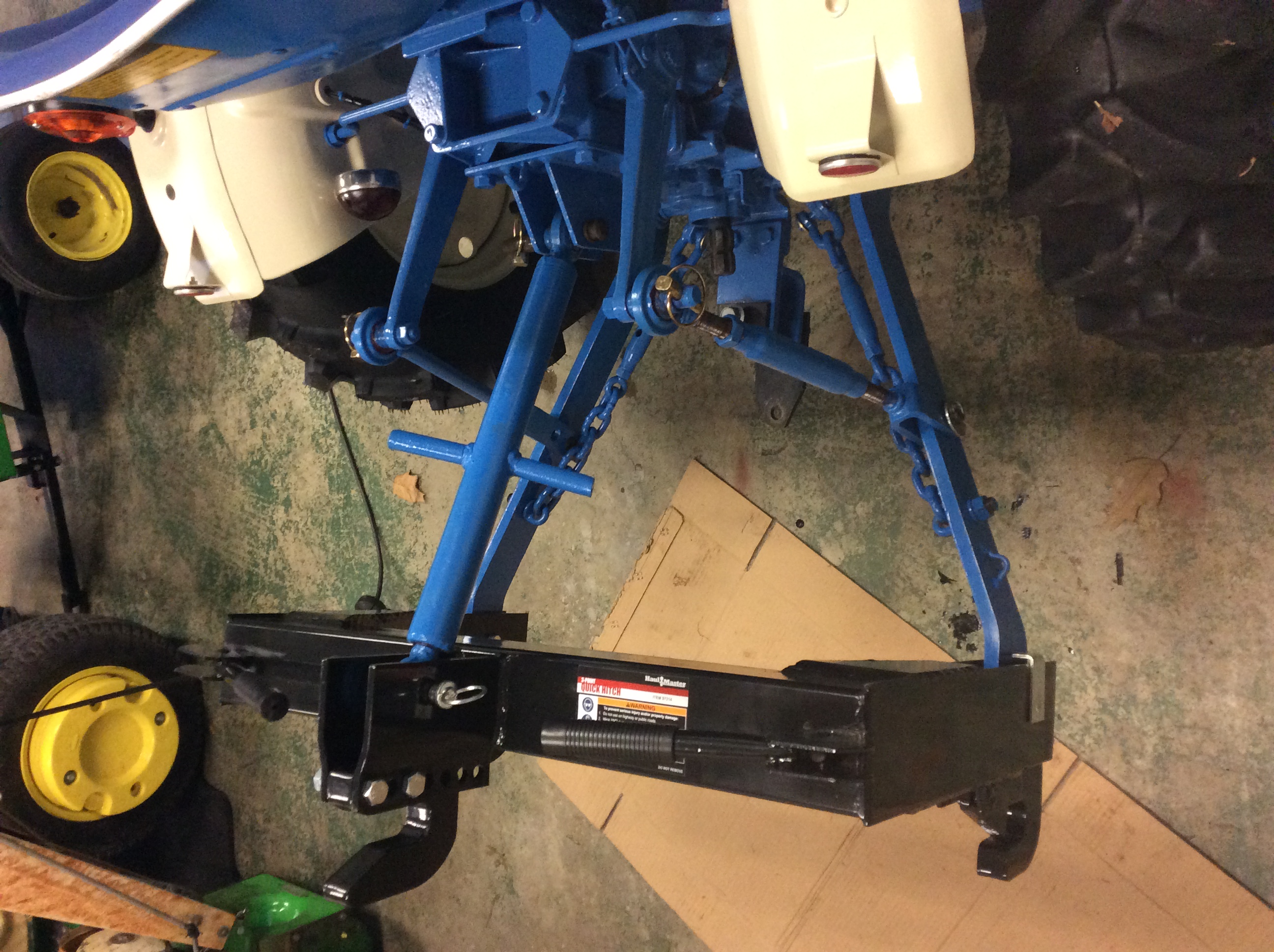

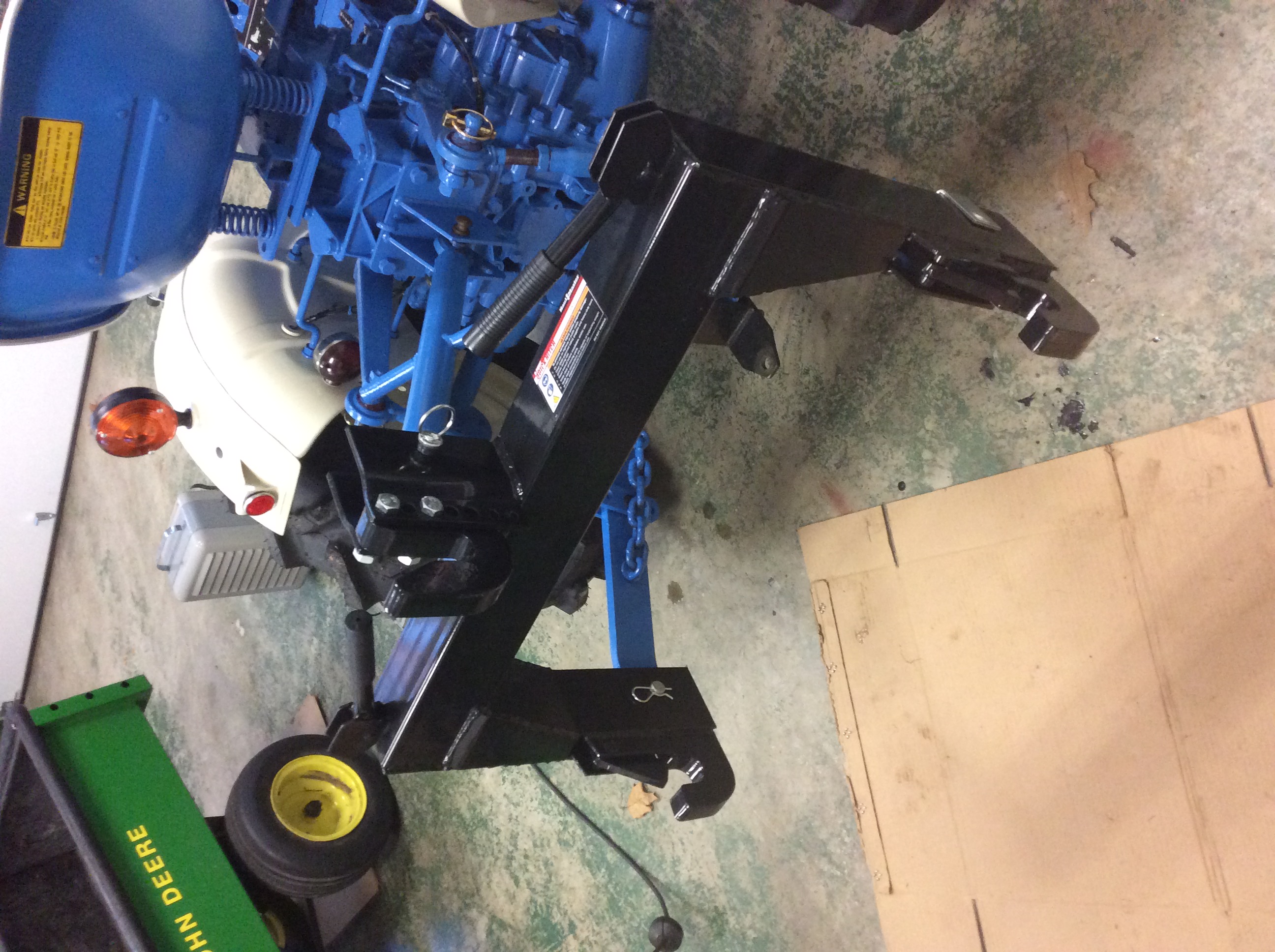

I also installed my first attachment, a quick hitch from harbor freight.
This is it for the day. Will pull her out tomorrow for some glamour shots before she starts getting dirty.
Sent an email to everything attachments to inquire about getting a few things. He said most of their attachments are quick hitch compatible, but he wasn't sure about the harbor freight hitch though. He said having a quick hitch on a small tractor like this isn't a good thing because it sets the attachment further back which can upset the balance.
More tomorrow.

Looking great, my Ford 1700 needed glow plugs to start when it dropped below 45 degrees or so, the Ford 1920 does not need them till much colder. Which attachments are you thinking of getting. You should not have a problem unless they approach 1000 lbs or so then the front end will get light.

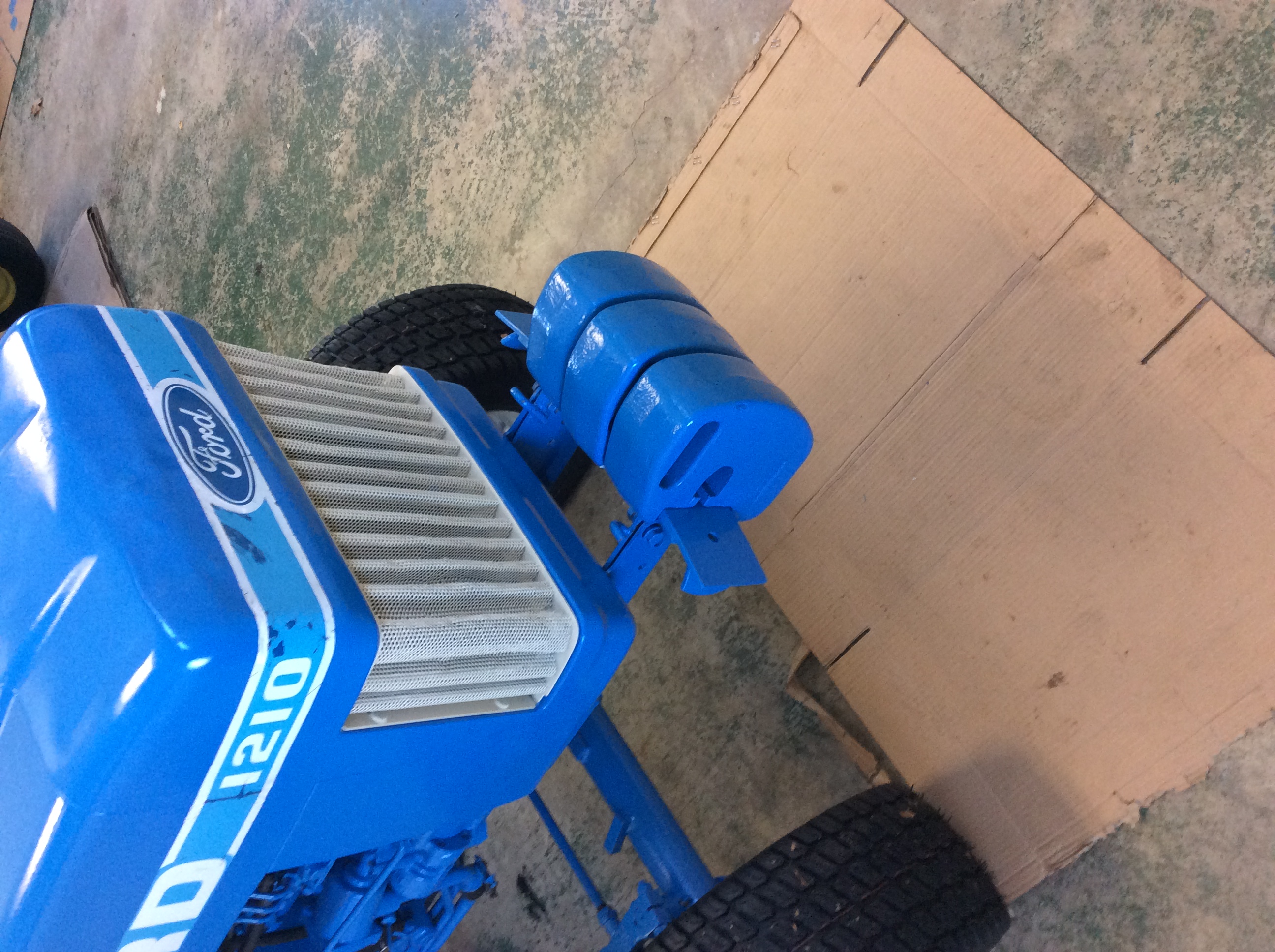

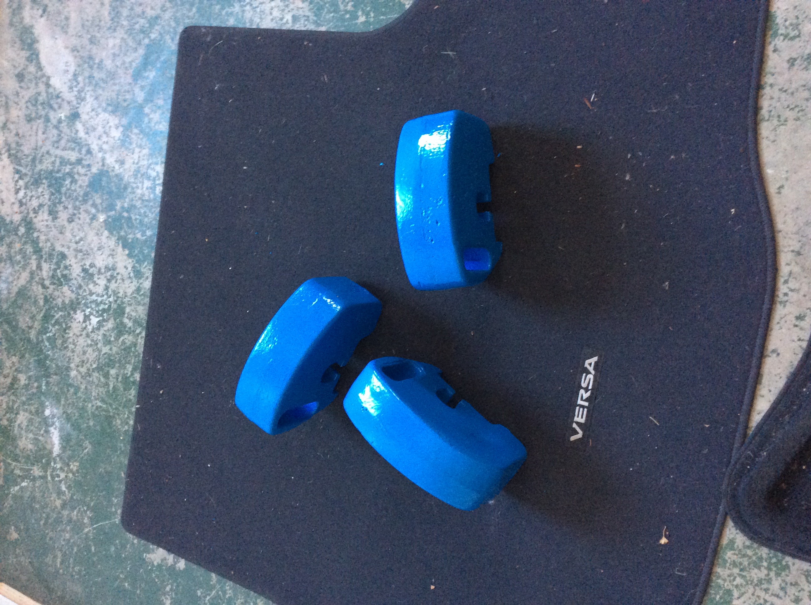

Got the suitcase weights installed. Only used three, but have five. Book says three is the max.
Also changed the engine oil and filter today as well as topped off the coolant.
   / Ford 1210 tear down and repair #126
I have those same weights on mine. Three has been all that I have needed and as you noted that is the max per the owners manual.
