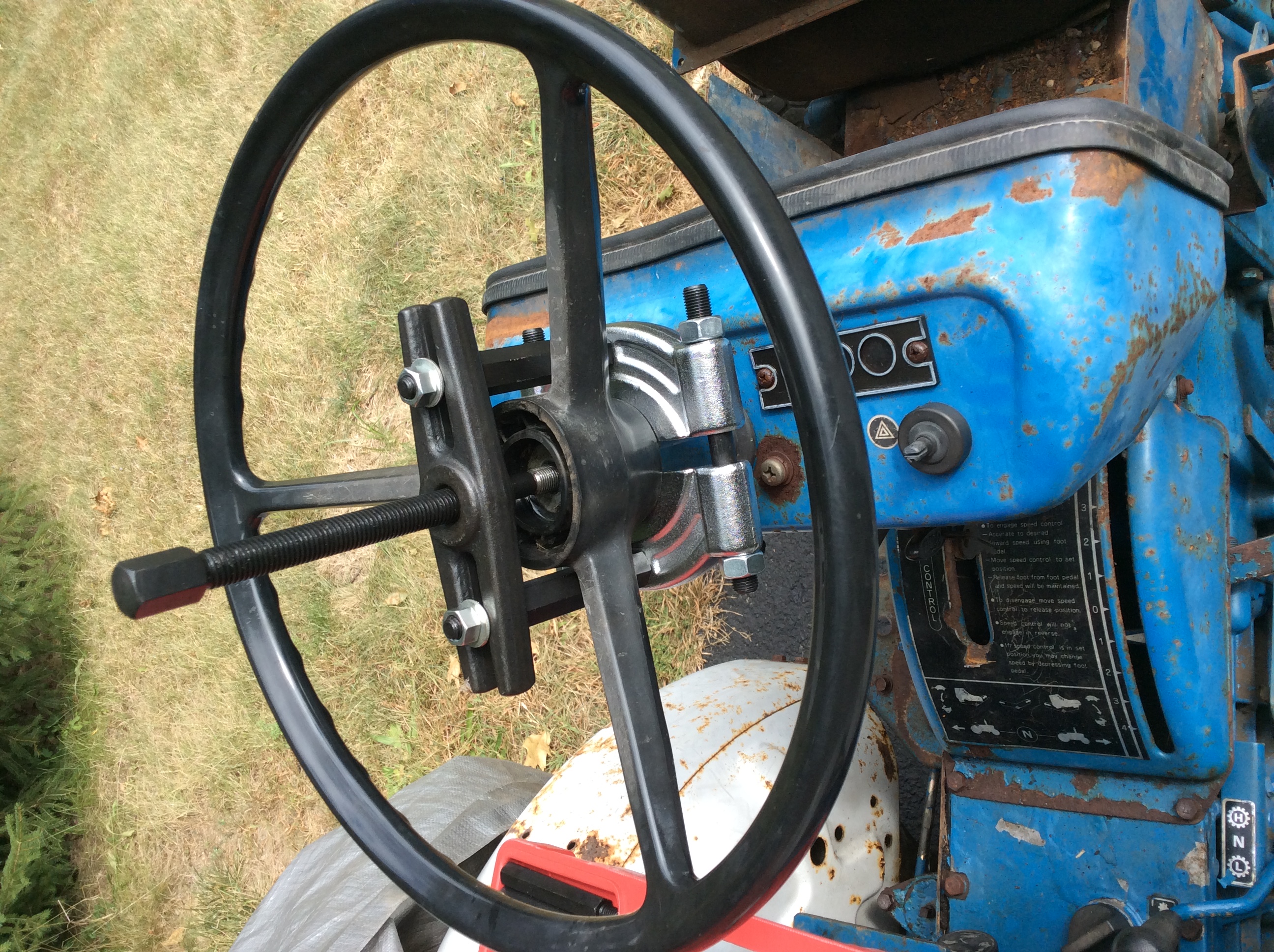

Had a devil of a time pulling the steering wheel. Finally got it off though with a bearing puller.

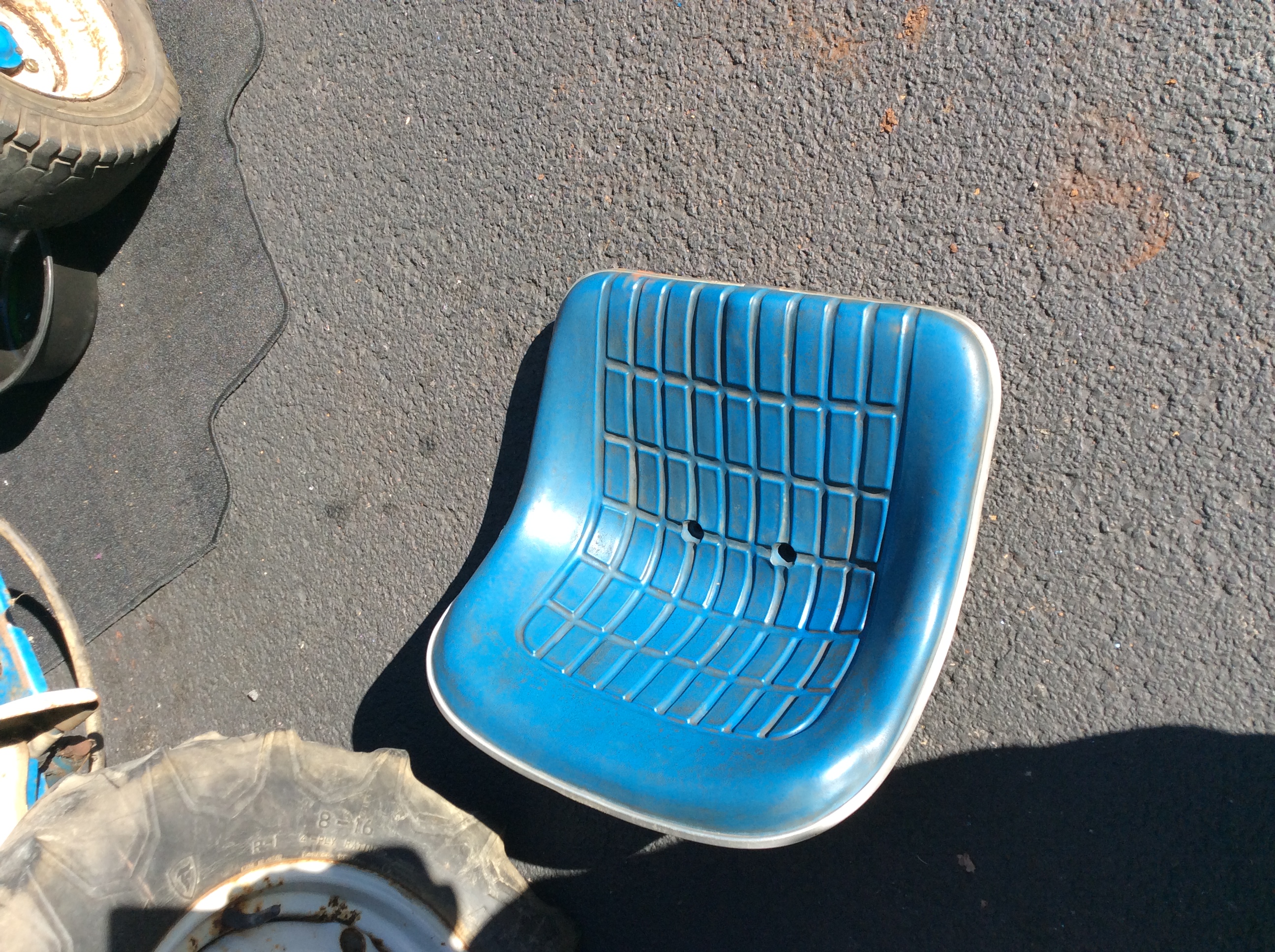

Got the seat pulled off. The holes are elongated on the flip bracket. I will weld some washers on the end to tighten things up.
View attachment 479994View attachment 479993

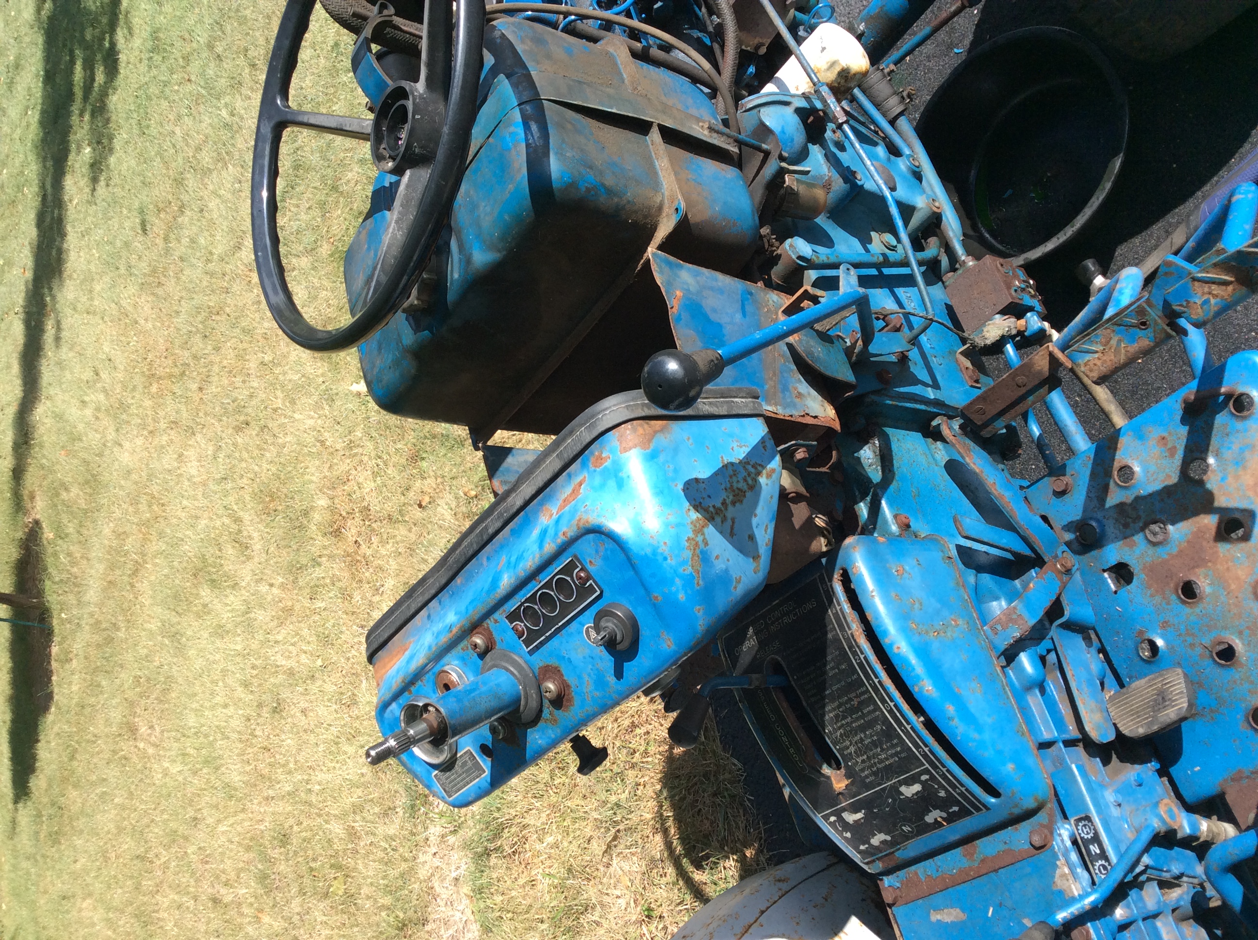

Adjusted the clutch free play at the pedal. I now have one inch of free play instead of the two I had before. Had to adjust the safety switch too. There is also a max travel stop screw, but I don't know how to adjust that. Didn't see anything in the service manual.
Here is how she sits tonight. Tomorrow I hope to get the fuel tank, and radiator pulled. I have a new radiator and fuel cap on the way. Need to pick up some new fuel line to replace all the dry rotted stuff.

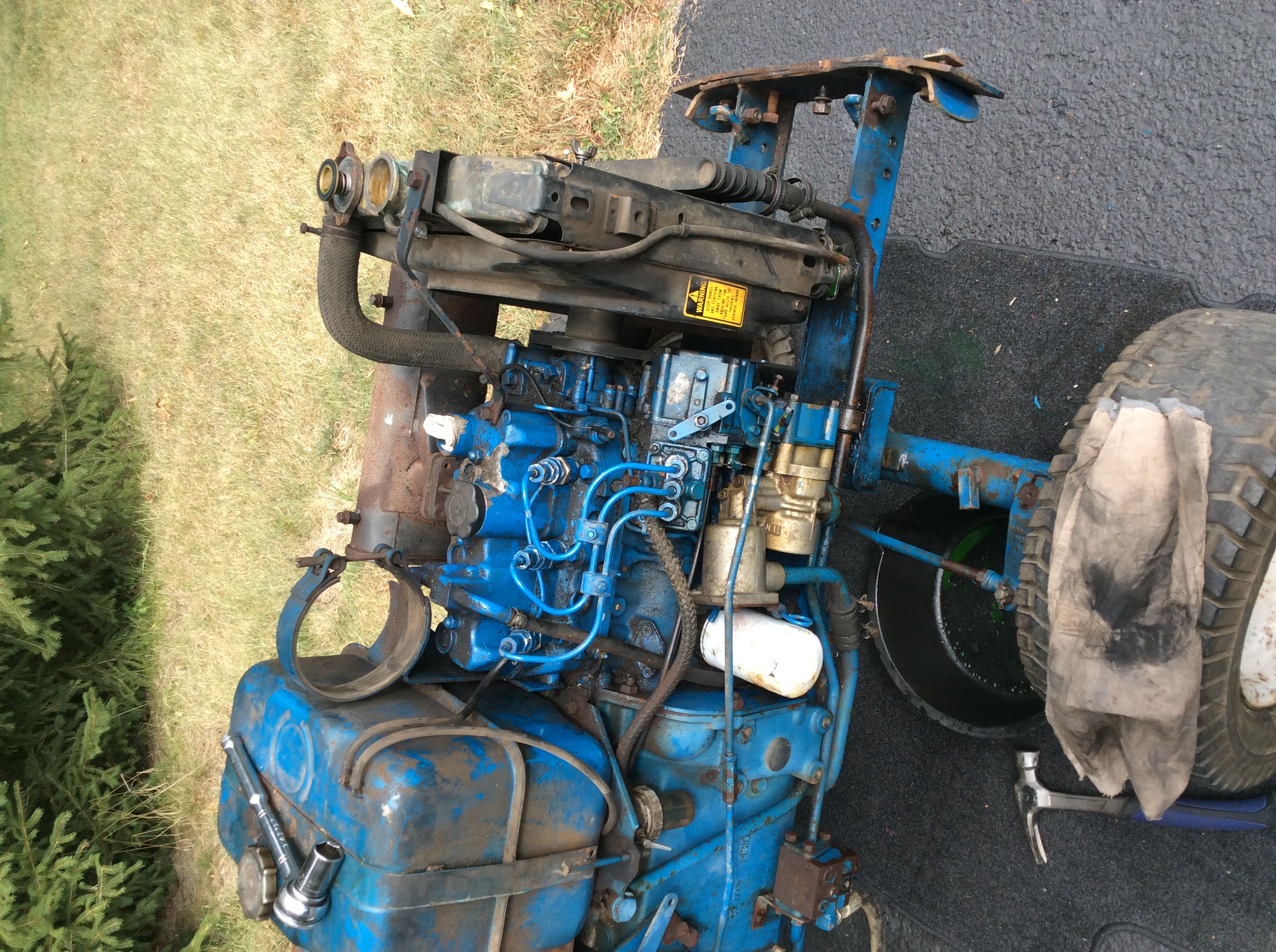

Moving along on the 1210.
Go the radiator off today. It is more than half plugged with gunk. Might find a local shop to hot tank it.
The muffler came off after some persuasion with penetrating oil and punch and chisel. Looking for some input on good high temp paint. Anyone use anything that actually works? Want to paint the manifold and muffler.
